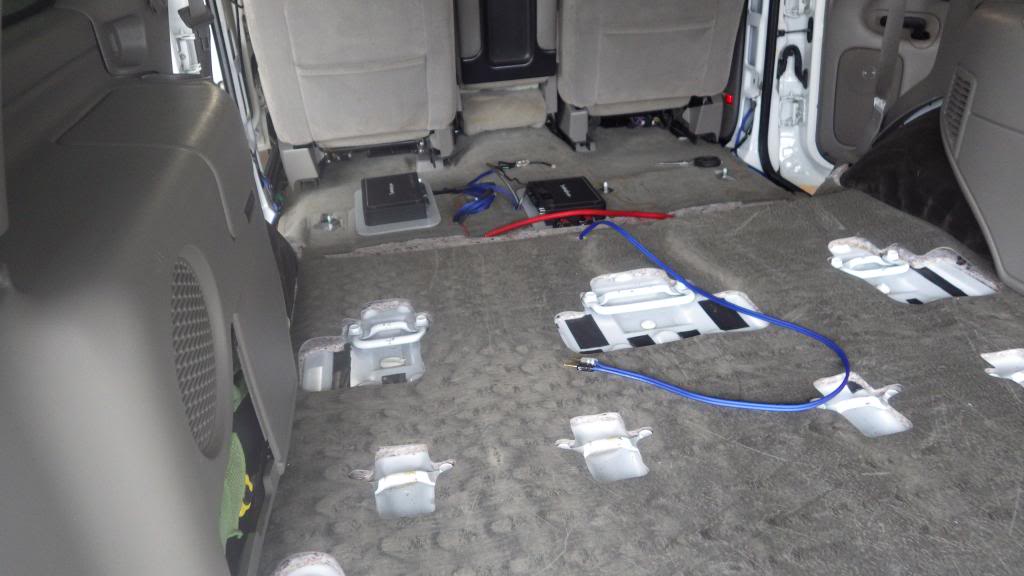

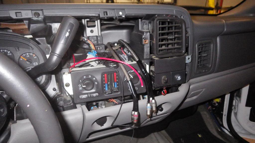

Working out the wire runs:
RCAs, microphone, amp power wire to the dash:
12 gauge speaker wire to all the speakers:

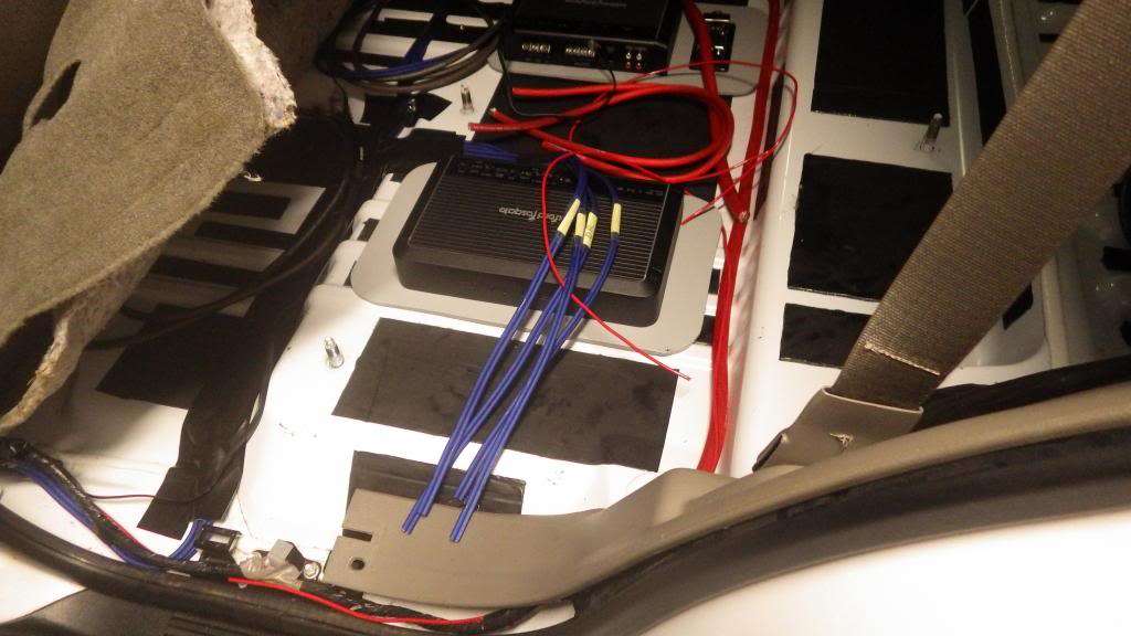

Working out the wiring runs - poking through MLV.
Rear MLV down with sub wire poked through:

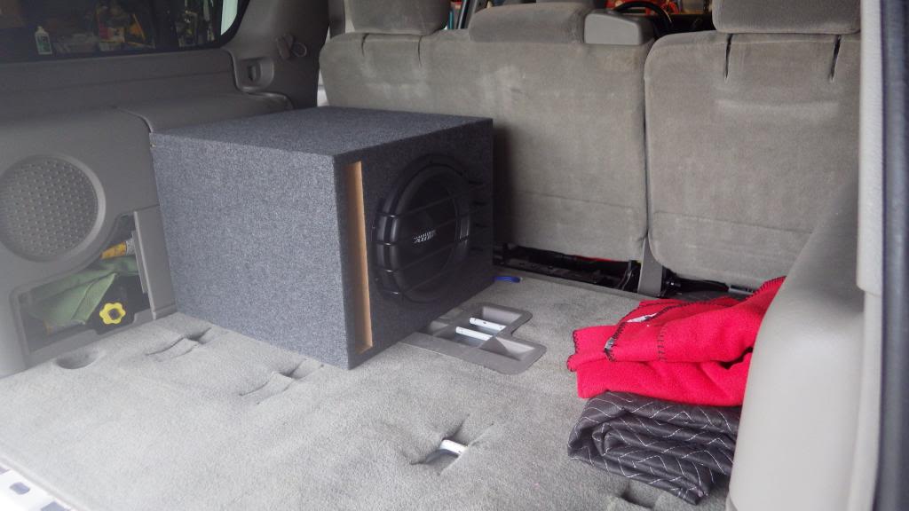

Sub in and ready to rock! (No power or head unit yet)
Getting close for a final mount and wiring.

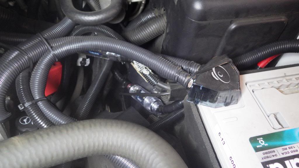

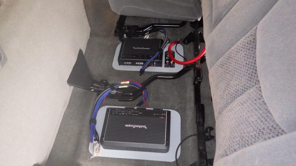

A little more and that’s it for the weekend:
Hooked up my main amplifier power fuse and small whip to the battery:

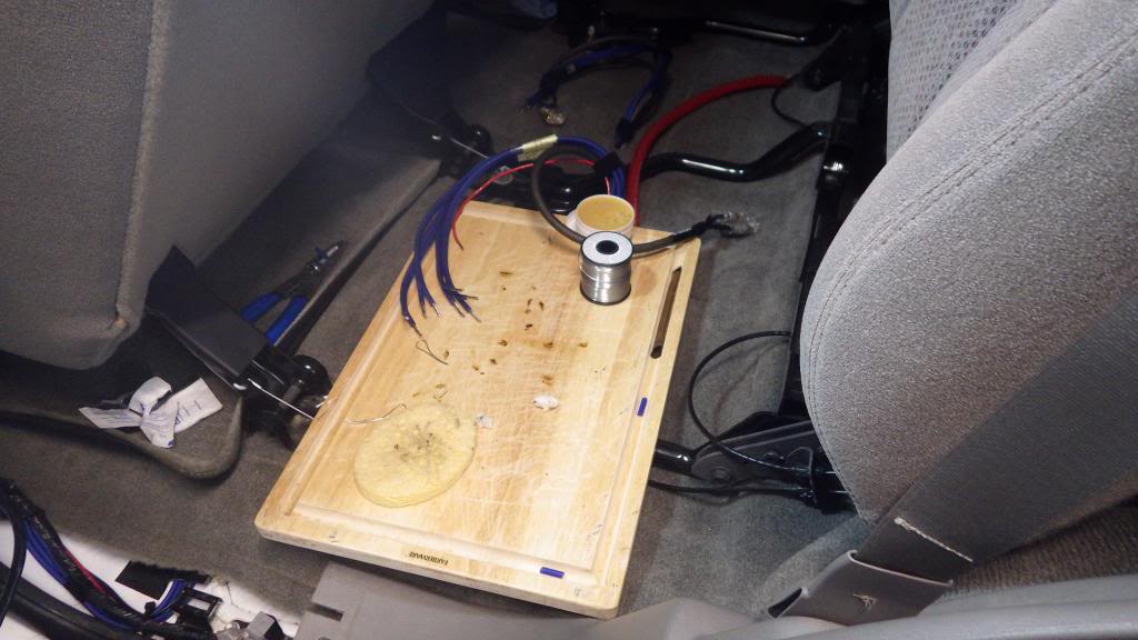

Terminated cable to splitter:
Tinned wire ends:

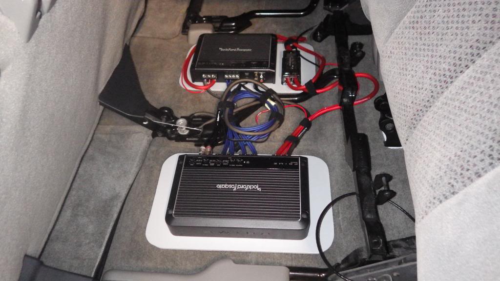

Mounted my amps and power splitter to the wood boards:

Amp install is looking sweet!:beer:
Now I know why mine looks so crazy...wires run to both sides of the amp.
images
Not my truck but you get the idea.
I like the look of all the wires on one side. It appears to be a cleaner install.
