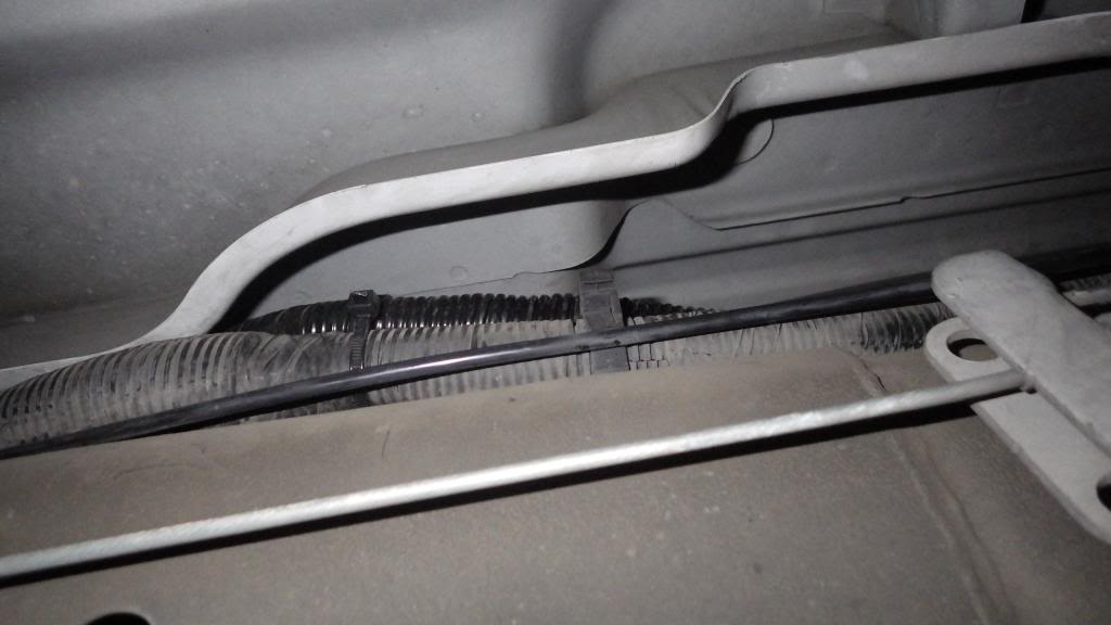

Started doing some exploring as to how I will make my power run for my audio project and ended up getting my back seats and carpet out.
I found that my drivers’ side channel already has cables run in it so I’ll need to run beside and under carpet:

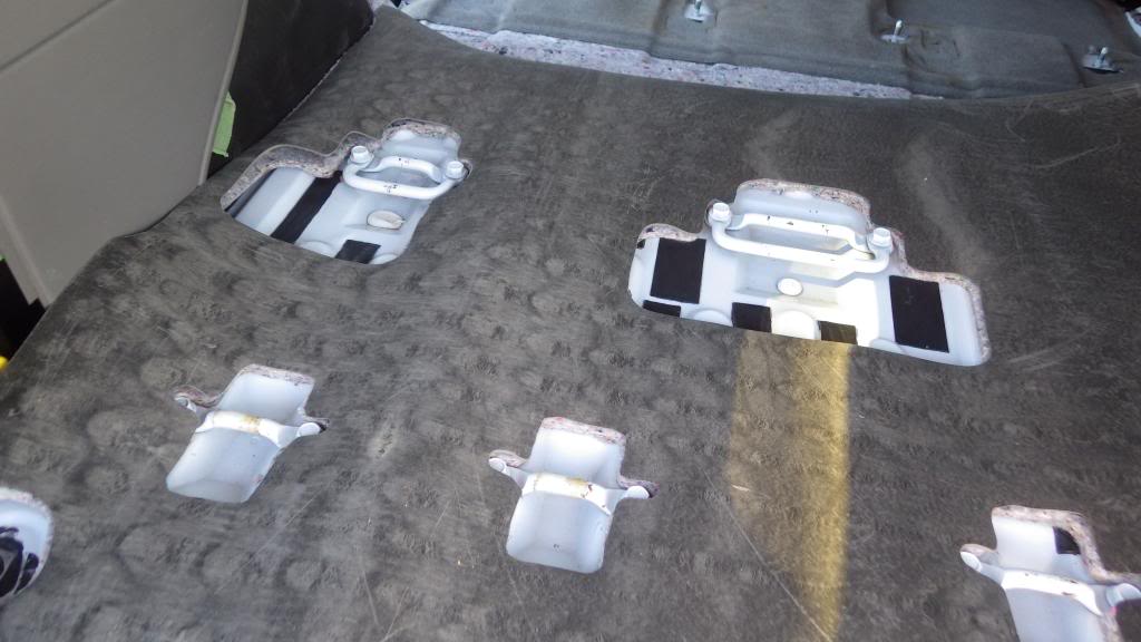

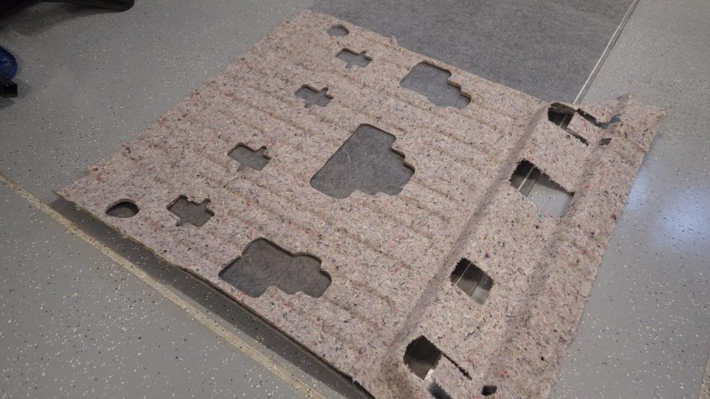

Got the back seats out:
Then all of the carpet and sound mat in the back:
Getting time to do a bit of sound deadening and run some wires!!

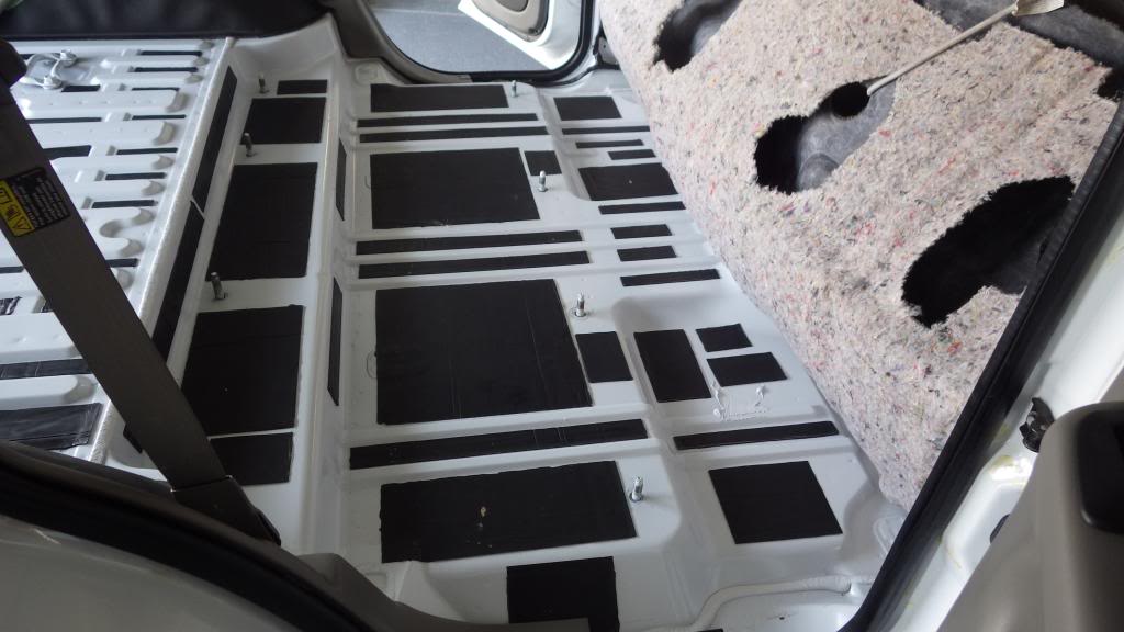

Making more headway
More Progress:
Used the rest of my package of Damplifier Pro:
My MLV is supposed to show up Monday.
Getting ready to run some wires!!

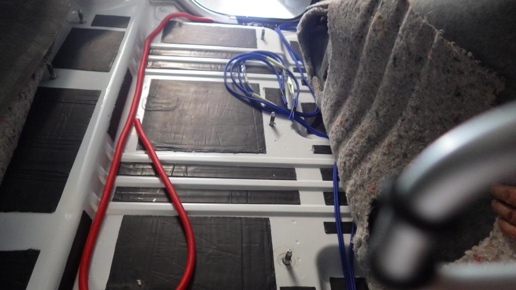

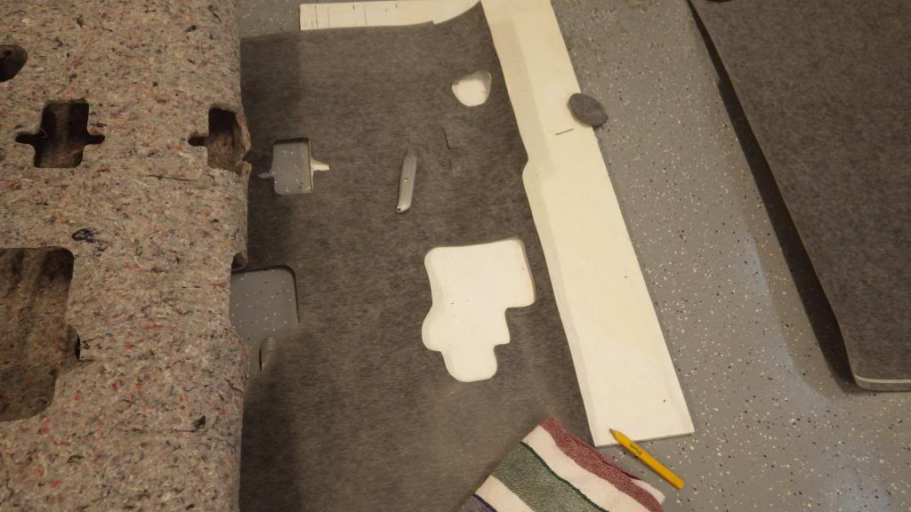

More progress -- got some MLV in:

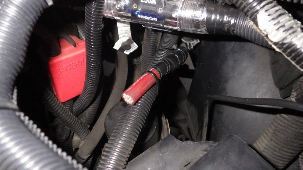

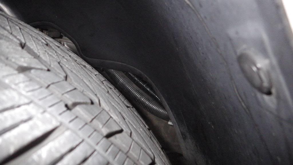

Got my positive wire run to power my amps, ran under the driver side along an existing wire run and into the cabin with grommet:

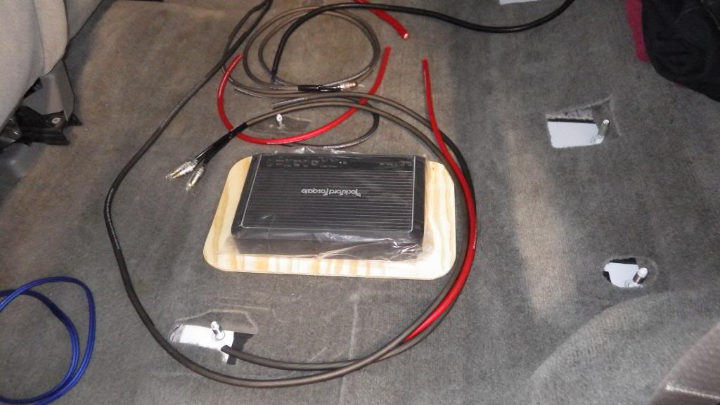

Got speaker wire roughed in, RCAs,
Cut some wire to rough length, mock up for amps:

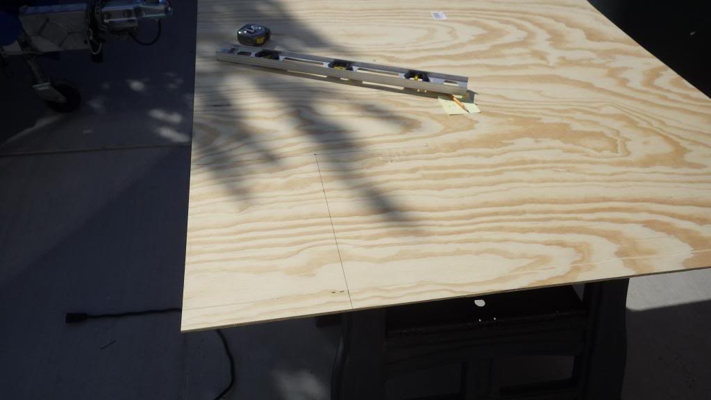

Cut my plywood amp base:
GETTING THERE!! :party36:
