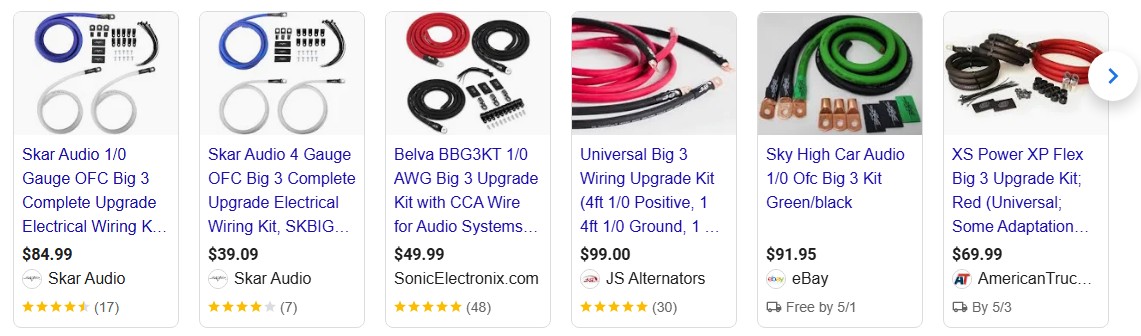

Im new to this forum, and im yes i been doing alot of research on the big 3 upgrade for my 2013 tahoe. I recently purchased a 250 AMP alternator (Only have 1 battery, and will be installing a amp soon), and my question is, does anyone in this forum, or know of a website that sells the cables as a kit pre-made? i work alot of shift work and dont really have the time to take off, measure, cut, and crimp cables at this time. Thanks in advance!

A simple Google search shows many Big 3 kits are available that will work for your Tahoe. Unfortunately, they are not necessarily cut to the 'exact' length that will perfectly fit your Tahoe.
Skar Audio makes a Big 3 kit that has one one of each wire crimped and shrink wrapped, and the parts needed to crimp and shrink wrap the other ends of the wires, once you have cut them to the proper length. Kind of a 'halfway done for you kit'.
