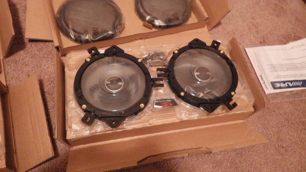

I bought a 04 Tahoe last month and it has a blown driver’s side front door speaker. Knowing I also want to upgrade the head unit to one with USB & Bluetooth (and also looking at XM or HD radio) I started reading the audio system threads and getting reflective on how much money I want to put in to my new system - I’ve concluded about $1,000, but there will be more to it than that because of Big 3 upgrade with new dual post battery.
Since I have a blown front speaker with a stock sound system (it’s the OnStar without Bose), I decided to start at the speakers so I could at least hear sound from the front. I’m blown away at the prices of the components (Big $$$) and yet still wanting a pretty cranking system, I decided to go with these speakers that will handle 100 watts RMS each, a 4 channel amplifier that puts out 100 watts RMS X 4 and a powered sub:
Already purchased:
Front Door Speakers: Alpine SPR 60C
Rear Door Speakers: Alpine SPR 60

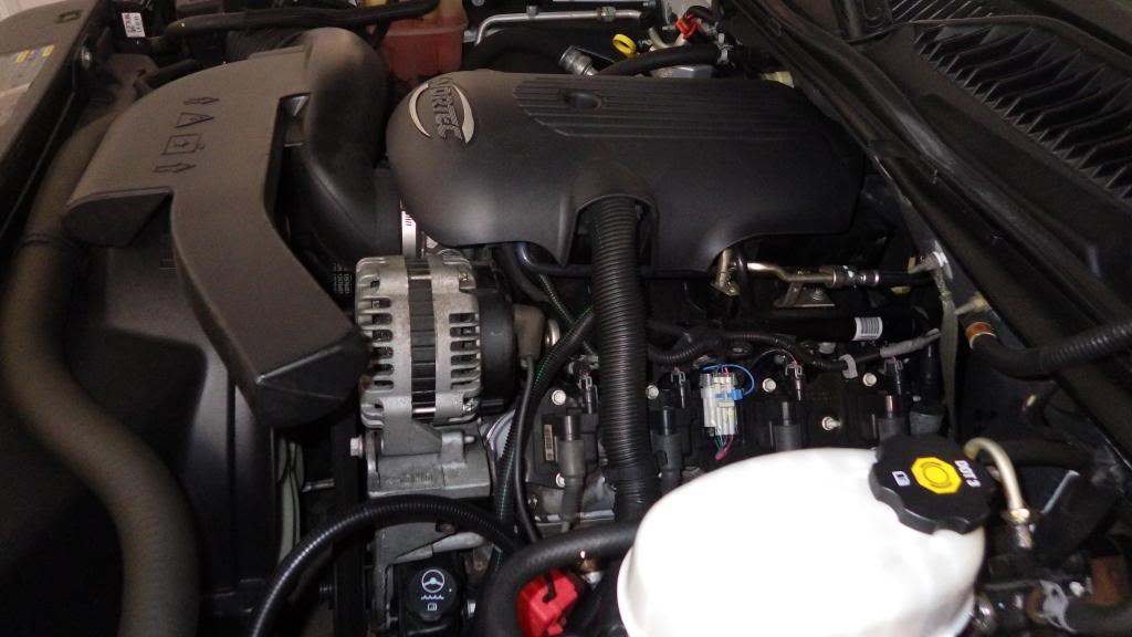

Nice engine bay! all clean and gunk free. GJ! :worthy:
Hey, Thanks!! Here's a couple more shots:

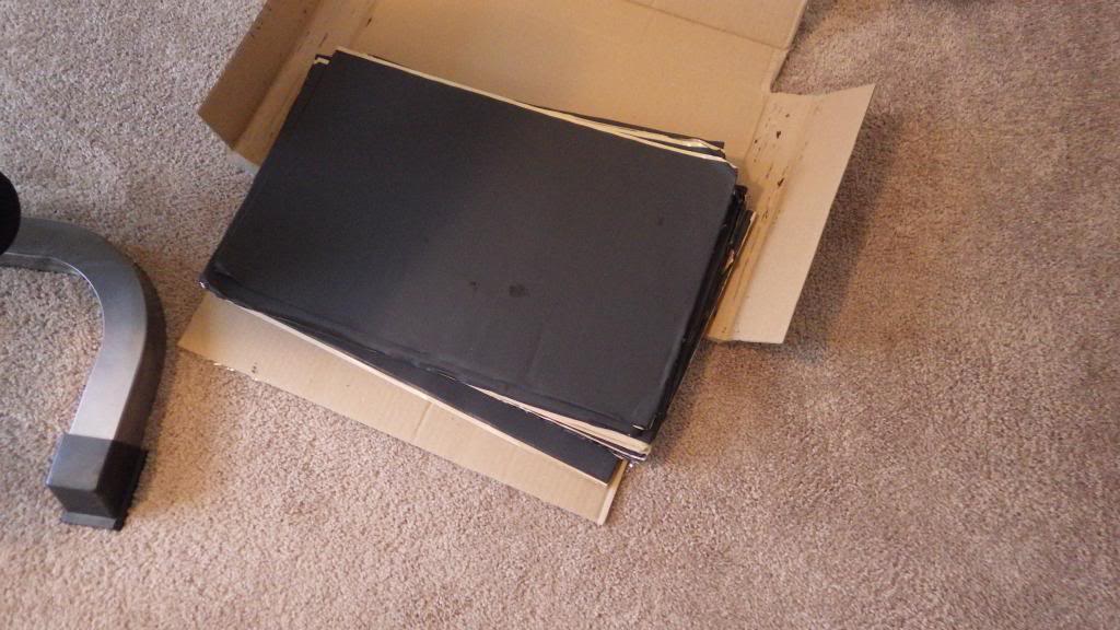

I received my Damplifier Pro from Second Skin Audio yesterday (http://store.secondskinaudio.com/damplifier-pro/) , so I'm armed and dangerous for my speaker install next Friday. I'm looking forward to getting them in. More to follow next Friday!!
I bought the "B" pack for a little less cash, I'll show how it turns out.
A few that are REALLY wrinkled:

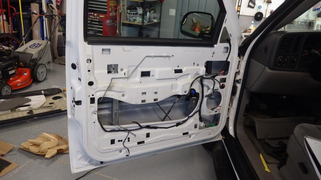

Making progress - Door Deaden and Speaker Install
I'm making some good progress on getting my doors deadened with Damplifier Pro and getting my speakers in.

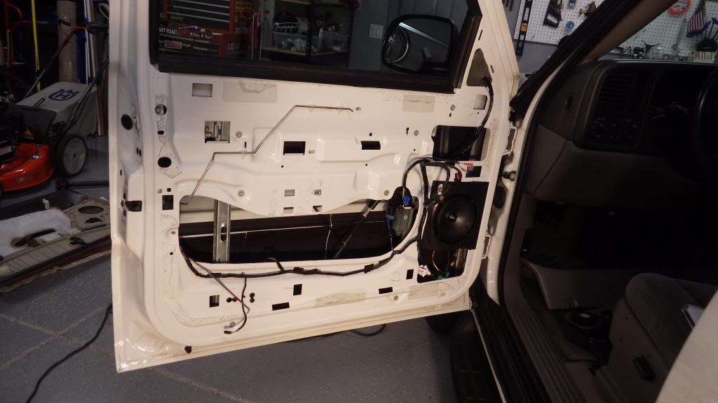

After some wrestling, I got my passenger front door off and deadened:

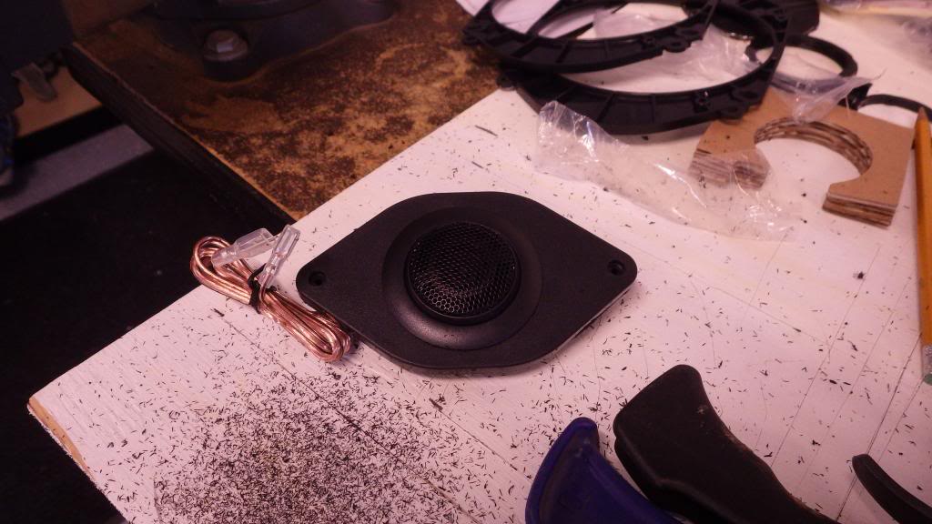

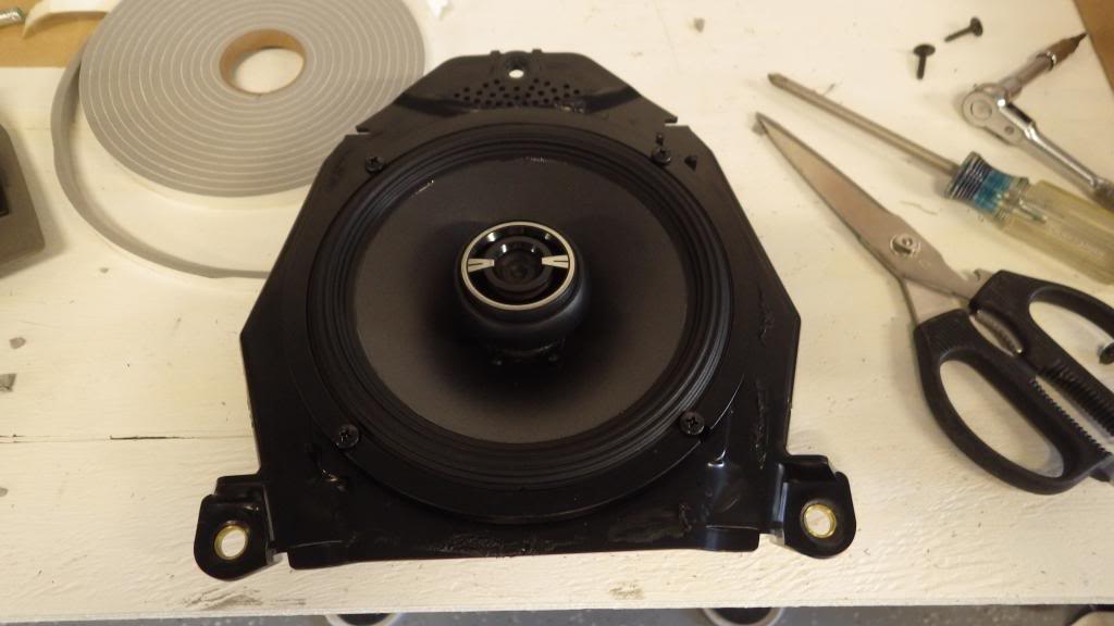

Got my tweeter in after using my Roto Zip to make a bracket from the old tweeter:

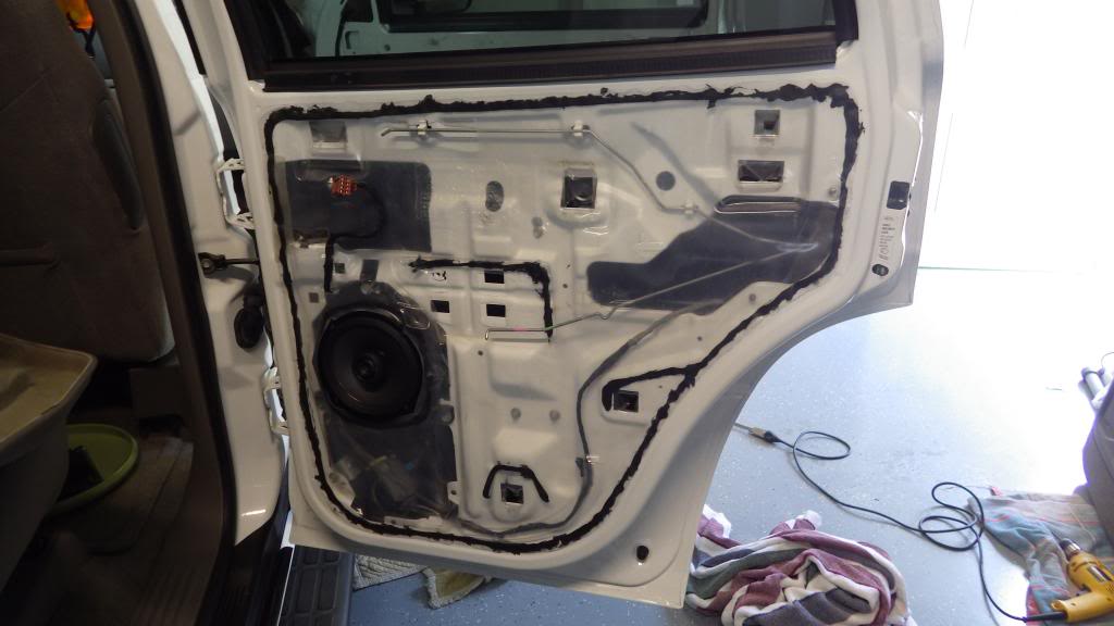

Back doors deadened:

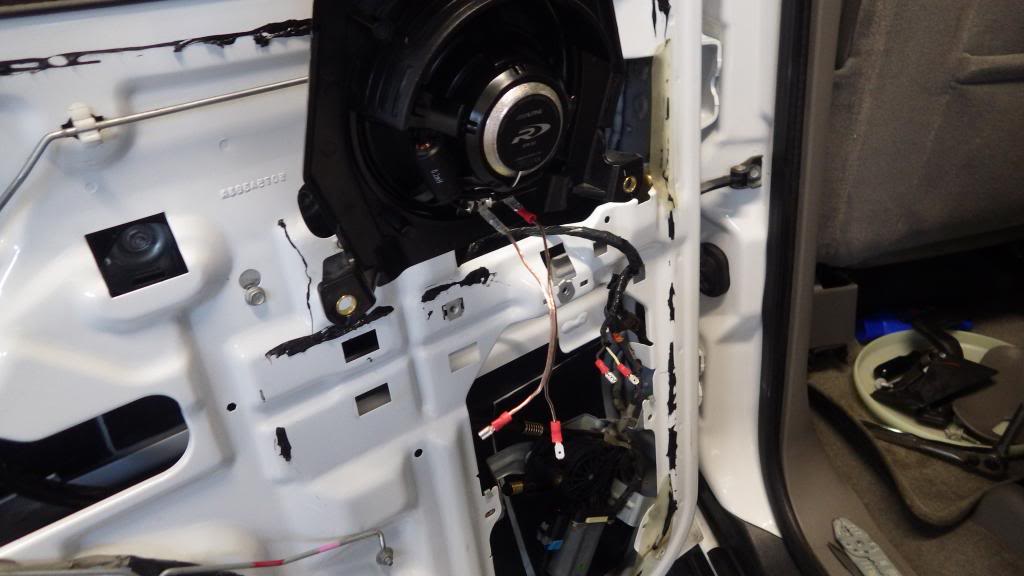

Picking up where I left off from Friday, I loaded up and installed my rear door speakers:
Made pigtails:
Installed rear door speakers:
Front Passenger door:

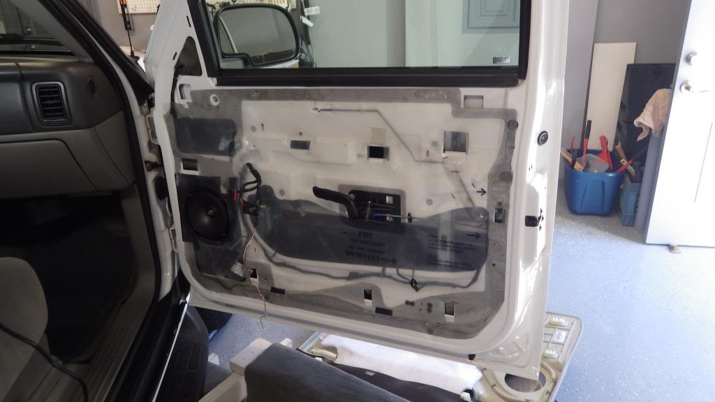

Got driver door apart:
Sound Deaden:
Install Speaker:
DONE:

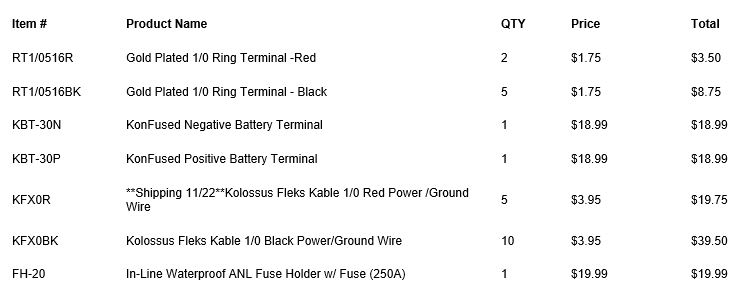

I'm jazzed I could finally order my Big 3 upgrade cables today. Knu had been out of stock on the cables for a bit, but now, I've got my order in!
Time to gather the rest of the supplies to do my Big 3 upgrade. Likely after Thanksgiving at this point - need to get my Christmas lights (or holiday lights for you PC types) up on the house this weekend.
