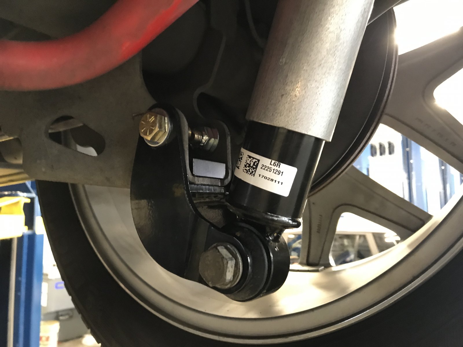

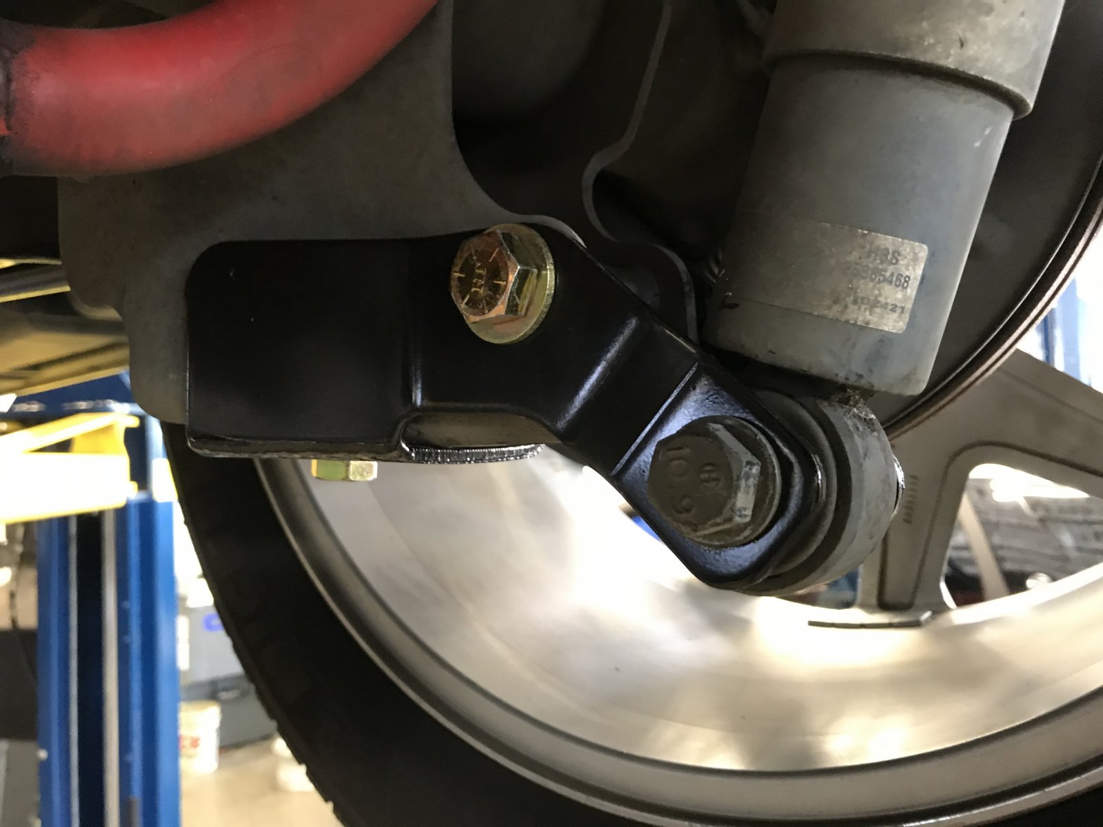

Got the new shocks and extenders in and they work PERFECT. With the shocks aired up, the hub to guard measurement increased to 19.75" but the shock length bolt-to-bolt increased to 19.5." Since the stock Yukon measured at 19" bolt-to-bolt with deflated bags these are exactly what it needed.

I took these of “before” with the Belltech extenders and “after” with the McGaughys extenders.

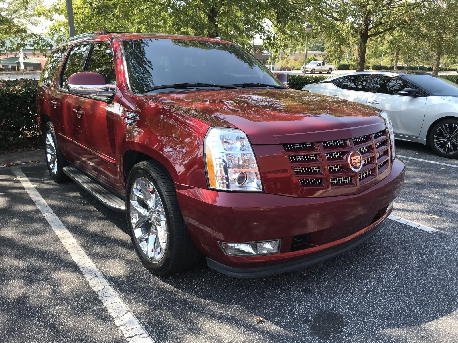

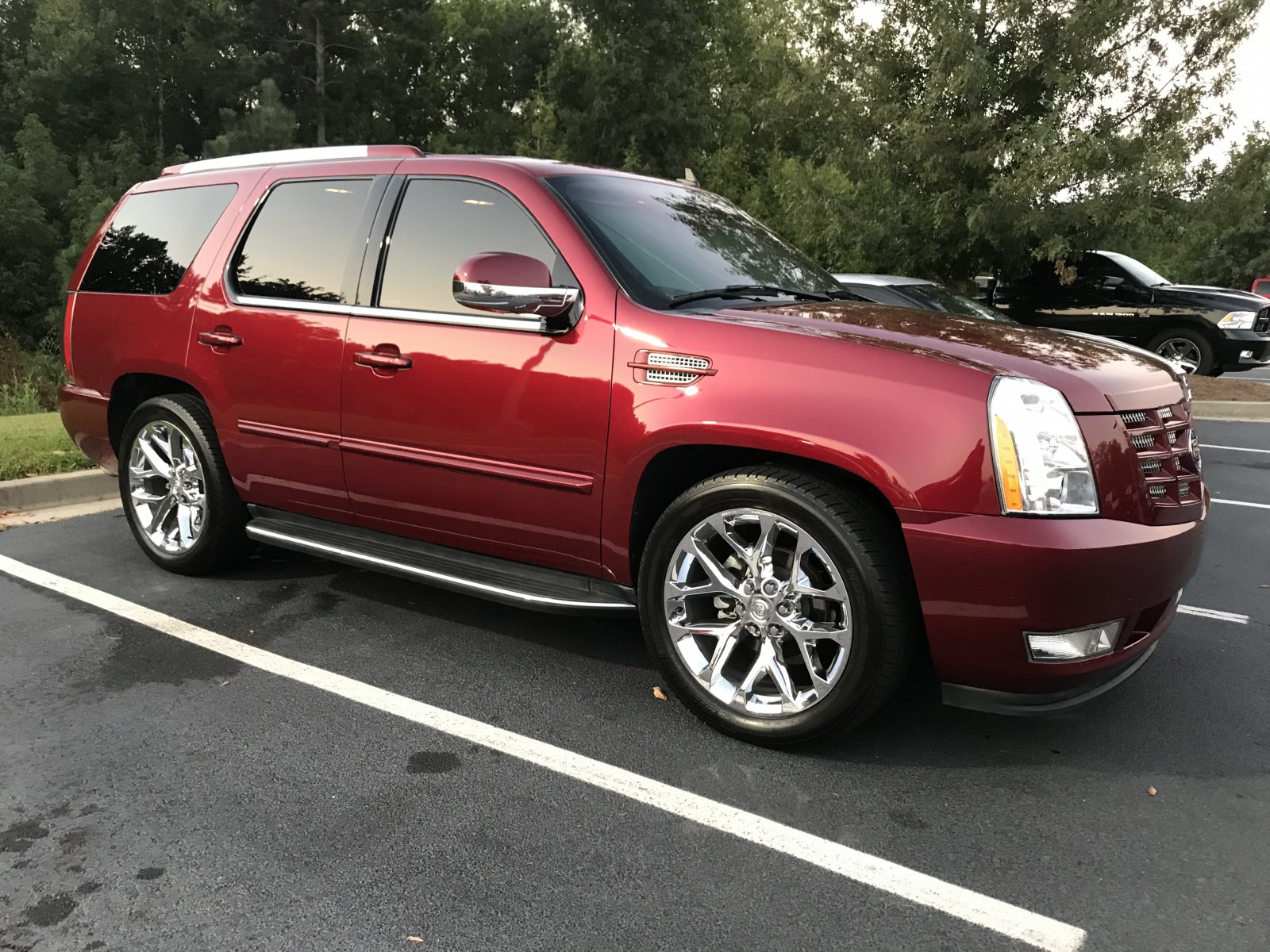

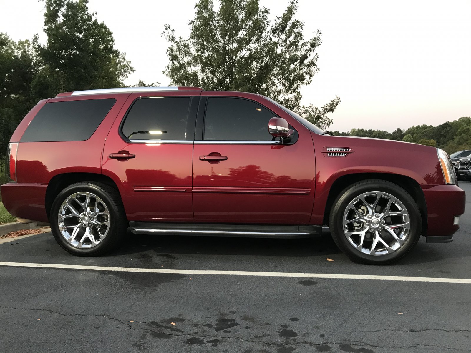

One more. I’m not in love with the DJM rear sway bay links and I wish I could have gotten the caster and camber to the factory specs like it was before but other than that it turned out looking real nice.
