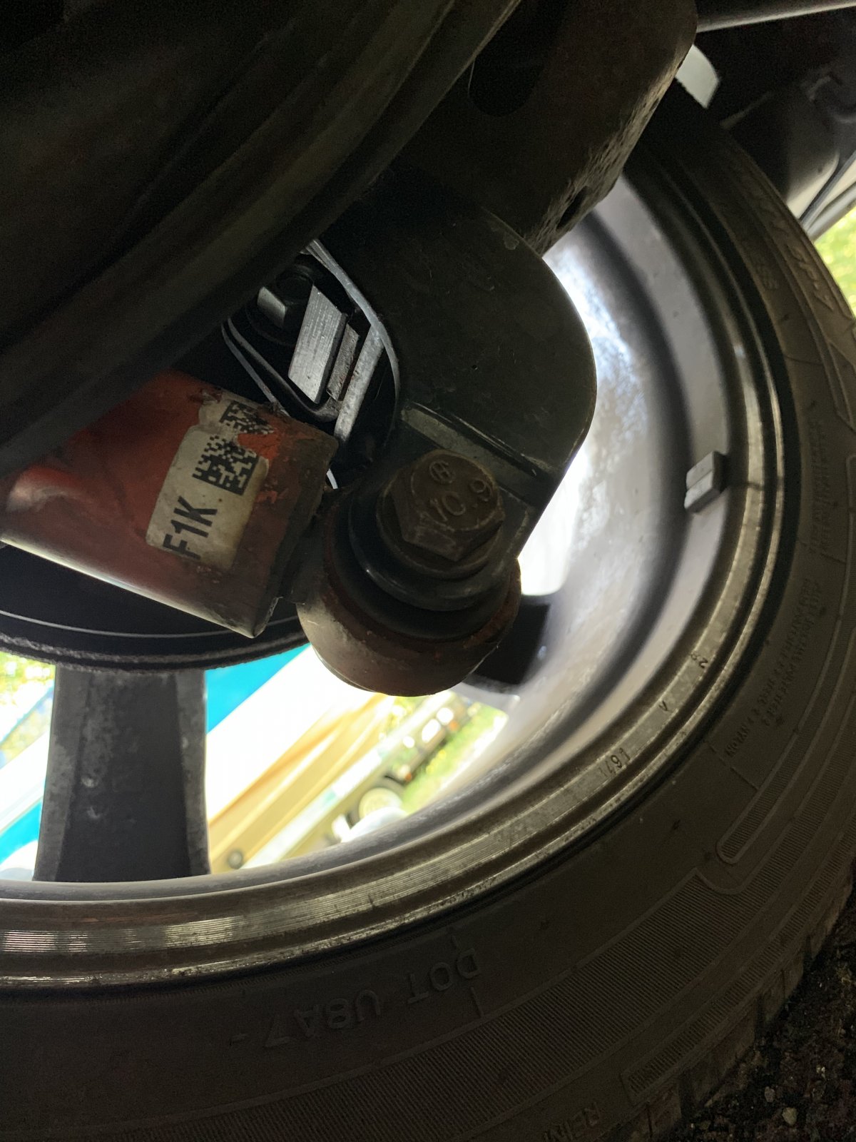

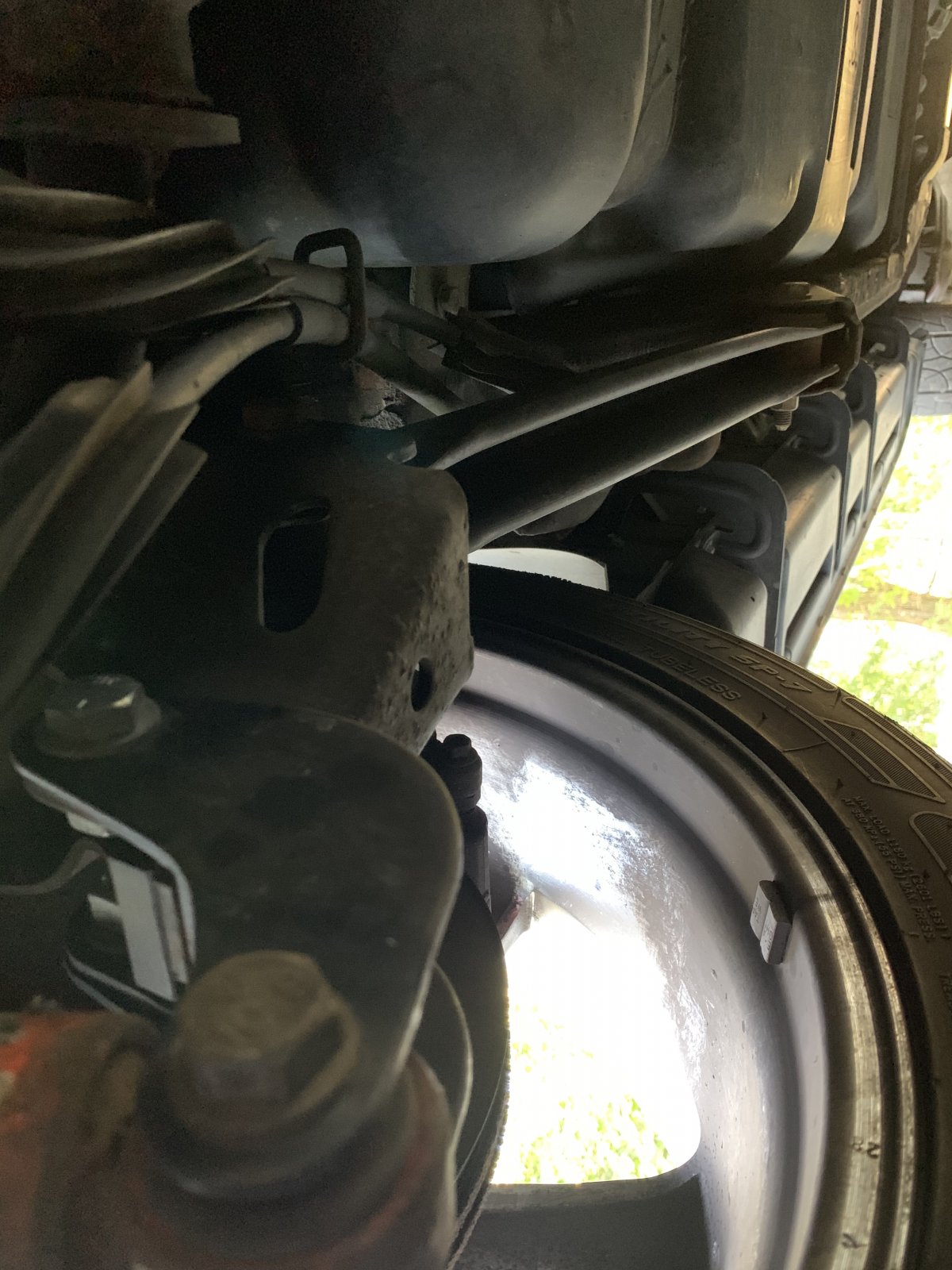

Not great pics but you get the idea

Thanks @Big Mama. It certainly appears that they drop the shock down more than the Belltech brackets. If it isn't too much trouble, could you measure how long the shock is from center of bolt hole to center of bolt hole? And also measure from the center of the hub to the 1/4 panel edge so I can compare the measurements accurately?

About 18 1/2 center bore to lip of quarter panel and 20 1/2 bolt hole to bolt hole on shock. Take note I didn’t turn the key for the shock to air up but I don’t think either would have changed much. Hope it helps. I actually got mine from Chris @iamdub

Interesting. Yours is supposed to be a 3" drop in the rear? My hub-to-fender measurement is 19.5" and the shock length is about 18" with the bags deflated since they're leaking. My wife's not-yet-lowered 2012 Yukon is 22.25" hub-to-fender and the shock length is 19" also with apparently leaking empty air bags. Either way it appears the McGaughys extenders lower the shock much more than the Belltech extenders.
