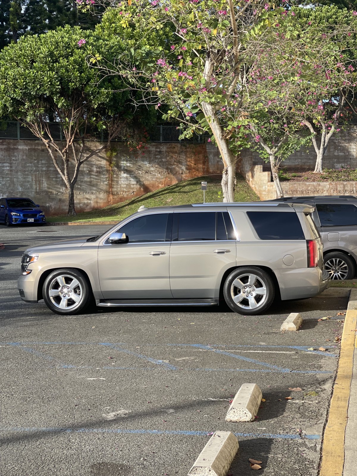

Have it on my girls 2018 Tahoe she love how it run no problem at all . Performed full u-turn
