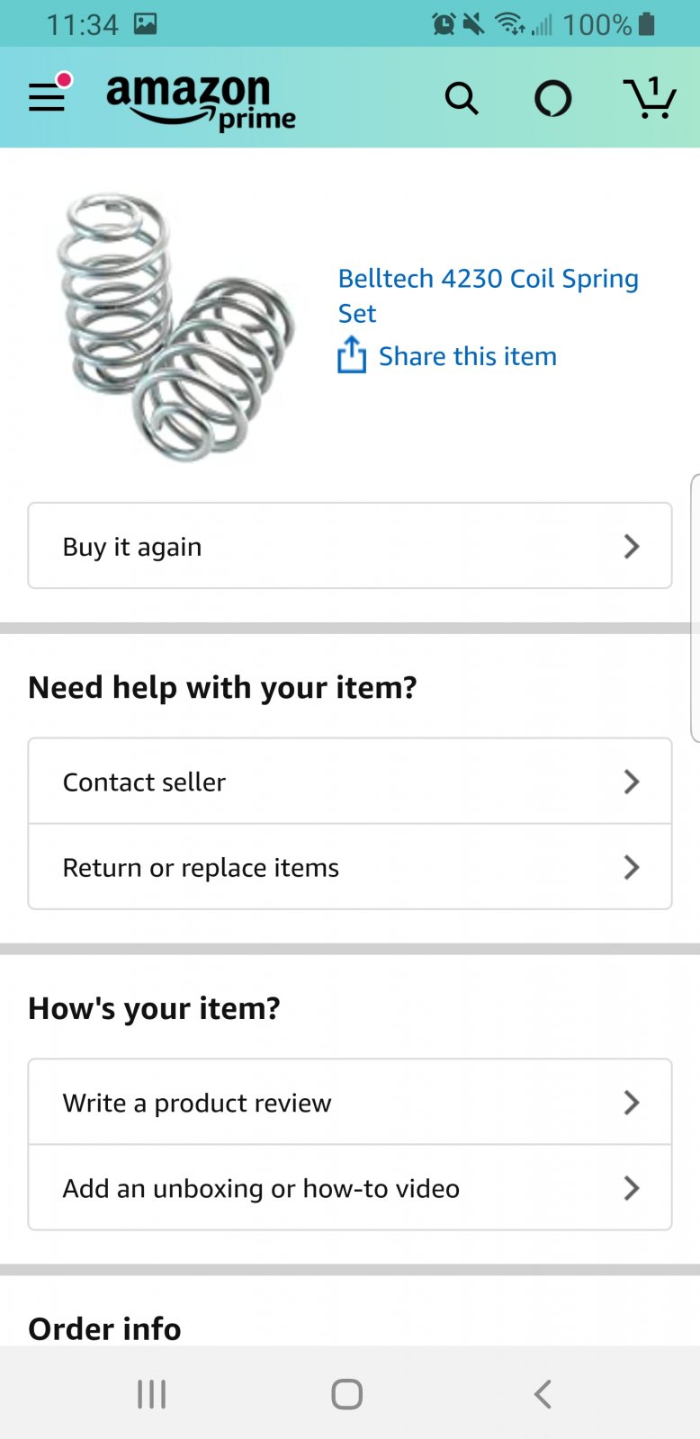

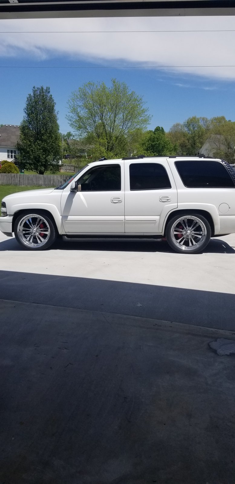

It's like 31 in front and 32 in rear. U can get the coils I got on Amazon pretty cheap. It's the 4230 coils with 60748 bags. that's the same I got. the bags are not fun to get in either lol. Front I have mcgaughys spindles and 3/4 purple keys

I also have 24s on 305 35s. An I appreciate it

I do have the RK2000 DJM kit. Before and after the kit, no changes in ride quality, swaying or drifting. When I hit bumps, they carry, meaning I feel them long after the rebound. Almost like pulling an overloaded trailer at all times is how it feels. See dont listen to no other part numbers. Here's my order

See here's my order so dont listen to any other part numbers
