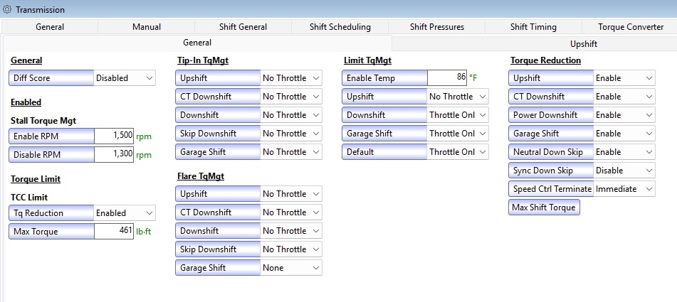

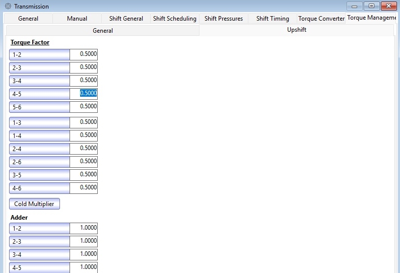

Here is what i did after watching several videos.
Under Torque Management-Torque Factor. I changed everything from 1.0000 to 0.5000
Under Torque Management-General-Speed Ctrl Terminate. Changed from Torque Ramp to Immediate.
Drove it for about 10 miles. Shifts are faster and it just feels better.
