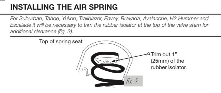

I just drilled the 1/4” hole to an 1/2” hole in the isolator like the instructions show.
