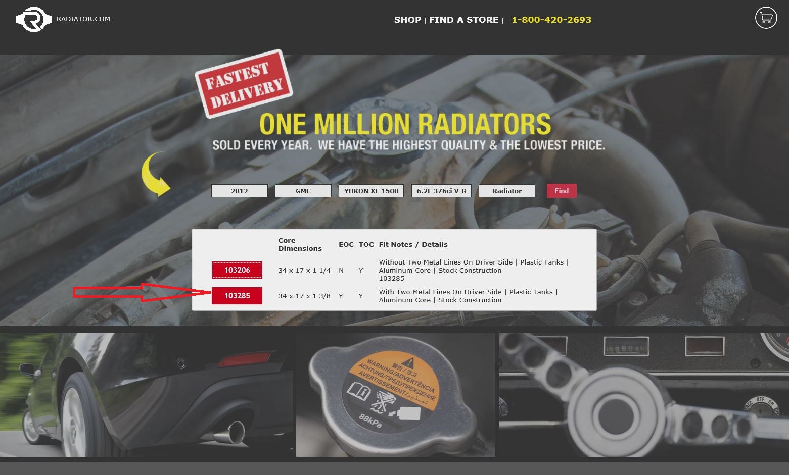

1800radiator lifetime warranty on there stuff, I bought one for my 2012 it's a smidge thicker than oem like 1/8" and I got the drain petcock back that gm deleted and it wasn't $400 more like about $230

Where did you find one at that price?
1800radiator
