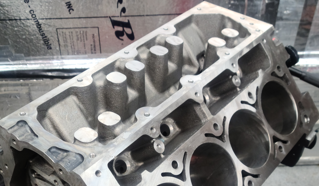

Plugs?
Towers have holes?
What is this? :eek:
(I'll use any excuse to flex my block :angels2:)
Luck of the draw really, block was on sale when I was doing my afm/5.3 delete.
a little something from 2021.
factory new GM block, towers in place but not drilled for AFM.
This was about the same price as having my 5.3 block machined but minus the wait.
I'm still using the valley cover that has the o-rings built in.
While I don't need the o-rings, I have them in place, I figure at a minimum it prevents some false knock should the cover make contact with the towers for some reason.
I don't think you really need to worry about plugging the holes + it's just one more thing to worry about.
On the other hand, you could plug the towers and leave the afm valley cover in place, saving some $$ if you just use hardware store plugs.
Drill and tap for maximum awesome like @iamdub did.
You just need a way to clean out the oil passageways.
Compressed air, .50 cal nylon bristle rifle brush, lifters out, and with both front and rear engine covers off to get all of the trash out.

Plugs?
Towers have holes?
What is this? :eek:

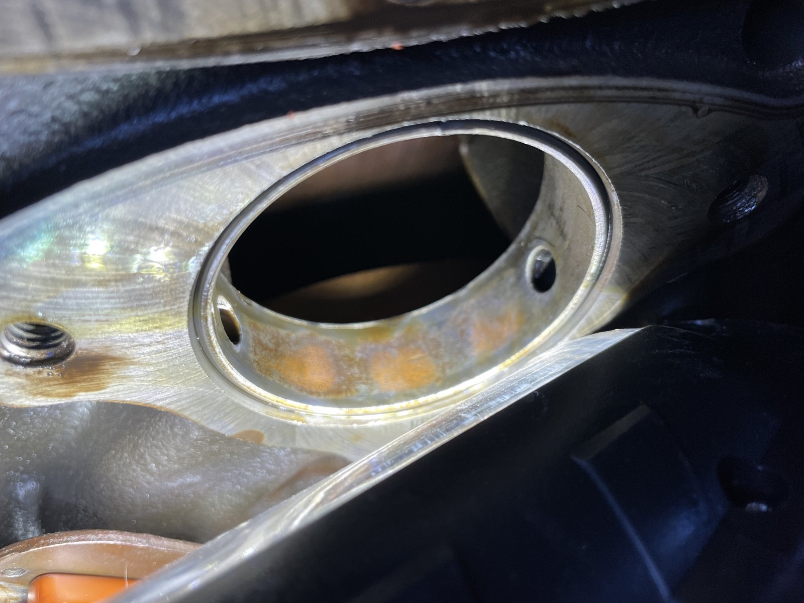

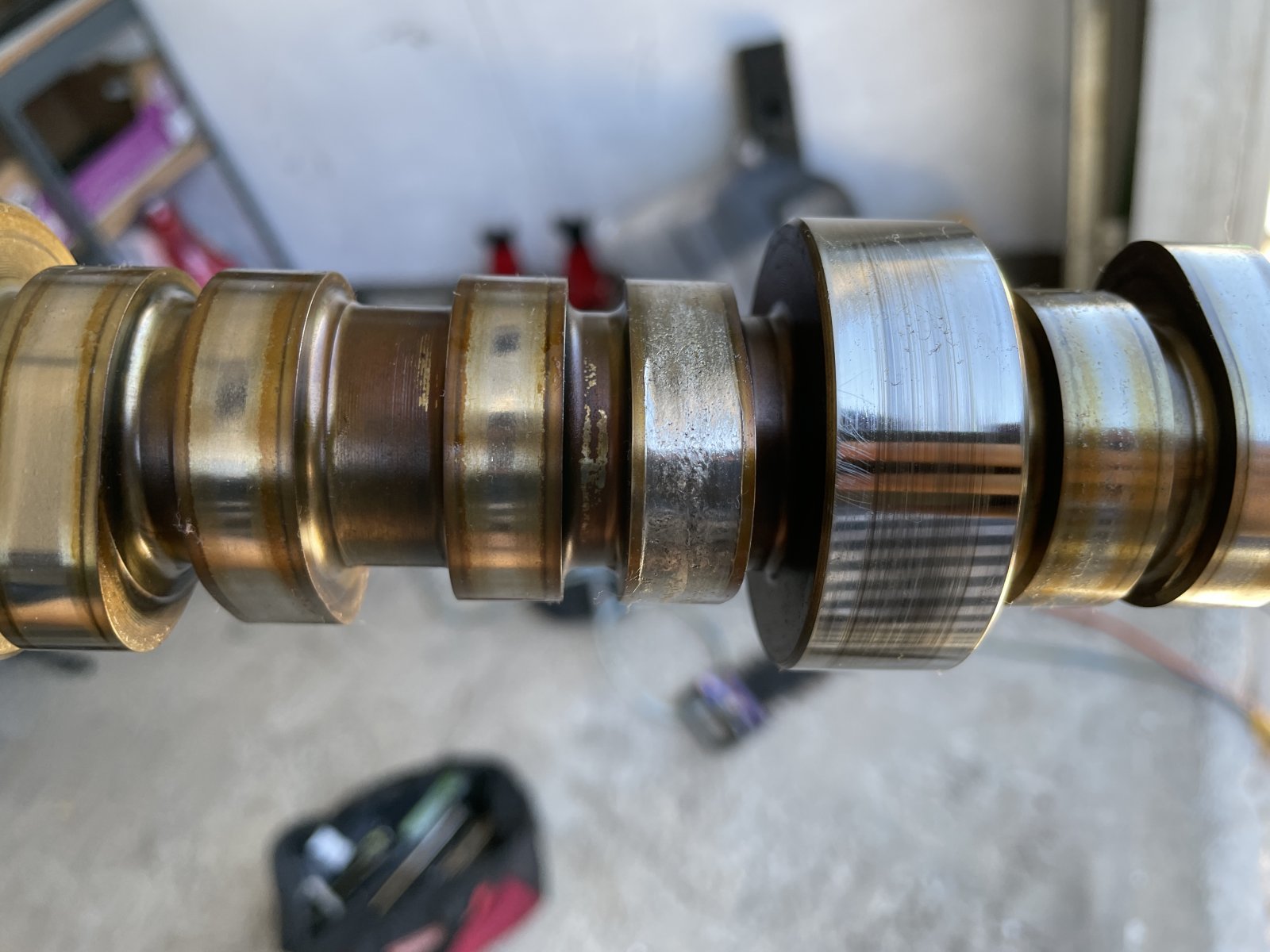

Well guys took the morning off work to take the cam out and here is what I found. At this point I am pretty bummed out, I don't know if I should just throw new cam bearings in it or look into having the bottom end rebuilt. I figure if the cam bearings are this bad the rest of it is probably the same condition. I don't want to rebuild half a motor when the rest of it is on its last legs. What should I do?
TollKeeper
Feb 21, 2010
3,579
7,518
Brighton, CO
I would replace the cam bearings only, just to match the new cam.
Thats assuming you had no other issues, audibly, or visually with the engine that would create un-ease.
Was it just that one cam bearing or were all of them like that? That one looks like the proximity to the damaged lobe was its undoing. Replacing a cam bearing can be done with the engine in the truck as I understand it, but I've not personally done it. I do agree with Brian though that rebuilding the whole bottom end shouldn't be needed.

@Geotrash The bearing in the picture was at the very front and the damaged lob was near the rear, all of the bearing lobes on the camshaft had scoring on them so I assume the rest of the cam bearings look like this first one. I am doing research on how to replace cam bearings for now
Bummer man. My heart goes out to you. Sorry for the $hitty luck.
