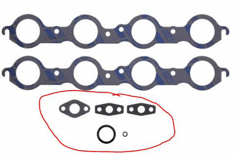

Hey guys what are these parts included in my exhaust manifold gasket set?
No idea. You won’t need them.
Fwiw I prefer the multi-layer steel OEM-style gaskets. No idea how those you have will hold up. Maybe others know about them.
Edit: looks like they’re Fel-pro. They’ll be just fine.
For AIR injection and/or EGR. For the older models. Also, I agree with @Geotrash on using MLS gaskets. You already have those, so run 'em. If they leak, they're easy enough to replace, especially if you use ARP bolts and anti-seize that betters your chances of removing the bolts.
