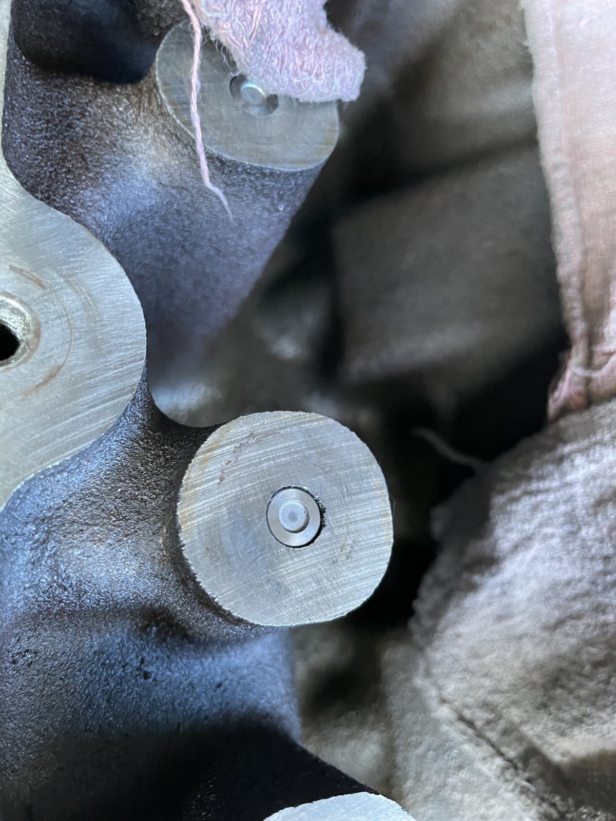

Double checking, the L33 camshaft is compatible to be an AFM delete cam for the 08 5.3 LMG motor?

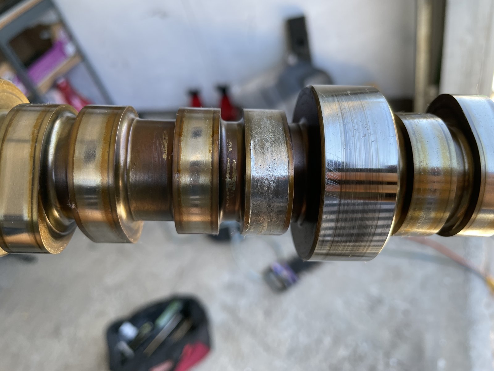

Well guys took the morning off work to take the cam out and here is what I found. At this point I am pretty bummed out, I don't know if I should just throw new cam bearings in it or look into having the bottom end rebuilt. I figure if the cam bearings are this bad the rest of it is probably the same condition. I don't want to rebuild half a motor when the rest of it is on its last legs. What should I do?
I only see a problem with that hammered lobe. The bearing is fine. That's normal wear for the mileage. You think the ones running 300K+ look any better? The front one wears like that- it's normal. Clean all surfaces and slide that new cam in with lots of assembly lube. If I'm not mistaken, you have to have the rods outta the way to replace the cam bearings due to the tool needed. Or maybe it's just a PITA with all that in the way. If you go that far, you might as well do a full rebuild.
Yes. Its specs are identical to those of the AFM cam, just with all matching lobes. Your stock tune would be 100% compatible with the L33 cam. There are other similarly-spec'ed cams that would run just fine on the stock tune, but they're not as optimal and would benefit from custom tuning. If you can find an L33 cam, you can save a good chunk of change by not needing custom tuning. You can have AFM disabled from the tune for about $60. This is all my exact original course of action before a friend sold me the Stage2, causing me to change everything mid-build. Some friend, eh?

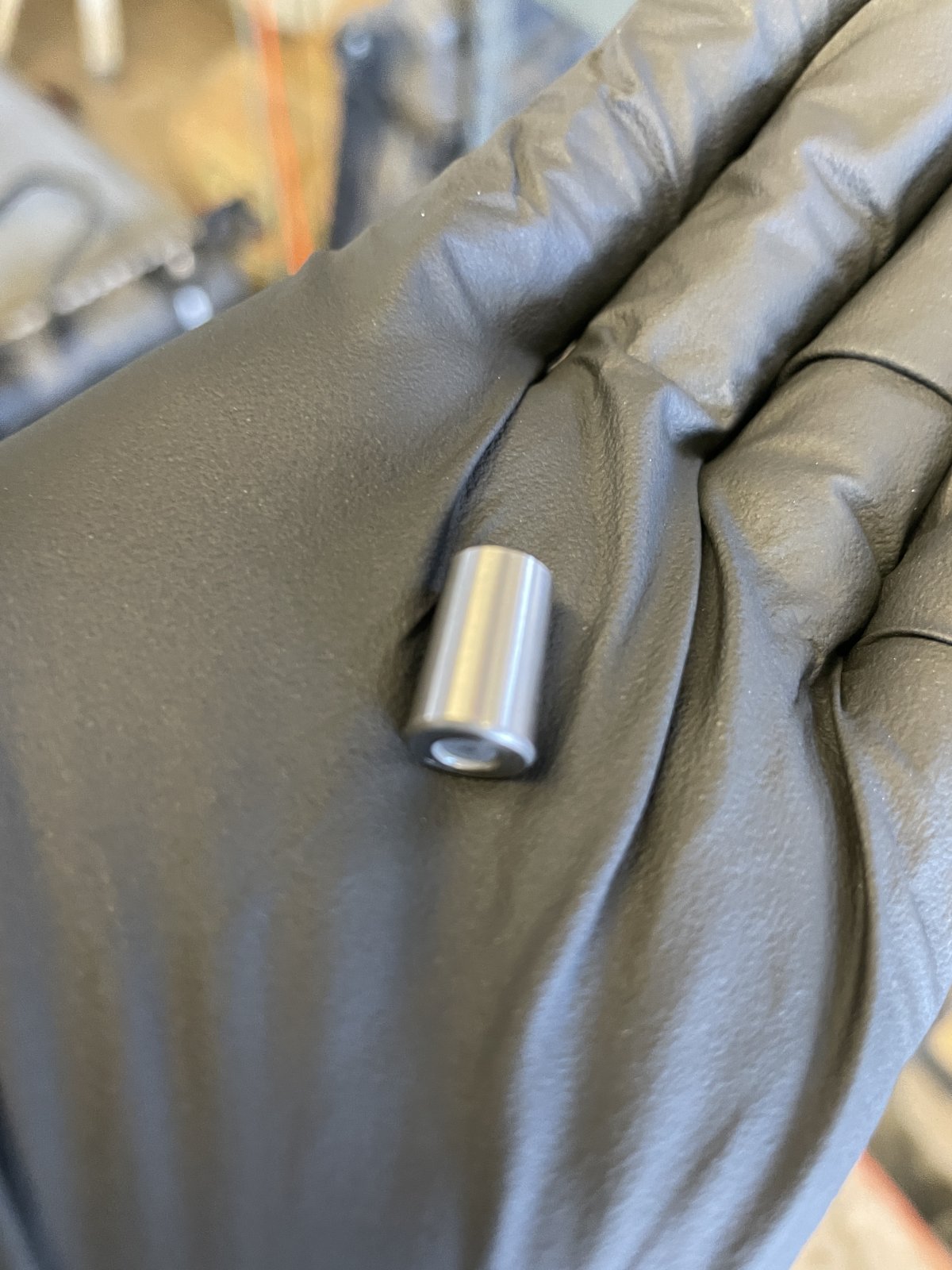

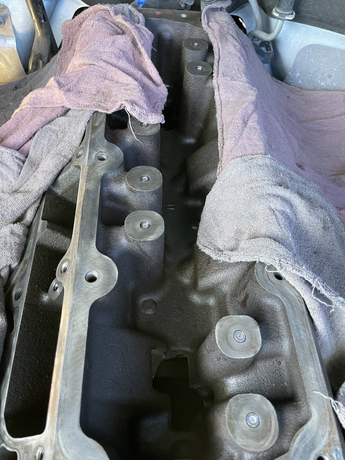

Today was a slow day, just organizing tools and parts, cleaning mating surfaces.

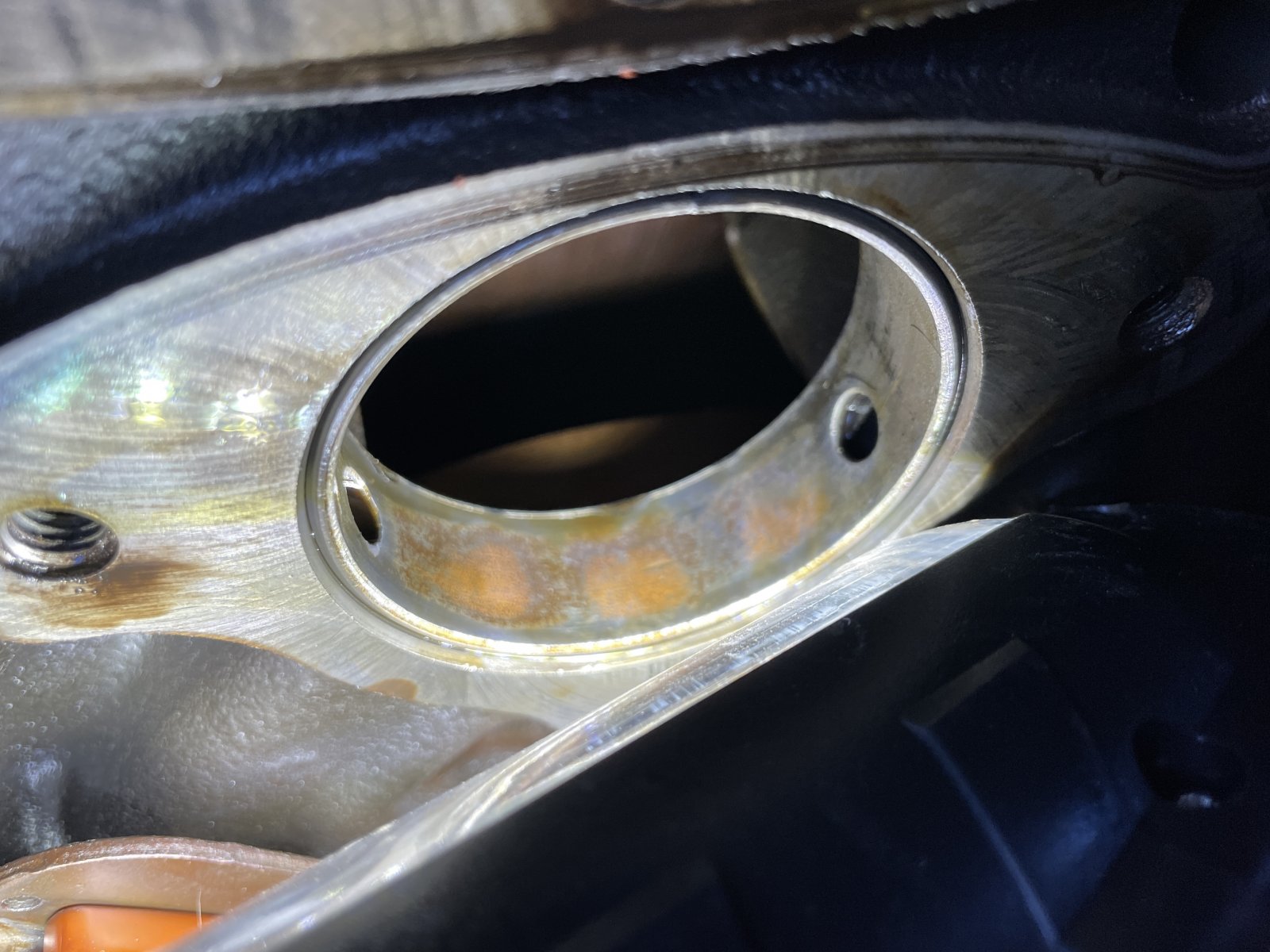

I found that I am probably not qualified to clean the heads. I have experience cleaning iron blocks so I went to town on the aluminum head with a steal carbide blade and then a razor. It felt like those tools were being too aggressive on the head and the plastic blades didn’t have much affect so I’ll take the heads to a machine shop to be cleaned and undo any damage I hay have caused.
Cleaning. The block went well, used a steal carbide blade and a shop vac to get the top, sides, and front cleaned and prepped.
Used that A-37 bearing and hammered them in. I found that when I did it pieces of the block would chip off, I tried using a hammering pin to press it in directly on the bearing but the edge of the block still seemed to flake like in the picture. I made sure to run a shop vac through the top of the block after I put those in.

I'd always invest in having a shop do the heads. A 3- or 5-angle valve job and cleaning pass on the deck can do wonders.
Crank up that compressor and blow out the oil galleys from every way you can reach.
That valley is clean!

+1 on sending the heads to a shop if there is any question about the sealing surfaces. And, I also agree that a valve job is a wise investment.
When I did my heads, I didn’t do any of that though because my engine was relatively low mileage. I used permatex chemical gasket remover and it worked perfectly. No damage.
