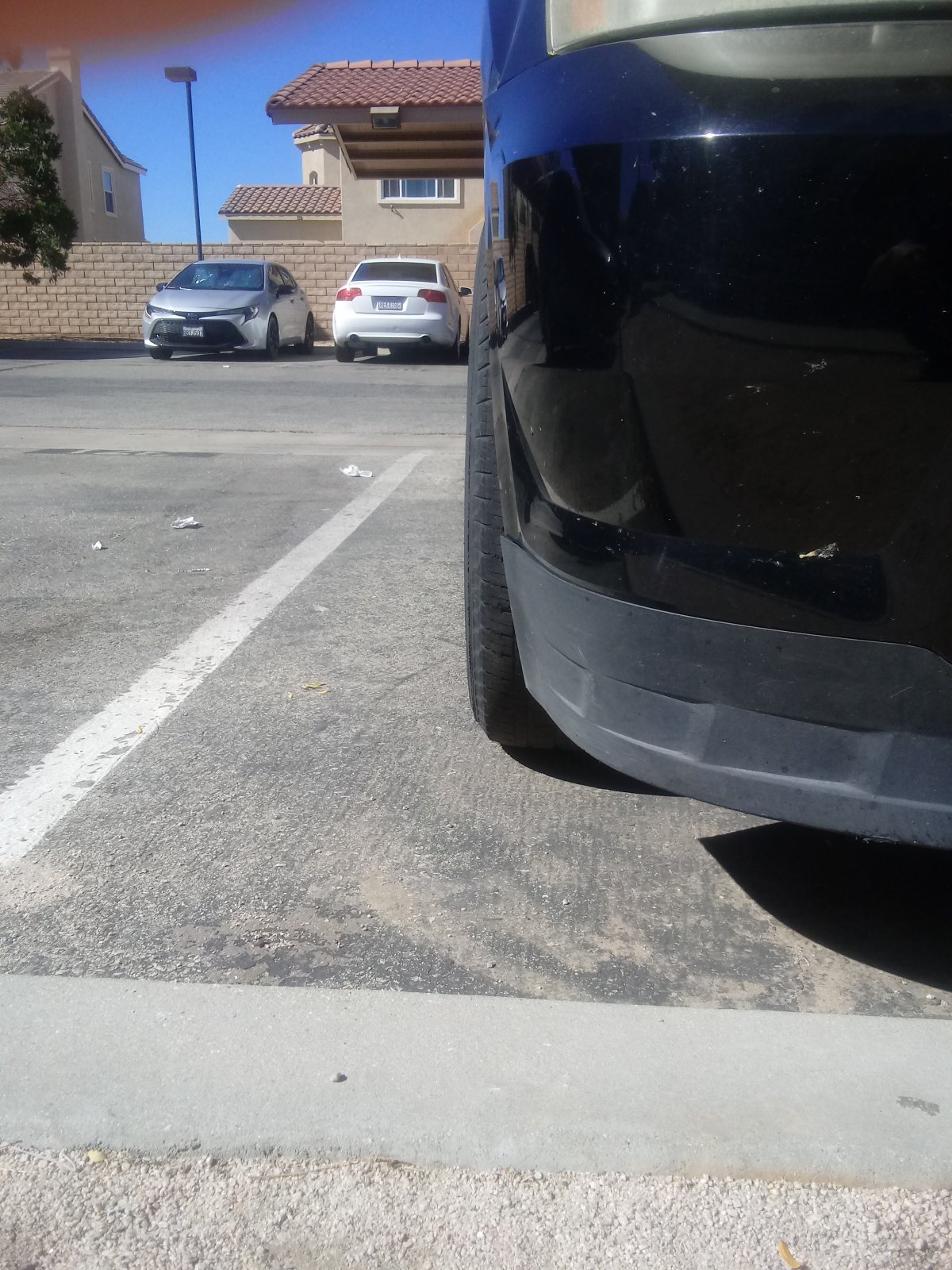

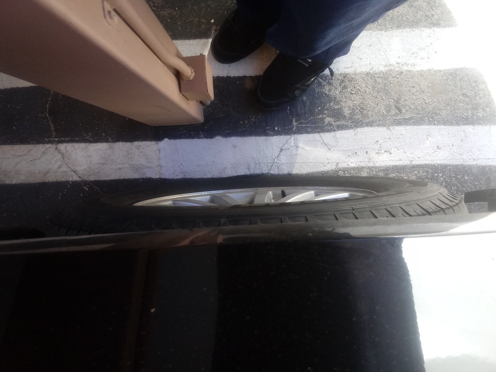

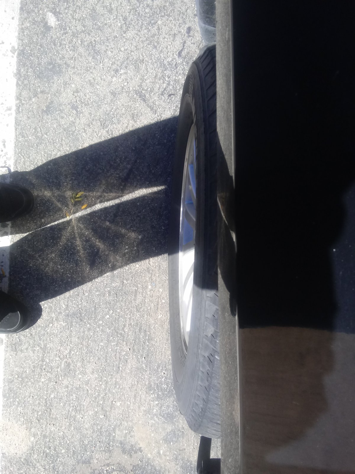

Yeah it's bent...
the wheels are pointed in two different directions
the left wheel is ever so slightly to the left and the right is pointing more to right direction...
both have inward camber

You can't tell comparing them to the fenders. The fenders taper in towards the front which will make the wheels appear toed out. Their shape also make the wheels look cambered when viewed from the front. Anyone with a good alignment would get the same impression if they looked at theirs from the same angles you're referencing.
That looked like too light of a hit to do any serious damage. The steering wheel being off afterward indicates something or a few things are damaged. It could be a simple bent lower control arm. Judging by the angle of incidence, I'd say that righthand lower control arm is bent backward a little. Maybe a bent tie rod end. The force could have damaged the rack, too. A difference too small to see can still make a huge difference. The only way to know is to have it looked over by a professional with an alignment rack, like at a collision repair center where they can measure the reference points of the frame and suspension components. If you wanna eyeball something out of boredom, compare the front wheels' fore and aft location in their respective fender openings.
