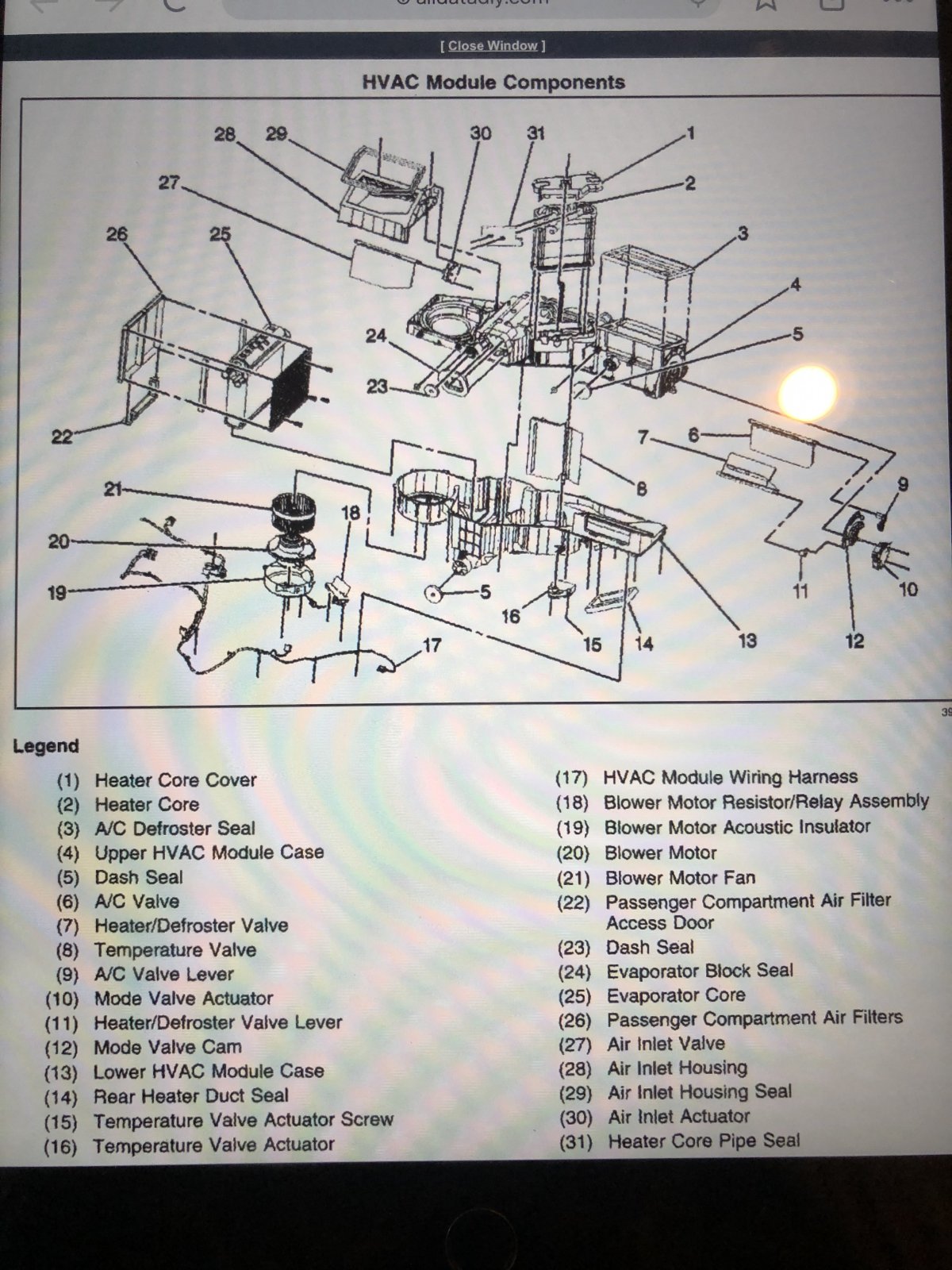

You mean the one on top is recirc? Or air inlet as GM sometimes calls it. I remember that one because I replaced mine and the manual calls for removal of the dash sub assembly which is a lot of work. I was able to work around it by loosening it and wedging it up. Here’s a diagram.

This diagram is backwards and only has single temp zone, not dual. #10 is mode, right side of diagram which would be left side in vehicle. Temp is 16 on bottom and recirculation ( air inlet) is #30 on right side (left side in diagram). Hard to see in diagram but if you look closely it actually comes in from the side not the top. Im not positive but i do believe on dual temp zone systems, drivers temp is on bottom and passenger temp is on top.
52,949
He never said he has dual temp. That diagram is for a 2002 Yukon Denali which should be close to his 05. On my 02, the recirc is on top and it’s almost impossible to get to.
