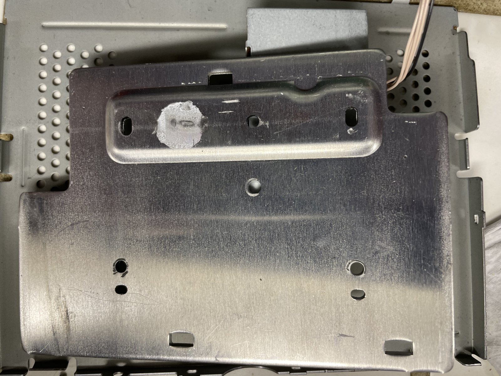

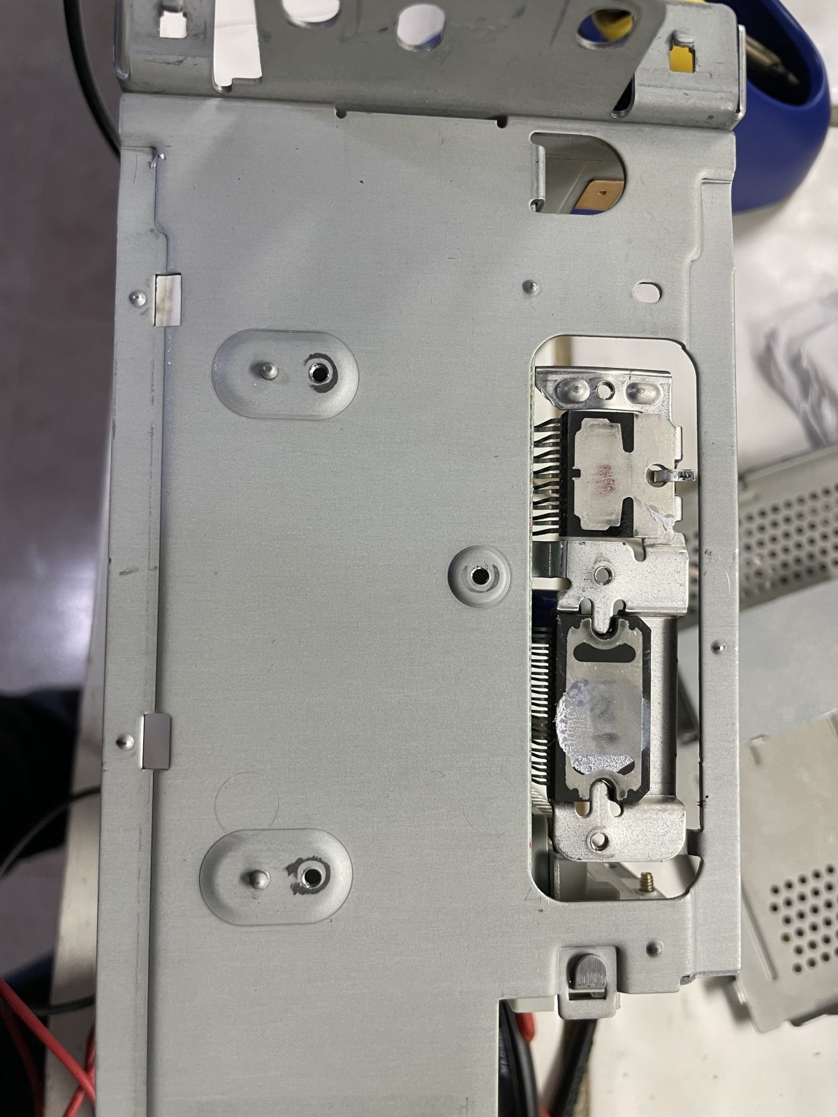

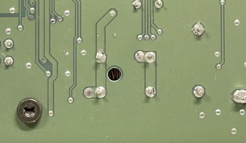

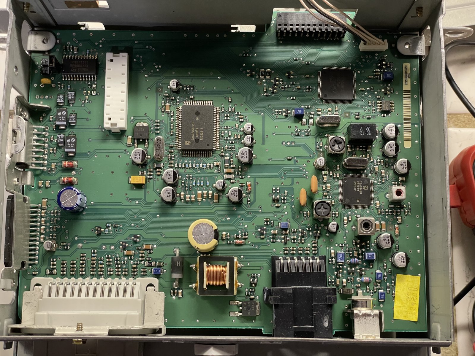

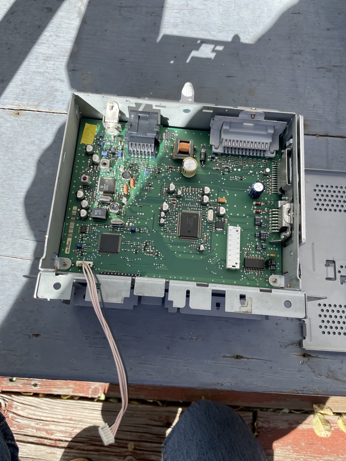

Disassembled it and the main board looks fine. I know late 90s and early 2000’s were known to have solider failures due to switching to lead free solider. Anywho it’s not to bad to disassemble just wish I found an obvious issue or knew where to look lol

Since its out i would hit the larger solder joints with an iron. That ROHS stuff is hard to work with.

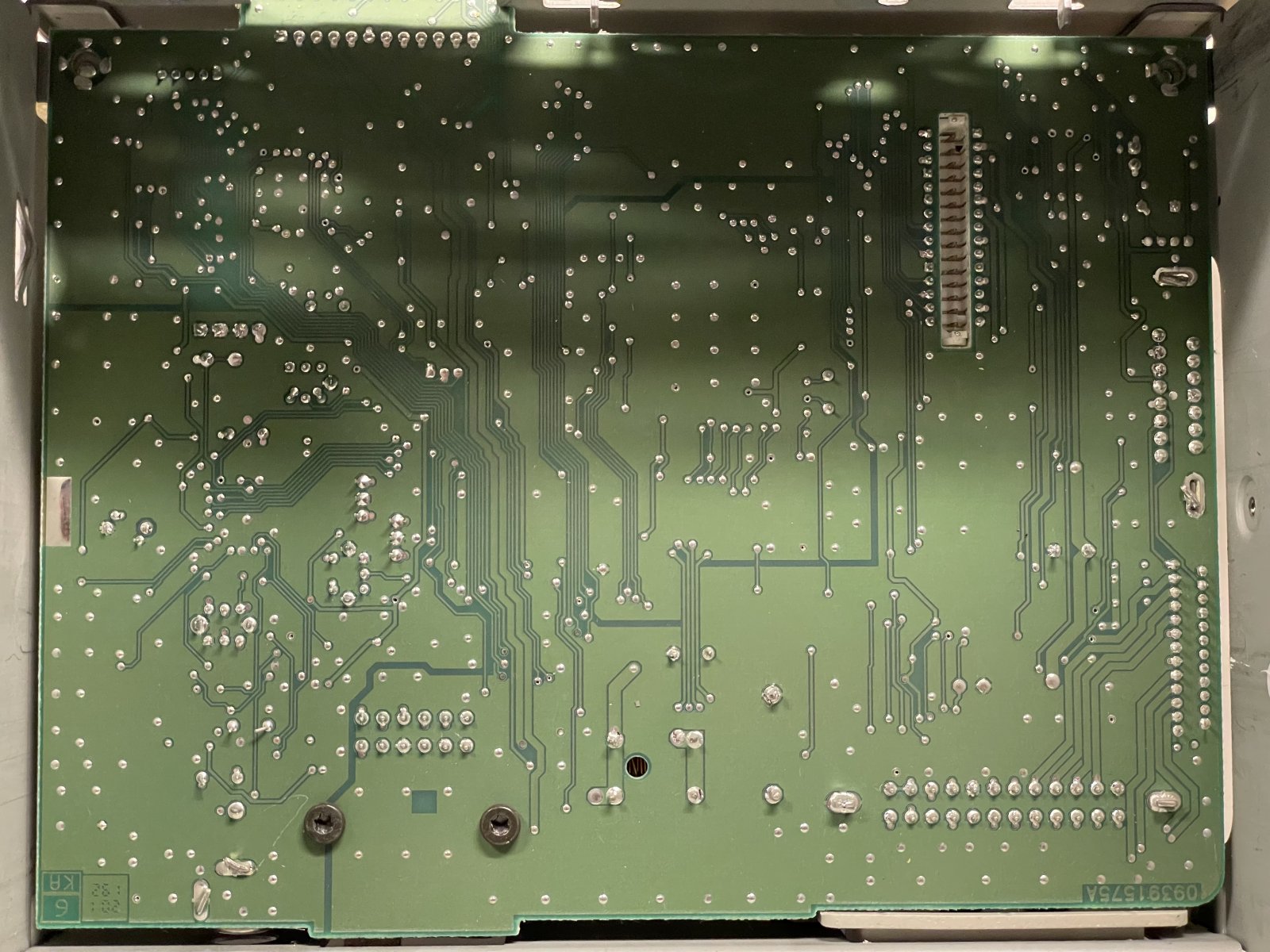

^^^ This. With a magnifying glass I would inspect every possible solder joint on the underside of the board, looking for cracked or weak solder joints and reflowing any suspect ones. Use leaded solder.
You could also reinstall the warm, working radio without the case panels and use an inverted can of "air" to chill components one by one as it's playing sound to see when it quits. That might help you pinpoint the culprit.

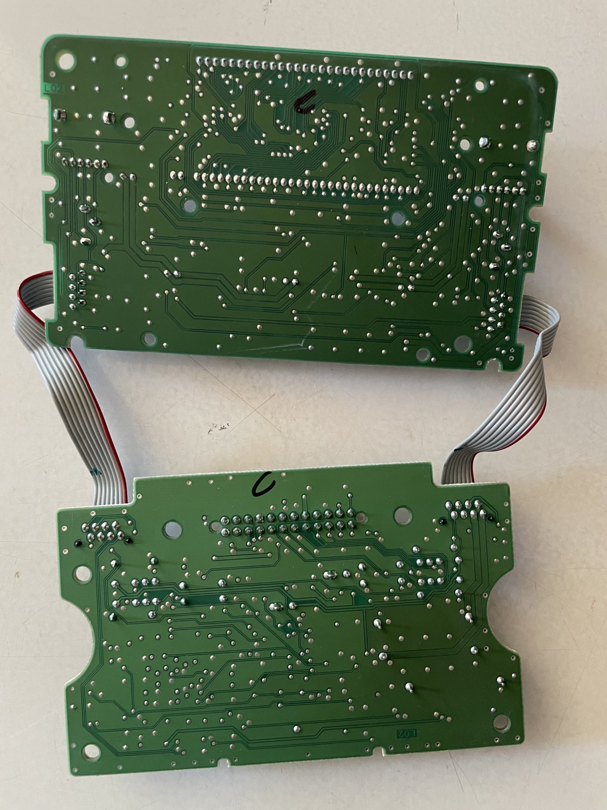

This summer I reflowed all the large soldier joints and where all the pins connect to the board. I’m amateur at best. I just held my soldering iron on the joint until it liquified then moved on to the next.
Only other thing I’m capable of is busting out the heat gun and trying to evenly heat the board up to 300F?
Although I may kill it since it’s easy to overheat a part and fry a chip.

That should be all you need to do for cold soldier joints. Capacitors are the next mostly to fail item, but I don't know if they are heat sensitive. From your pictures they look ok. But I am using my phone to view them.

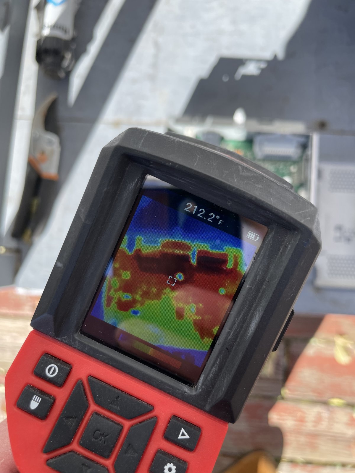

Ugg, I may tear the damn thing down one last time so it’s just the main board in the metal shell, I can get it stripped down but can’t really remove it from the metal box shell. Bust out the heat gun and warm up the board until I see solider liquify. Apparently 222C aka 430F is the magic temperature.

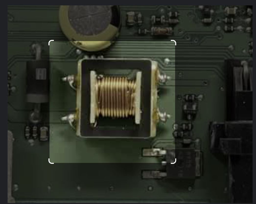

I am no rocket scientist but I have seen these coil/transformer/choke things be a issue before, I would inspect it real good and maybe try to reflow the legs on the board, they change temperature while they are on so if there was anything prone to getting a poor connection when cold this might be it.
look at it up close with a magnifying glass on all sides and feel it to see if it is loose at all, look under the board where it sits also

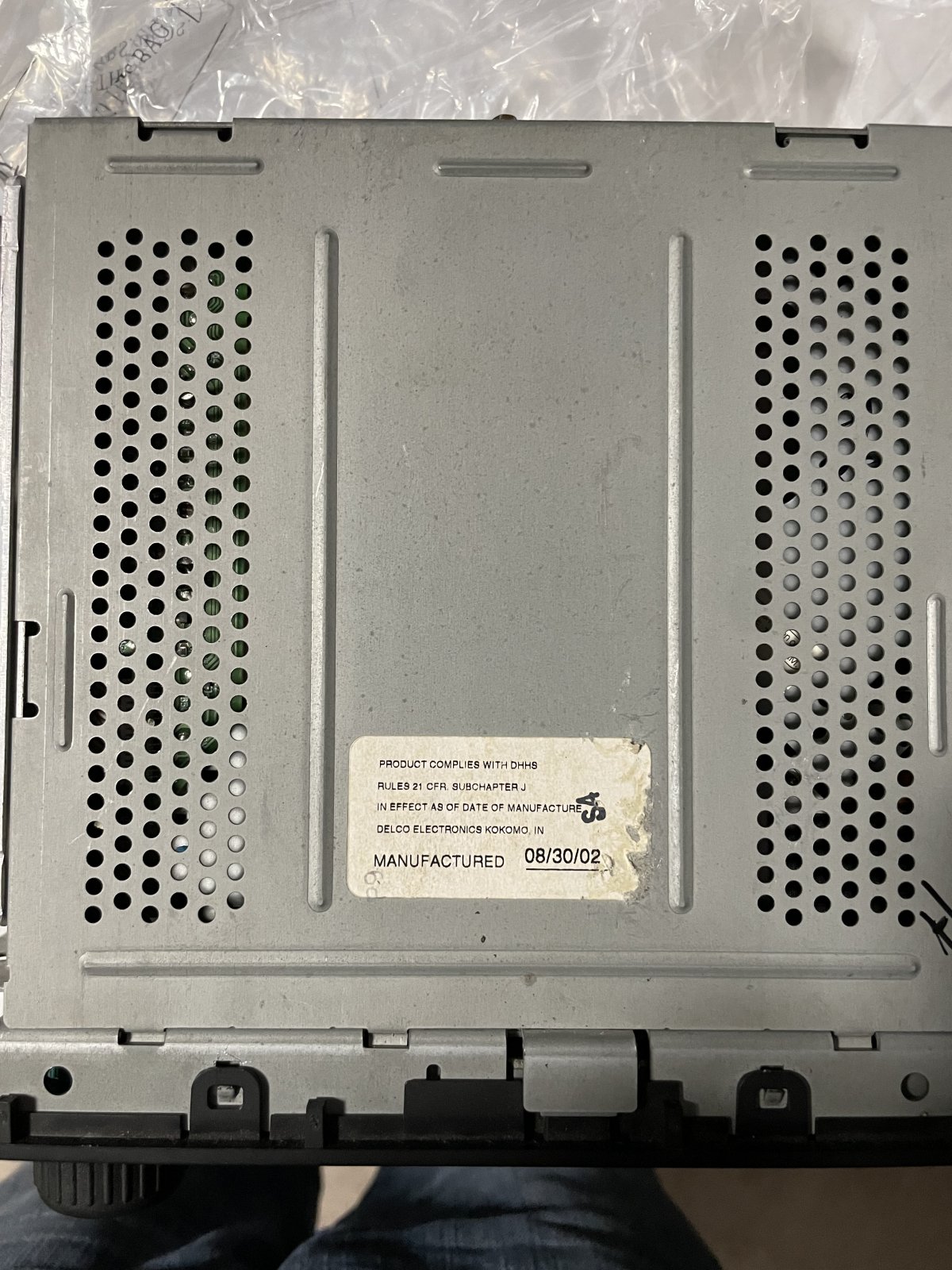

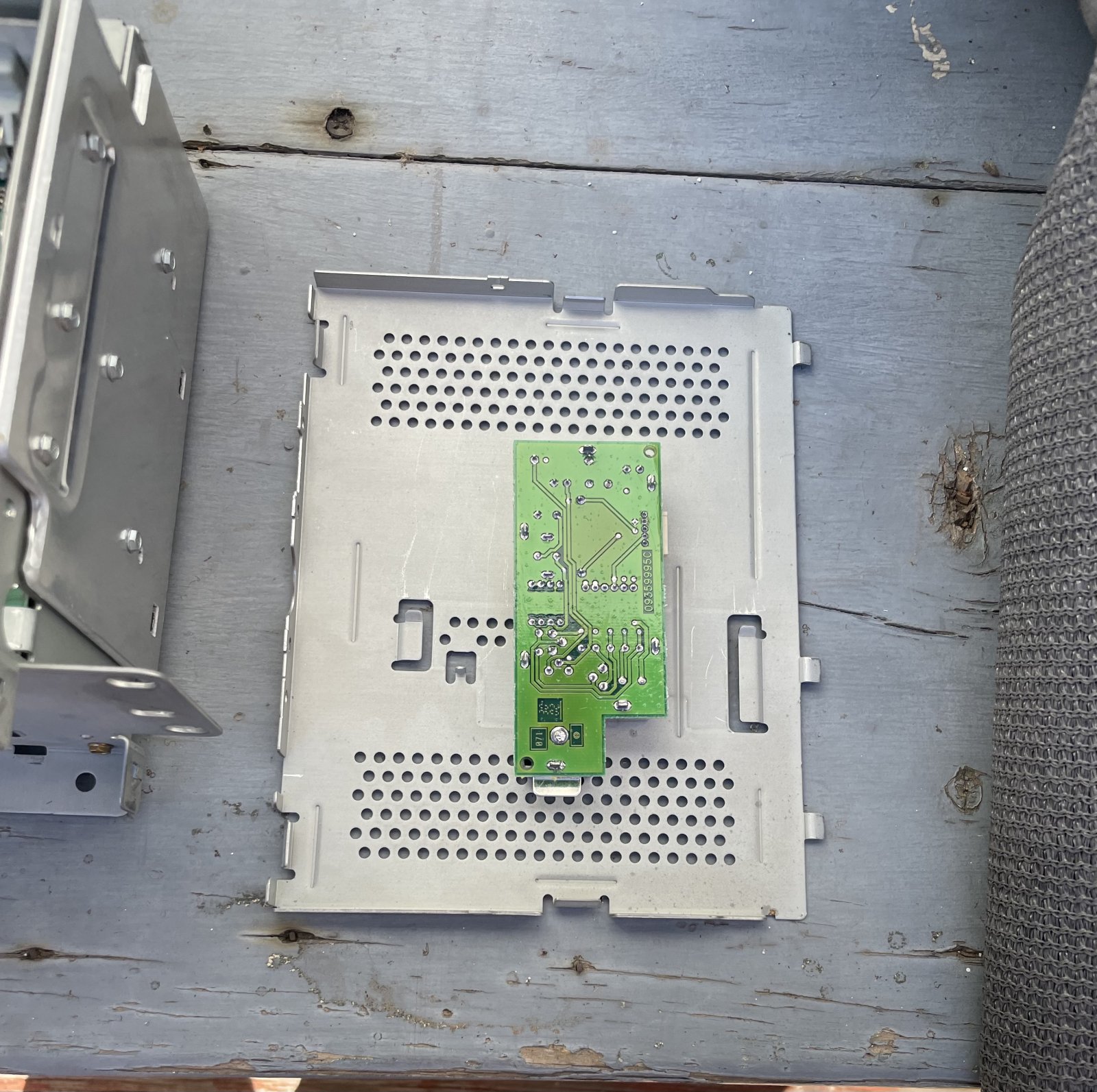

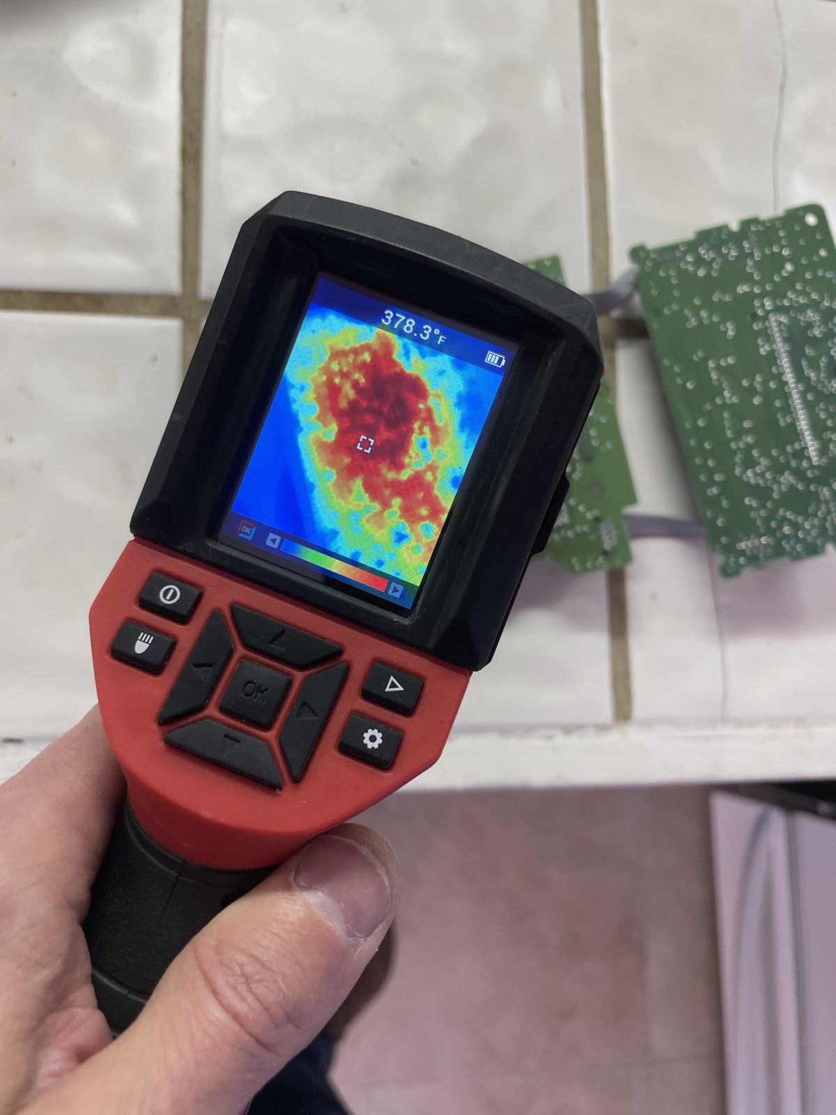

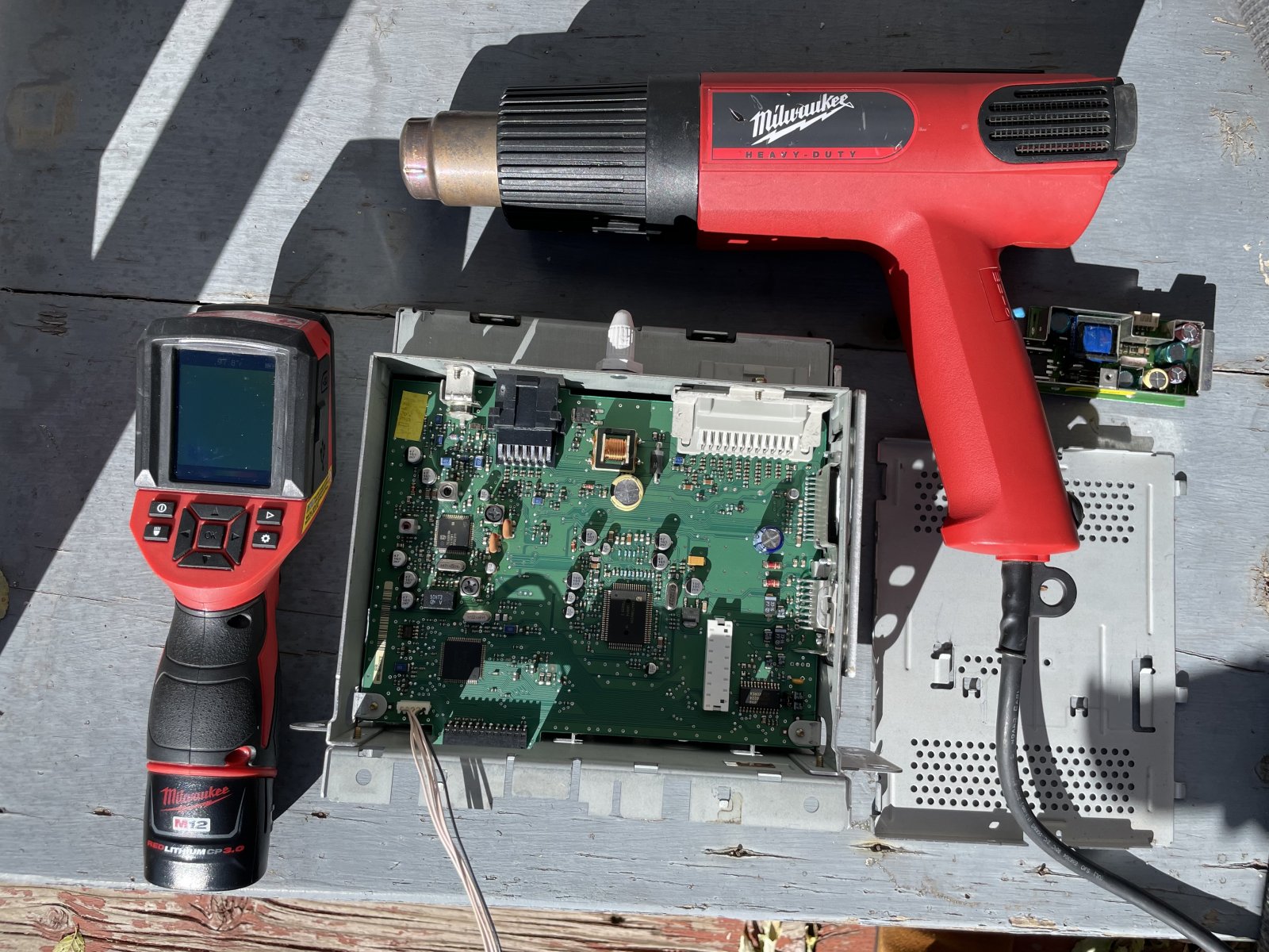

I’m getting pretty good pulling this out of the dash and removing the guts to get to the main board.
I got the main and small power board HOT. Like Brooke shields 1980s hot.
I used my heat gun on medium - high heat. 600F to 800F on medium low fan and went as evenly around bottom of board until my infrared temp gun read 380 - 420F I then flipped the board over and heated the top to same temp. I had to be careful with the fan speed because it would blow over the small brown capacitors. I didn’t see the solder liquefy but I figured high 300s low 400s should be hot enough to fix any joints that don’t function when cold.
I let the whole thing cool down 10 minutes, reassembled and the good news is it still works.
I’ll have to wait for another cold morning to see if I actually fixed no sound when cold

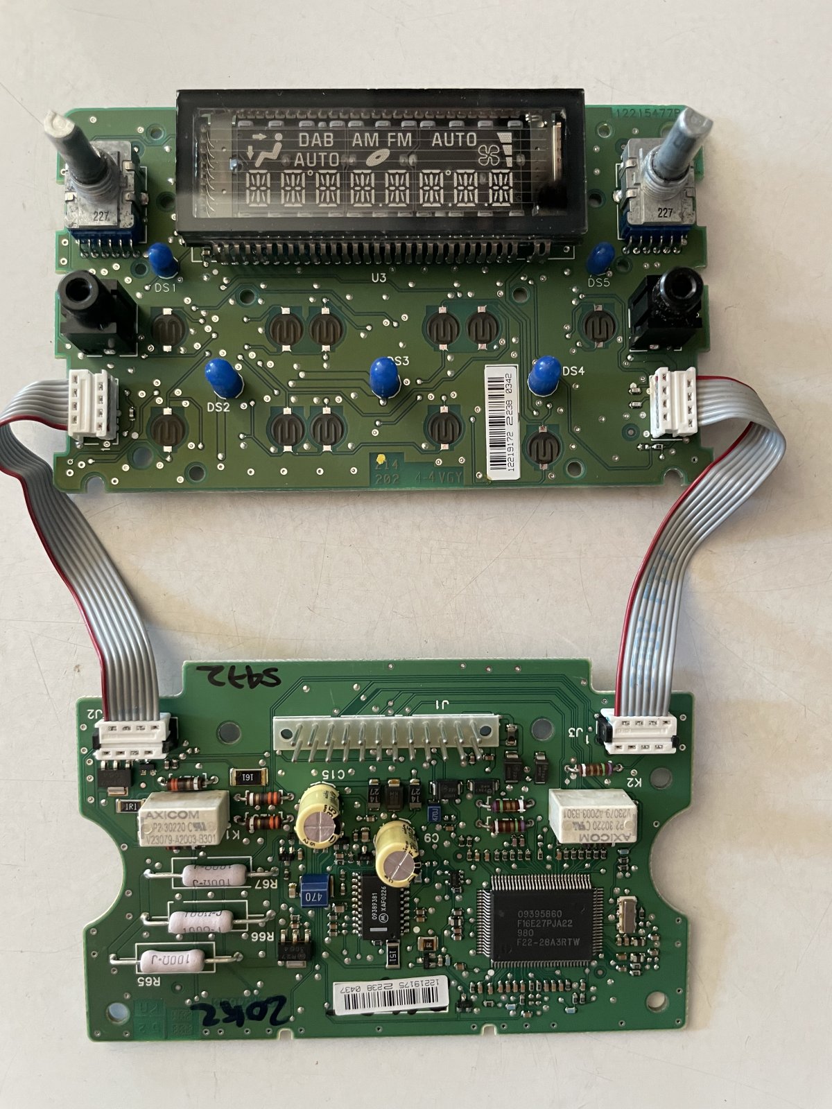

I performed the reheat Hail Mary on the rear seat audio circuit boards as well. I only heated up the bottom of the boards not the front. Didn’t want to melt the RSA display. Got both boards to 380F - 420F.
Rear seat audio has always worked, but thought it would get rid of the RSA disconnect code, but no change guessing this code is coming up because the dash radio randomly loses power reboots once in a while.
