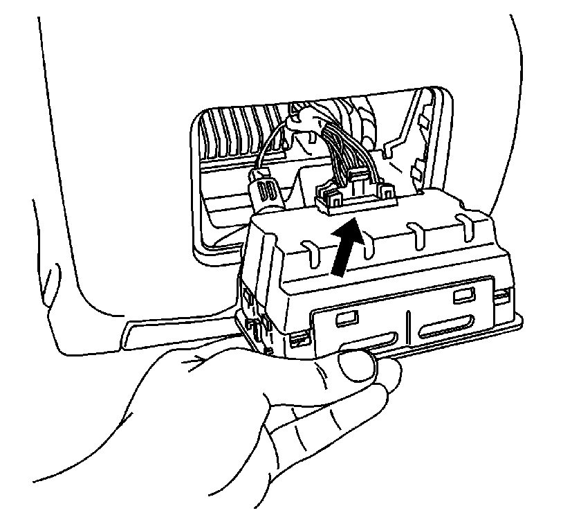

Given that it has some class 2 errors and an RSE error - you may have an issue with the Rear Seat Entertainment. The connector to the rear entertainment/hvac control is inside the console and may have been unplugged or not seated fully when you swapped out the amp. The RSE has a class 2 wire (light blue, pin A1). The intermittent nature of the problems isn't explained, though. Double check that connector is plugged in or fully seated. Might also inspect it for any wiring/pin issues.

Update: I disconnected the rear audio module in your pic and I still get sound but only in front door speakers. Makes sense but doesn’t make sense why I get no sound at all when cold temps.

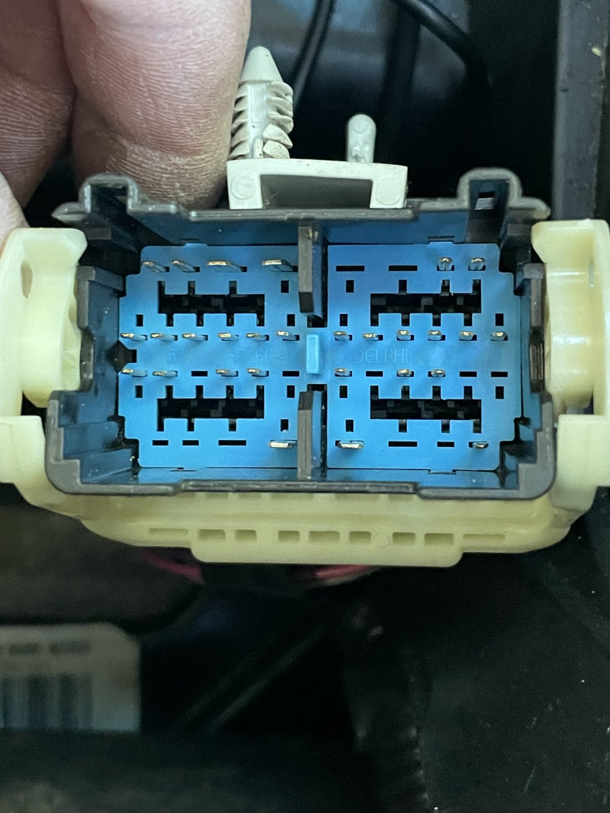

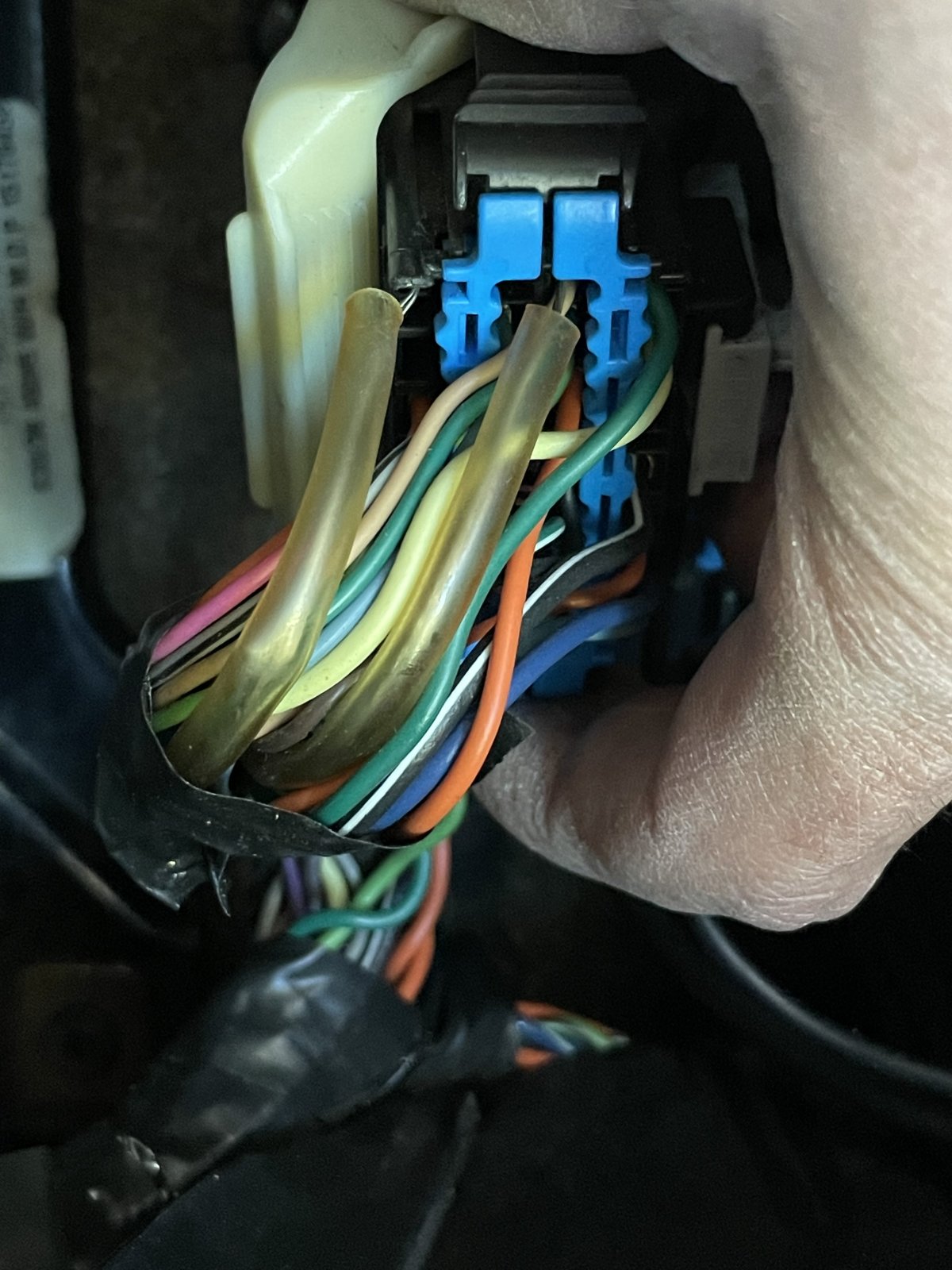

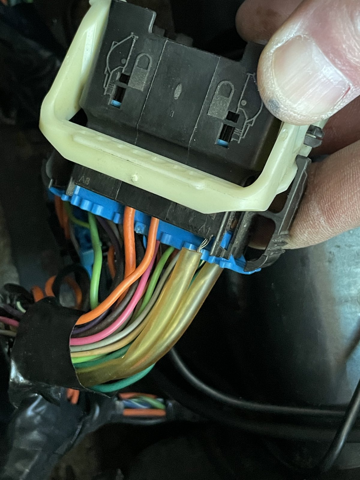

I looked at the main connector under center console and disconnecting that caused no sound at all but radio is on. I looked at all the pins and they are clean. Some odd clear wires that seem like an afterthought but they do connect to the prongs inside connector.

Pics of main connector from dash radio to Bose amp and rear seat audio controls under center console.

I was suggesting that the RSE connection might be intermittent causing the loss of comms. You've also got codes for other modules that lost communication. Most class 2 modules will hose the entire network if only one goes wonky.
Are the codes still active? How were you accessing the "U" codes? What scan tool? If re-seating the RSE connector didn't fix the codes, the issue may be somewhere else.
Check all of your grounds, clean as necessary. Then pull the PCM and look for evidence of water intrusion/crusties. Clean as necessary.

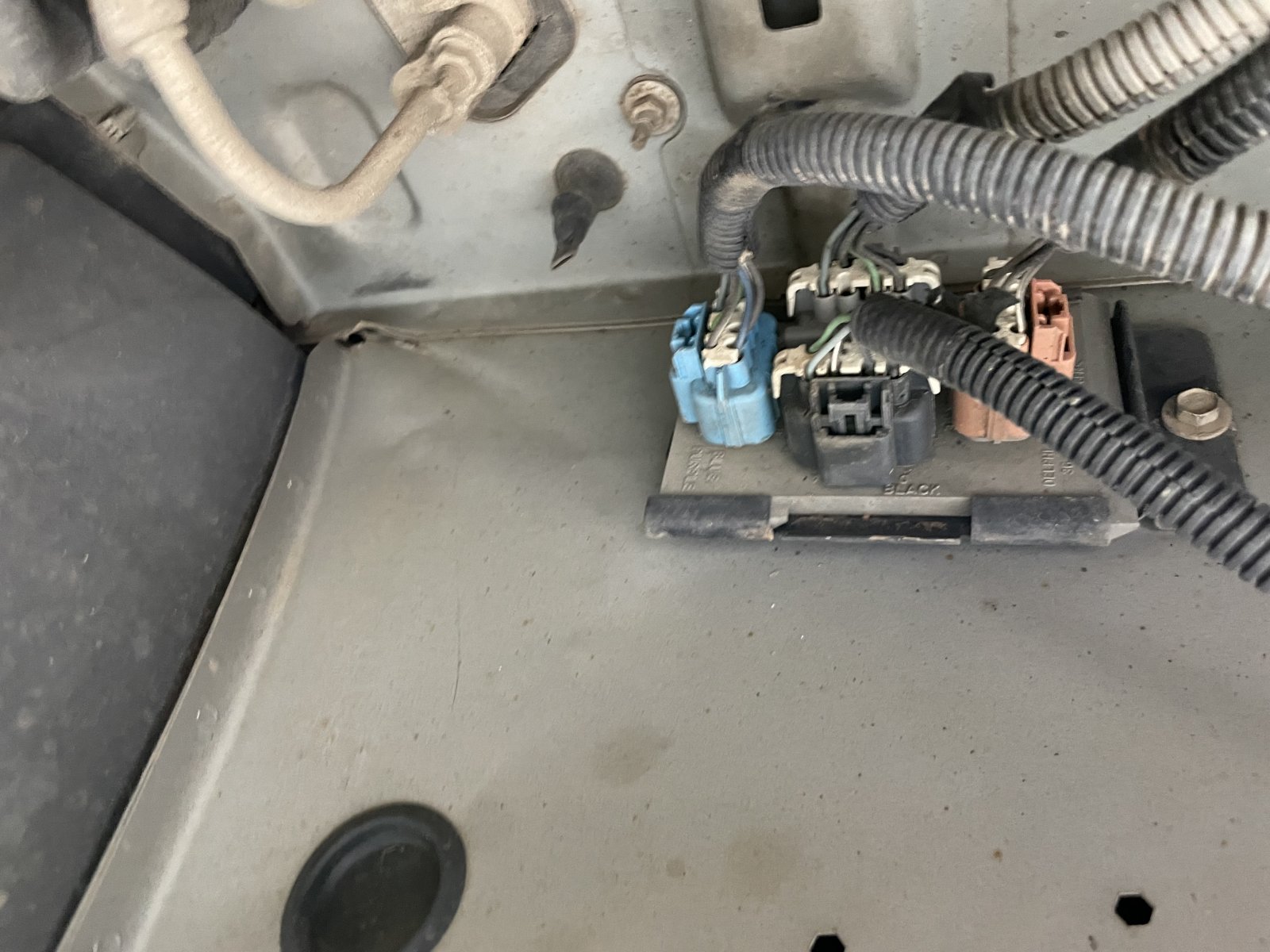

Doesnt appear to have the Z55/Z95 air suspension. So that rules out the Air Suspension Module that are known for corrosion issues.
To explain further, when the corrosion permeates into the module, it can take down, or intermittently take down, the data network. Can create all kinds of hell.

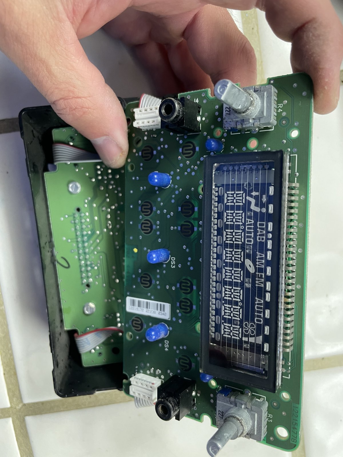

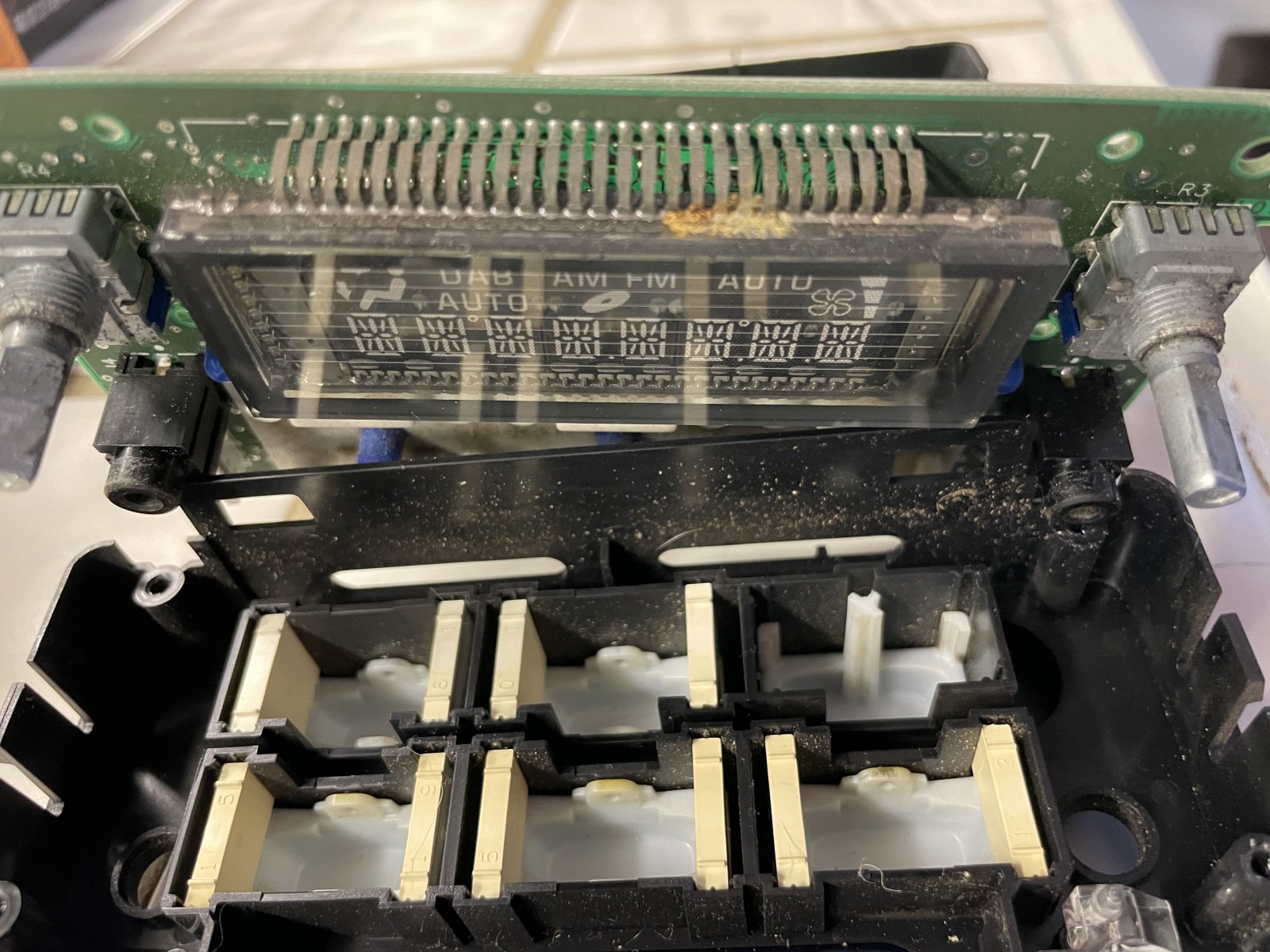

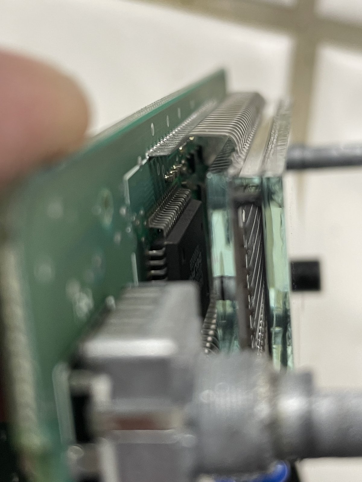

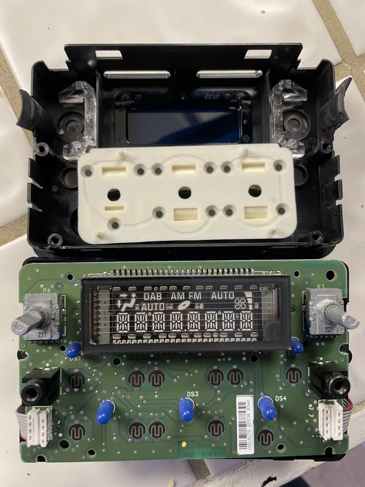

Took the RSE Rear seat audio hvac module out and found some corrosion on the display pins. Cleaned it off and didn’t see any other damage behind display or on the other board.
Reconnected everything and will see if audio still is out next cold morning.
