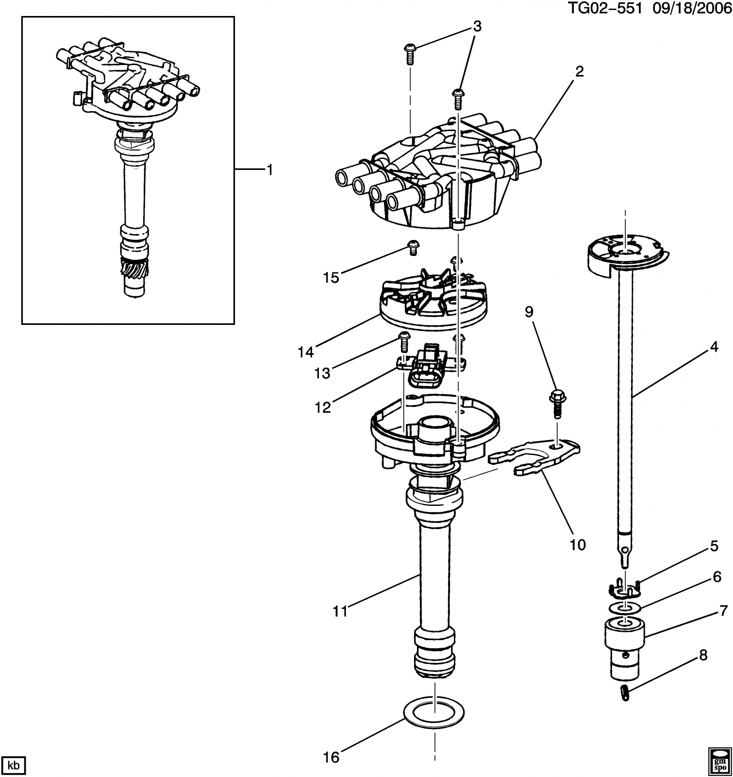

Many of the aftermarket distributors come with the non-adjustable dist hold down. Swap with the factory one and that should remedy that issue, as well as CMP being one of the most misdiagnosed as something else problems. A little more testing and we should be able to pinpoint your problem(s).
Minimum tool list- scanner, fuel pressure guage, spark tester. Total under $100.
First suspect on misfire is dist cap on these. Just sayin. Good Luck!

A few assorted quotes from me unanswered-
"so the next steps are to eliminate possibilities one by one starting with the most obvious or the easiest diagnostic. I think verify that misfires are ONLY on #5 &#7."
" as well as CMP being one of the most misdiagnosed as something else problems."
"Dist cap/rotor, Ign module, coil, Crank sensor are all Delco Delphi only or problems follow."
"Minimum tool list- scanner, fuel pressure guage, spark tester. Total under $100."
"First suspect on misfire is dist cap on these"
"Live data on scanner while driving is a big help also"
"Good dignostics here-"
Live Data- not stored codes- monitor ALL cylinders for misfire, along with as many other items you can fit or watch. Missfire codes are set after a specific number and circumstances, a guess is somewhere in 150-300 range
I think change hold down is 1st step repair. Don't overthink it.You stated it is -10 deg NOT "0"
I’d agree, check that one off of the list. A lot of aftermarket distributors come with those fixed clamps. In case you need it, the GM part number is 10096197. If you’re junkyard shopping, the same part number is used on the 305 and 350. Not used on the 4.3.
