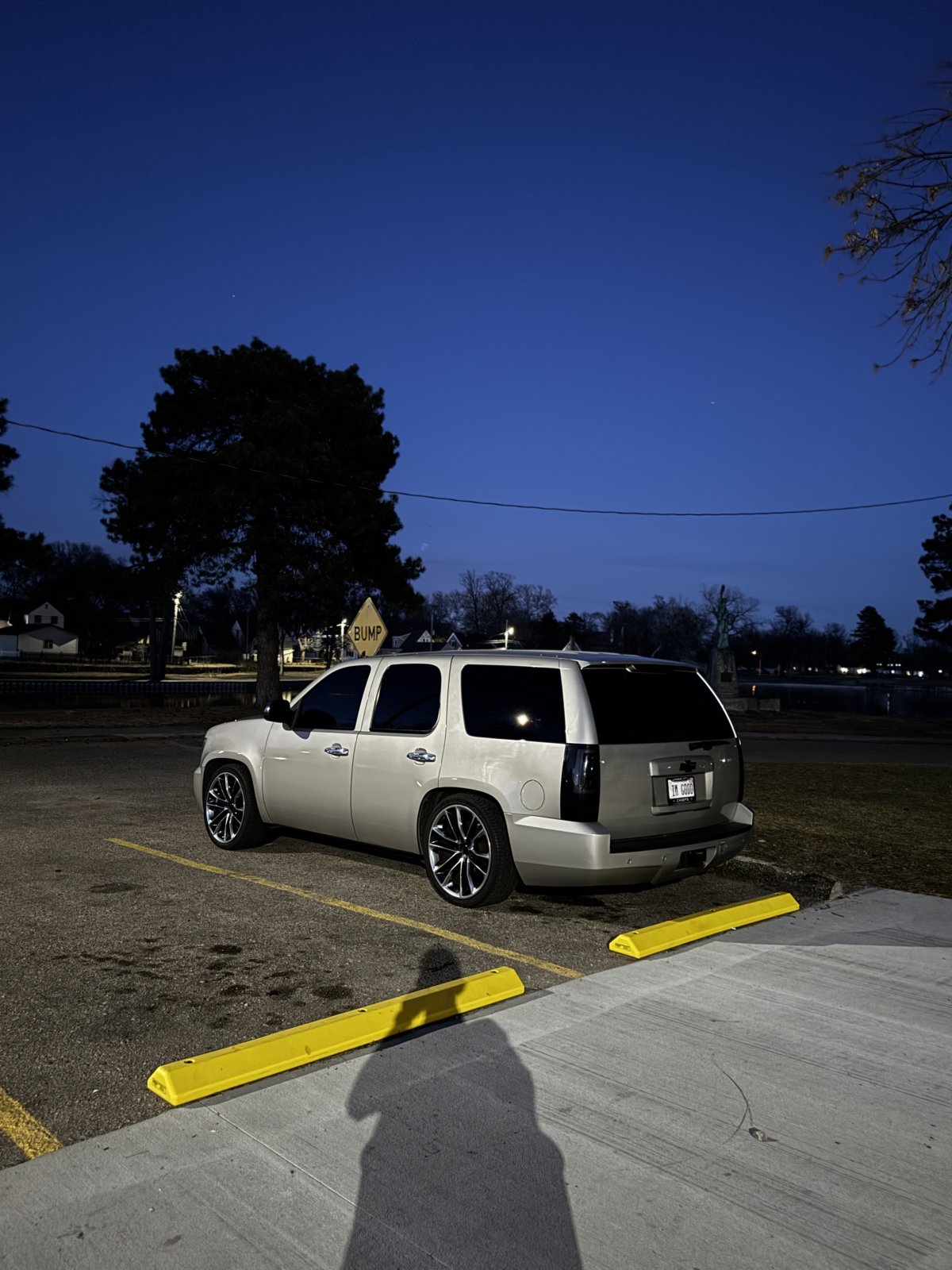

I have a 3/5 kit, then we ended up running different drop springs and struts also added a C notch in the frame. We set it up so we can run shock extenders and rear struts for a 99-06 Silverado. The struts that came with my kit maxed out at that 5 inches so I threw on some Belltech rear 5-7 inch drop struts and made things all around great.
As soon as I get the ride nice, my Bose amp starts having issues hahaha, always keeping me busy.
