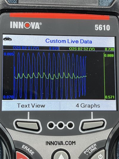

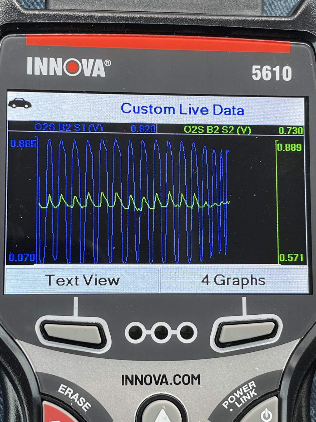

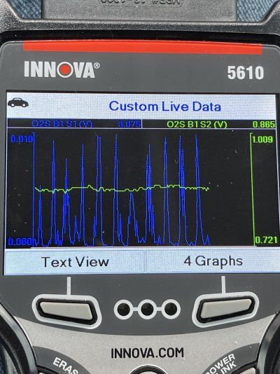

Would the post cat O2 sensor 2 waveform show a bad/clogged Cat? Just learning how to read the waveforms so I can take another test run. Last test after warming engine and viewing at idle the banks had completely different downstream sensor waveforms

I've honestly never graphed my rear o2s but I believe they are supposed to be pretty flat. but how much so, I don't know.

I don’t know a lot but shouldn’t both banks look similar? Is cylinder 5 on bank 1?
