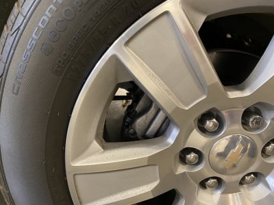

Here’s the 21 upgrade on my friend’s 05 Silverado. These 20” wheels clear with no spacer needed.
Any feedback from actual driving conditions?? Hydroboost or vac boost? Drum or disk in the back of that silverado? How long has your friend had them on? I'm waiting to install mine until more feedback comes across. Not that 2 vehicles are alike but the feedback from real-world driving is important to me.

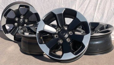

Thats the 6 spoke yes? They make that in a 17" too that fits.
It would be nice to have a library of wheels that clear.
I wonder if these RAM wheels would clear...18x8 ET19.
Same bolt pattern
I just think its a nice tough looking wheel.

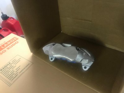

Ok, so I didn't even need to remove the existing caliper to figure out this wasn't even close to working. My 2010 Tahoe Z71 with the factory 18 inch wheels had about .75 inch clearance between the wheel and original caliper, which is very generous. The original caliper measures approximately 3.5 inches from the mounting flange to the outer edge of the caliper closest to the wheel. The new 2019+ caliper measures approximately 4.75-4.875 inches from the mounting flange to the outer edge of the dreaded casting "bump". Looks like new wheels are going to need to go on here since I just bought new bfg ko2s. Pics attached. We need this info stored in a sticky or something, if possible
Vacuum boost and rear drums. They’ve been in there for 6 months I’m wanting to say. Don’t remember exactly when I installed them for him. He said it’s much better, he hasn’t complained and he likes finding things to complain about. I haven’t driven it since then but the pedal feels great.

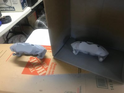

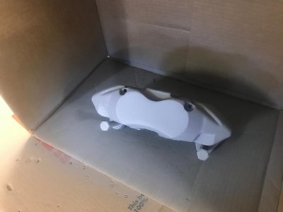

Entering Final Assembly....
They tell me my wheels are in. OMG
So I should have these things on by Tuesday-Weds.
No stickers yet though. :-( The company is in LA, I'm in Orange County (about 40mins), shipped on Tuesday, Still not here.
I really think these calipers would look great machined and clear coated.
Sent from my SM-G960U using Tapatalk
Bro,
Those rotors are looking really gnarly....LOL
At least you don't have to buy new-old ones.
