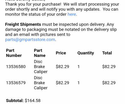

Well just got back from the dealership (one that has always done right by me). There is a national back order in my region. And the few dealers that have the calipers will not sell them unless you have a VIN.
Secondly, they want $181 for caliper. There was a dealer about 1.5hr from me, but don't have that time right now.
I have done countless brake upgrades on GM trucks and have never had an issue with the ABS. Whether larger OEM GM calipers on a different application or building a custom Wilwood set up for my 04 Colorado.
As long as you have a properly operating or maintained braking system you should be fine. As far as the YouTube or Wiki engineers........take what they say with a grain of salt and a shot of something. Hot Rodders have been proving them wrong for years.
Do your research, look at the reviews and go from there. Don't let a single hear say post scare you. I have found over the 20 years of being on car/truck forums one thing always holds true.....those who say, no, engineer this or have never truly wrenched on a car will always be the first to say, don't do it. They're just scared or don't have the skill to make things happen or work.
That's just my .02
Thanks for the advice man.
This is where I got the calipers
https://www.gmpartsstore.com/

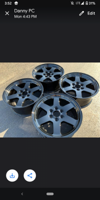

Here are my new wheels, I'm picking them up from powdercoating tomorrow.
20" declads with some 295/45-20 runflats from an SRT8 Jeep
