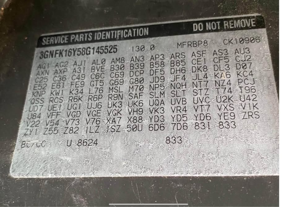

Wonder if a 08 Suburban has the same rear end as my Yukon. Guy about 2 miles away from me is parting out a Suburban and will sell the front diff and rear end together for $350.
It is G80, GT5, 6lug.
Here is the RPO tag
