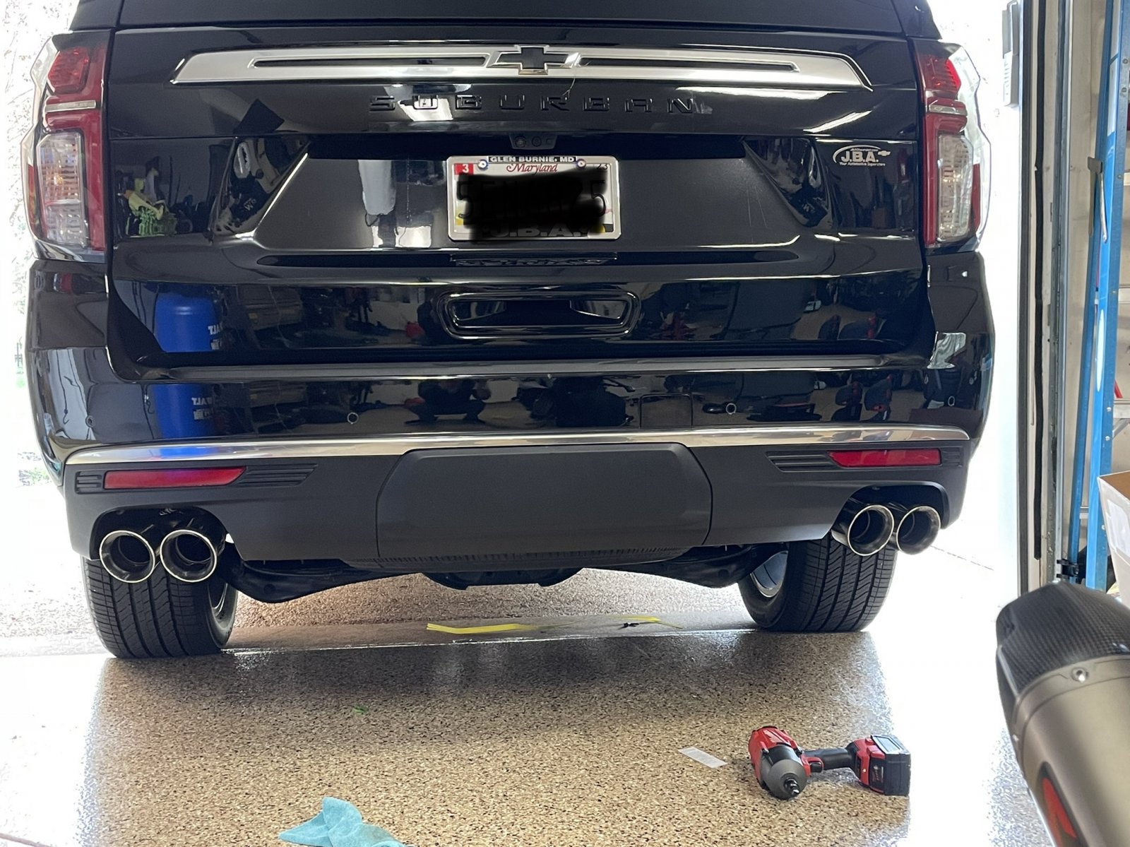

I did a muffler delete... sounds incredible!
Just for clarity, you completely removed the muffler? Did you leave either of the flapper valves in position and what about the resonators? Is this on a 5.3 or 6.2? Can you quantify "incredible"? I'm looking for more sound and horsepower but I've been down the drone at cruising speeds and that just gets old quickly.
Rockjr
Apr 21, 2021
8
I removed the whole muffler and left the flapper valves. I did not remove the resonators. It is a 6.2L. I will try to get a video posted on here of the sound. Very little drone at hwy speeds.
