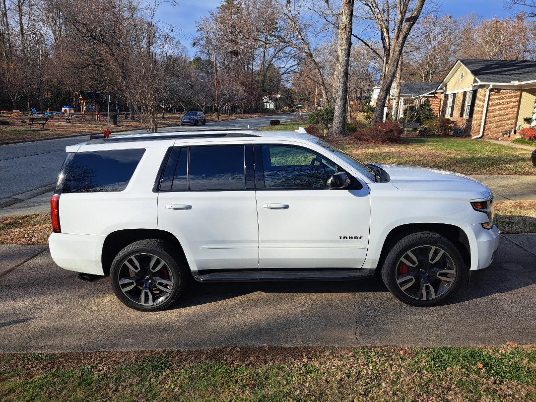

So this is a bit crazy I think I need to share. Havent seen anything like this on my short experience with these cars and the research Ive done.....
Last month I bought a 2019 RST 6.2 53k miles..... literally zero expected or existing powertrain issues and over the last 30 days started throwing parts at it....suspension, brakes, sways.... only power upgrades were Corsa CAI and Borla chevy exhaust...minor baby power stuff.
Well... CAI went in and p0101 started showing randomly. really annoying.... went back over and over the install and even smoke tested....nothing. code would show up randomly and i even saw once a po15b. id test every 50 miles and several key turns and literally half the time id see a pending dtc or it would throw.
I had ordered a range AFM delete randomly to put in anyway and the day i installed it i......
put a tank of 93 in at a sheetz
reinstalled the intake the 3rd time using sockets on the standard crud corsa clamps
AND..... i inserted the range AFM delete
then drove 50 miles....hard driving checking for codes about every 10 miles....nothing. no dtcs. no nothing
felt like a kingpin and bragged to my girl about how i may have finally installed the mfer properly. she had complimented me for being OG seeing my toolchest in the driveway and i didnt discourage the compliments on my manlihood
heres where it gets weird....
took her to dinner 3 miles away but forgot to insert the range....boom... pending p0101 code. i was heartbroken.
to make a long story short...i put it in after that and have since put on 200 miles with no less than 20 key cycles thru heavy full throttle 2 lane......hwy cruising.... stop and go city driving.... and guess what....no codes...no pending dtcs.....no freaking nothing.
its the v4 that kills these engines folks. had the car 30 days and im making a bigass build with mine. im gonna tune this out asap. but i dont care if you are bone stock or have a basic intake get that v4 crap off your vehicle. its a suicide module if a freaking basic well designed intake with a bit extra air makes the V4 transitions throw a fit
