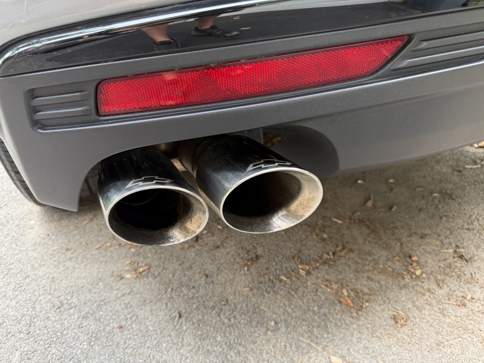

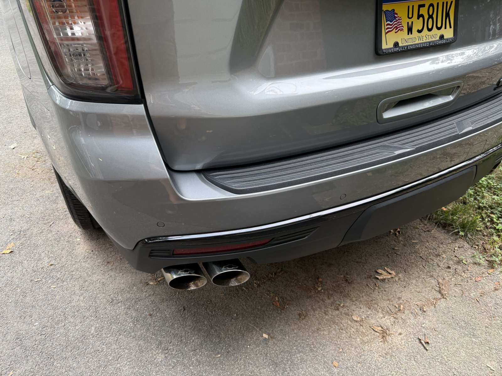

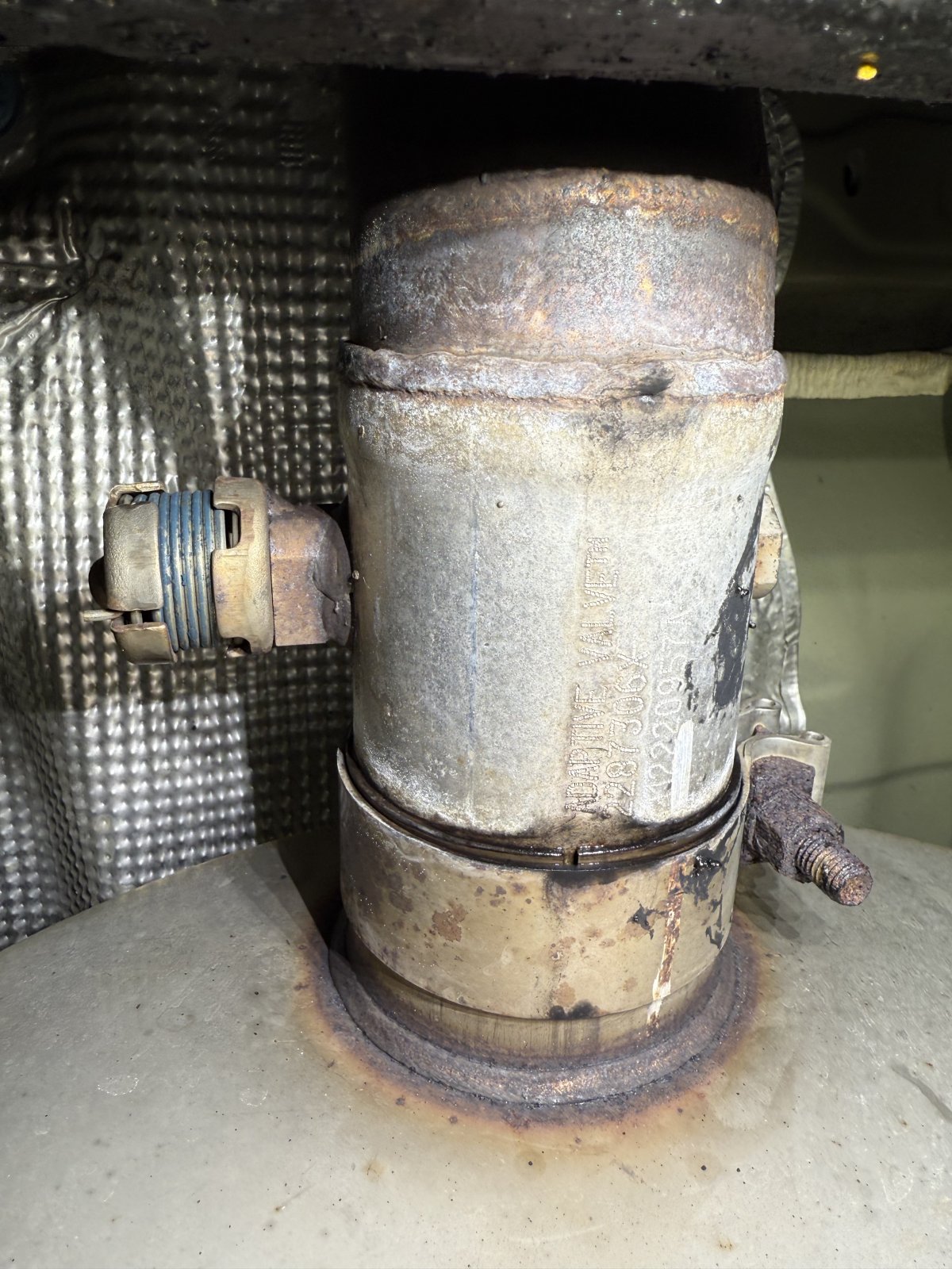

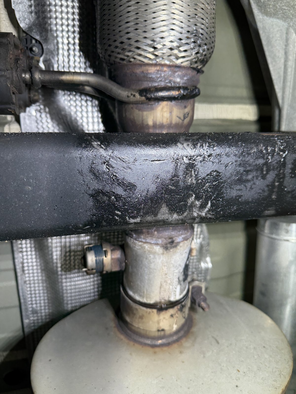

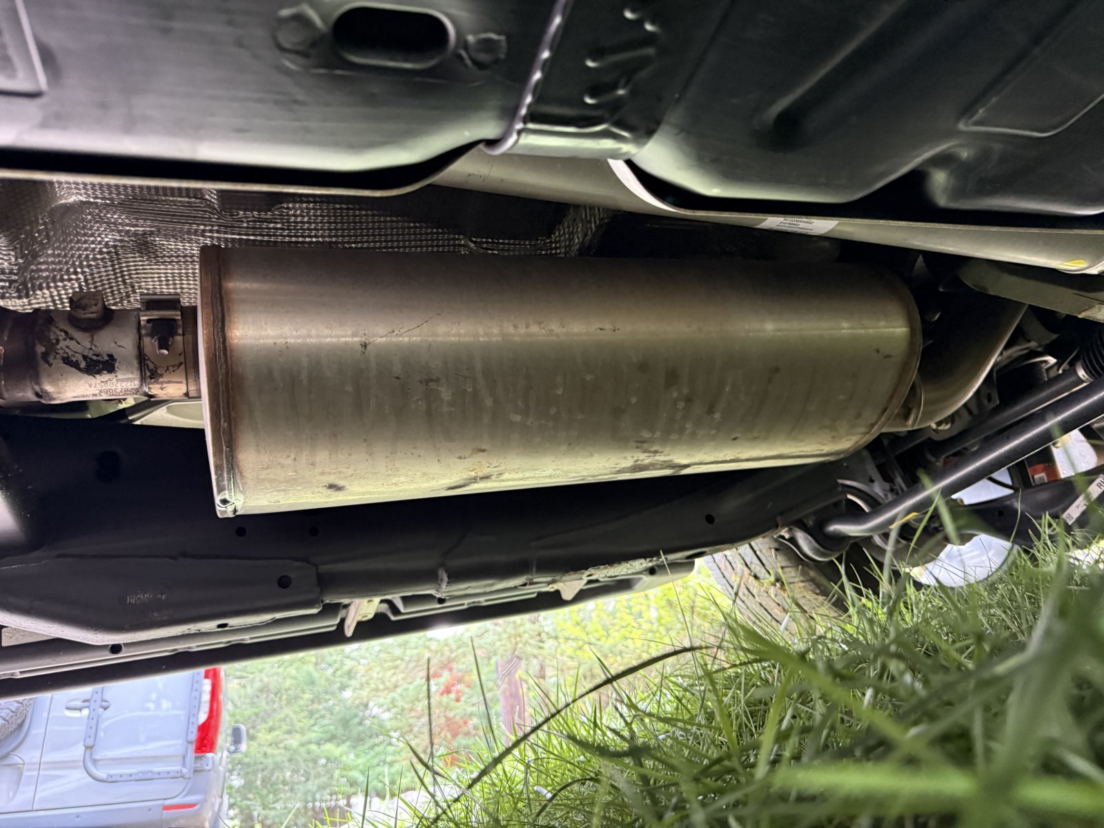

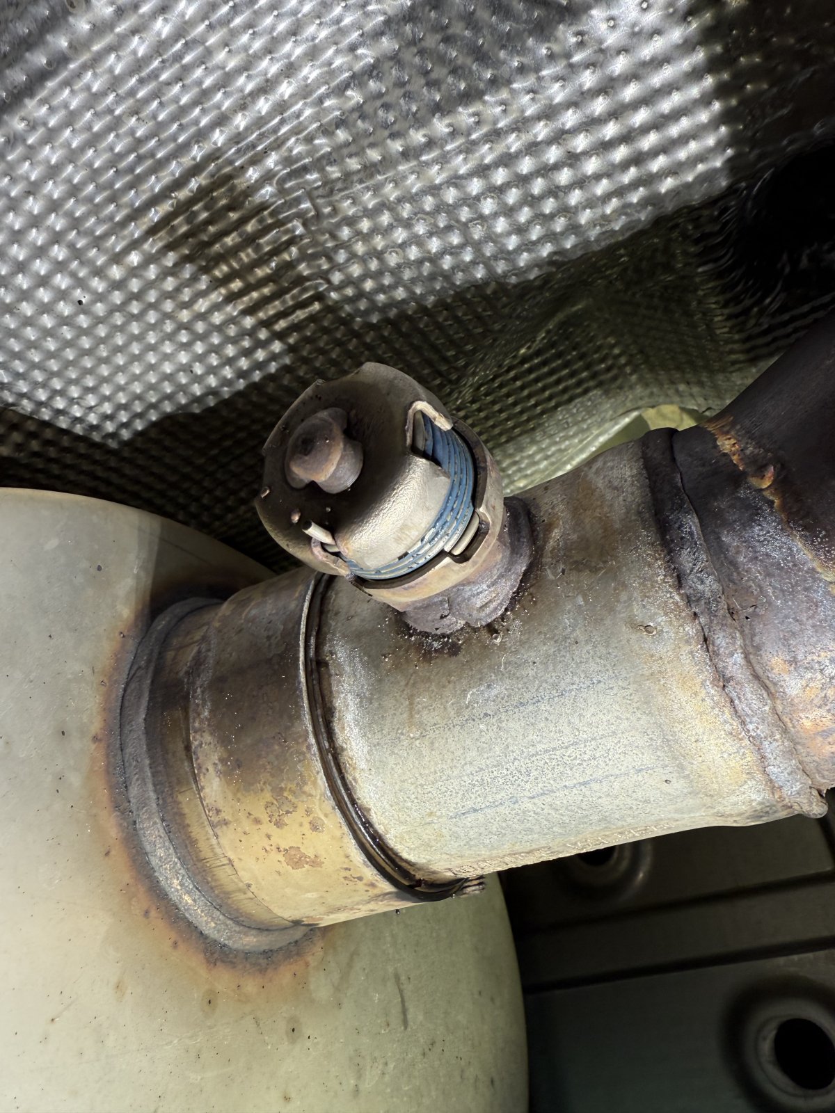

I have a 2023 6.2 RST performance package with cai, exhaust , big brakes, slick top (no roof rails) and I cannot figure out what exhaust I have or what this flapper does.

Can't tell you for sure what exhaust you have, but the flex coupler is standard on the V8's I have seen. The flapper in the muffler is to counter the awful sound when the DFM kicks in. Not sure if the performance exhaust have this like the standard exhaust. Never seen the bowties on the exhaust tips, this may be something more than a stock exhaust?
Hopefully someone can add to this and fully answer your question.

I have a 2023 6.2 RST performance package with cai, exhaust , big brakes, slick top (no roof rails) and I cannot figure out what exhaust I have or what this flapper does. View attachment 464320
Valve regulates the noise during DFM modes otherwise in some transient throttle positions you’d hear a faint chopping sound - akin to a helicopter in the distance.
