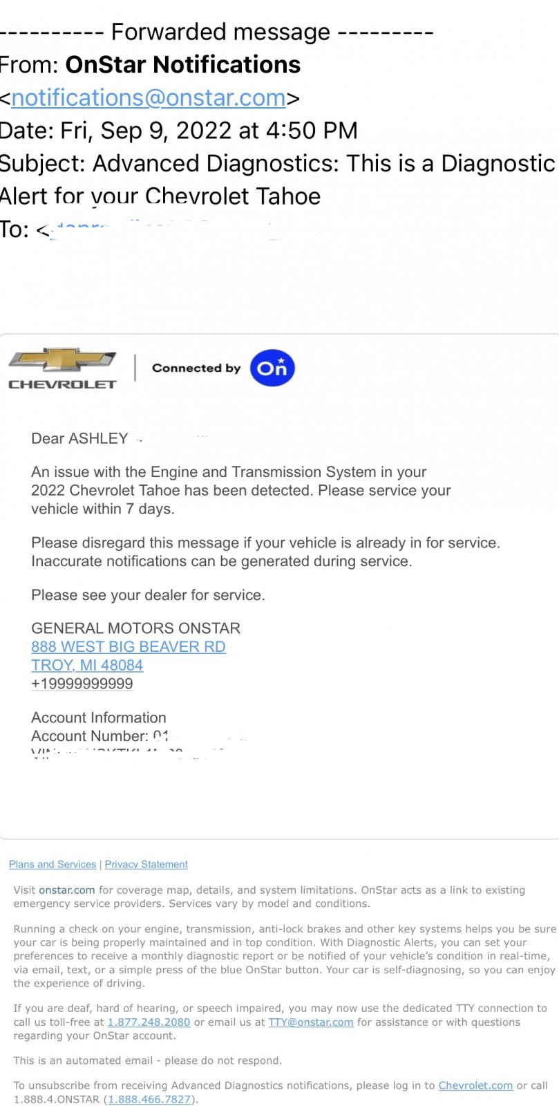

This happened to me the same Day I drove my vehicle home from the deal back in July. We told them it was a BCM issue and they brushed it off saying it wasn’t and that there was no issue with the vehicle. Fast forward to yesterd (9/9/22), parked at a Wendy’s drive thru with the car still on, paid for my stuff and shifted to D, and issue with the shifting system came up, and it automatically put the car in neutral. Couldn’t shift it back to Drive so I put it in park and turned the vehicle off To see if it would reset. Nope. Car does not start but all the dash lights come up And everything. So embarrassing to be stuck cutting off drive thru traffic. I then get an email from onstar stating there’s an engine transmission issue and to service the car in one day. Of course the tow truck doesn’t come until after the closest dealership is closed.
Was told today when I called the dealership for an update that they’re backed up and their engine technician (one one) doesn’t work Saturdays. Says ill
get a call Monday of when they can even look at it but it won’t be for at least another 4-5 days after that.
Also just wanted to say that prior to going to Wendy’s I had remote started the vehicle and It was fine. Im not sure if the auto stop had something to do with it plus being initially remote started.

Yes this is exactly what’s been happening. Just happened again. I’m so done with Chevy. This is the third time, the dealership told me they updated the bcm obvi not if it’s happened after the fact :(
