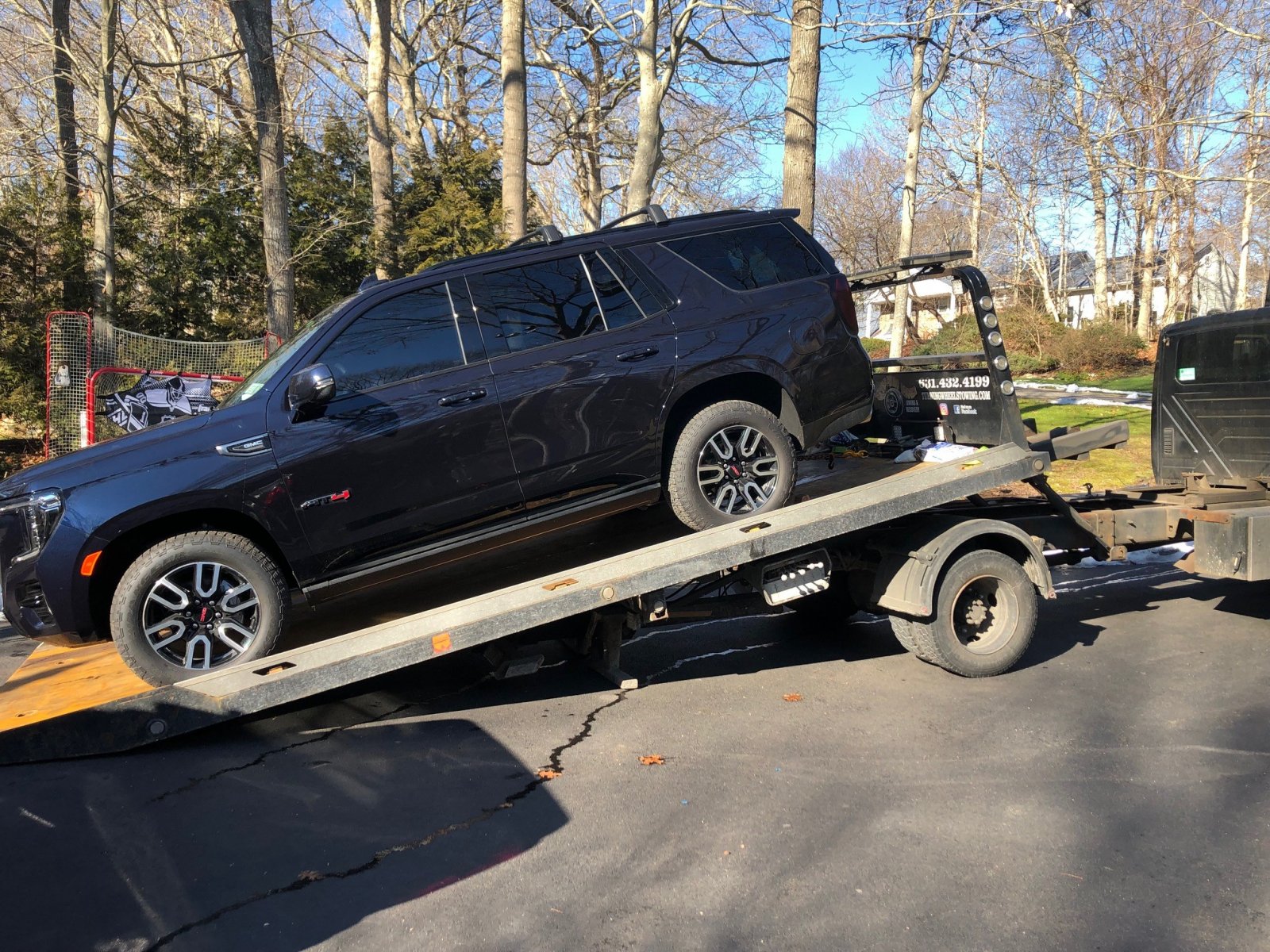

Ironically after I chimed in on the Consumer reports thread yesterday my '22 At4 6.2 wont start this morning. It seems to have full electrical power -- lights/radio all fine but nothing happens when pushing start. Anyone else run into this?
Waiting for the Onstar tow now -- push button trans controls won't let me select anything except park. Hoping they can tow it without screwing anything up.

Yes brake lights worked. Tried service mode as per the manual -- all the lights came on but it still wouldnt shift into neutral (or start). Tow guys dragged it onto the flatbed and now i await the dealer. At least it was in my driveway and not on a road trip somewhere!
