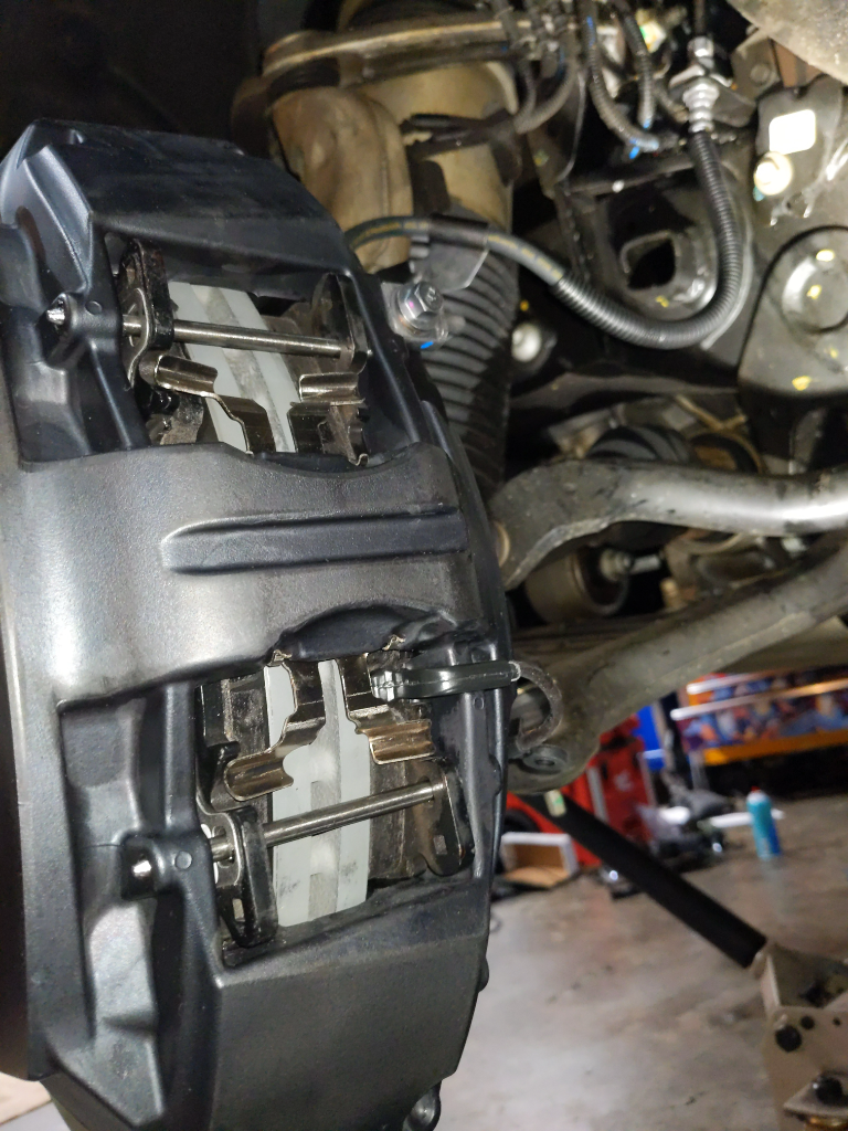

This thread is great for info, thanks all! In the last month I have swapped my 2011 Escalade, and 2024 Yukon.
Below is the list of what I used for my 2024 Yukon swap. The PPV j55 Tahoe has different brake hoses listed, I have confirmed those fit. Also as stated before, the rear wear sensor works for the front calipers.

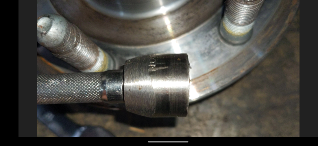

I ended up customizing a 18mm socket so I could remove the hub bolts without removing any ball joints, just need to tap the axle back a little.

Thanks for the list - helped me out a lot putting these on my 2023 Suburban.
4 things that weren't clear to me until I intalled them:
1 - If you replace with the J55 brake lines above, they come with banjo bolts and washers, so you don't need to buy extra.
2 - The Powerstop pads come with the pins and springs for the calipers, so you don't need to buy the separate springs and pins.
3 - Only 1 brake wear sensor is needed - it's on the driver's side only
4 - I read elsewhere that it's recommended to replace the axle nuts instead of reusing since they deform on installation, so I used new ones.
