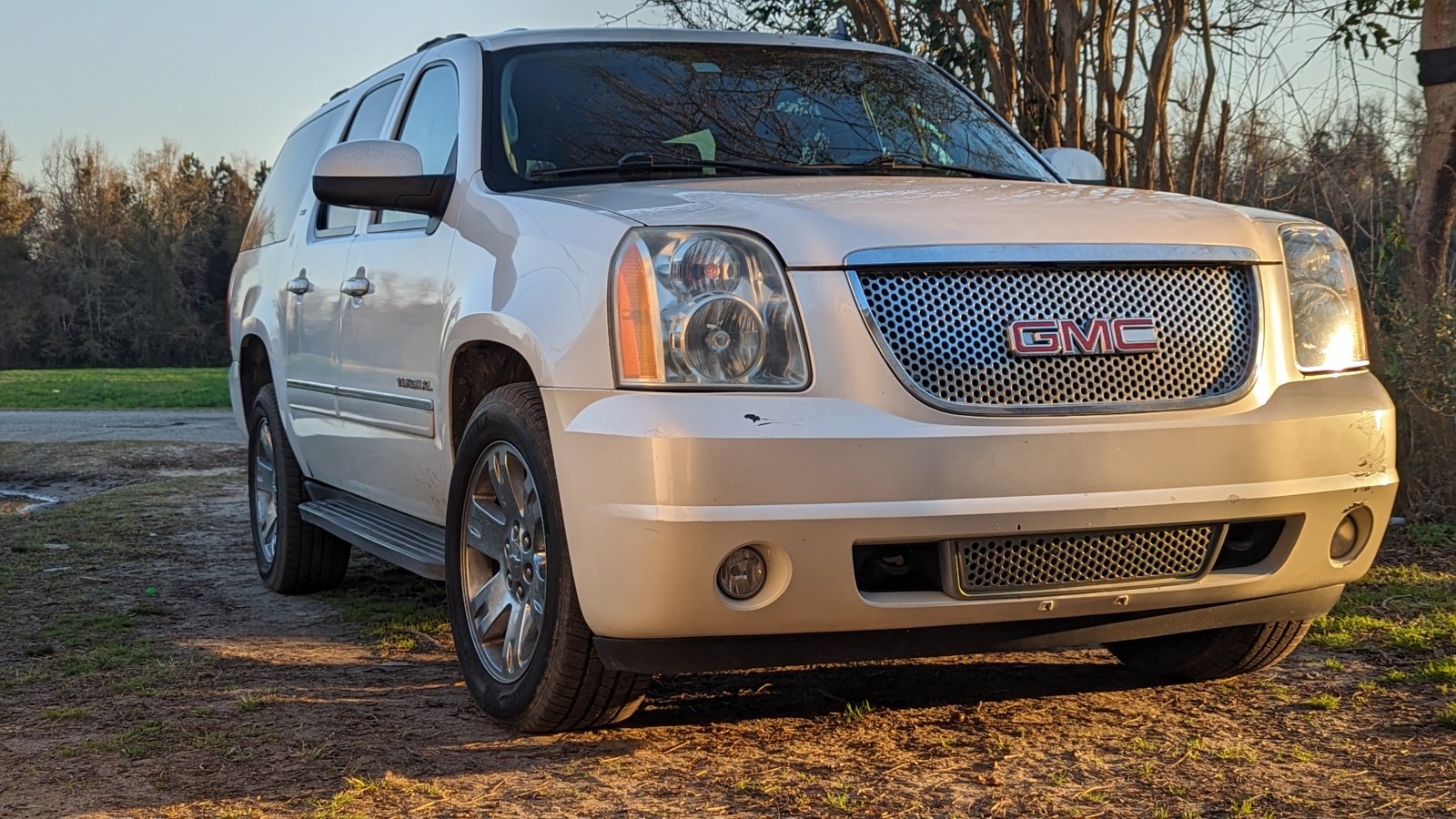

Let me start off with the fact that she runs perfectly. She's got the 5.3, no hiccups, no codes, no rough idle, live stream on the scanner shows no reds, etc. I have a generic scanner, but it's able to do almost everything a dealer scanner can do.
She's got 275k miles on her and she purrs like a kitten with all the get up and go of a good beastie :)
THAT BEING SAID
After our 2500 mile cross country trip hauling 7 people, all their crap and a 4klb trailer (all out we weighed just over 11k lbs, yes I know, well over her limit, but we didn't have much of a choice, so we took it easy and kept a close watch on her and her fluids, etc.) she has started going through about a qt of 5w30 full synthetic every month, and about a gallon of coolant over 3 months. Oil looks good, she could use an oil change, but there are no particulates, and it's not milky at all. Using dexos coolant, no leaks of any kind, anywhere in or under the rig. No oil buildup of any kind anywhere in the bay or under the rig, and trust me, I'm skinny, I've crawled all over her and checked. The other thing she's started to do is rev up and down at stop lights. Nothing extreme, she goes back and forth from 600-1200, but that's only at an idle, doesn't matter if I'm in drive or neutral.
SO, my question is this: Should I be concerned about the disappearing fluids, or is this simply the symptom of an a high mileage motor? Normally I wouldn't be concerned about the oil consumption in an older rig, but the addition of the disappearing coolant has me wondering. I've driven and kept up on high mileage vehicles all my life, and the coolant thing is a new one on me with no apparent leaks. I don't have access to a pressure tester, so unfortunately I can't help there.
Any help, advice or experience is greatly appreciated :)
