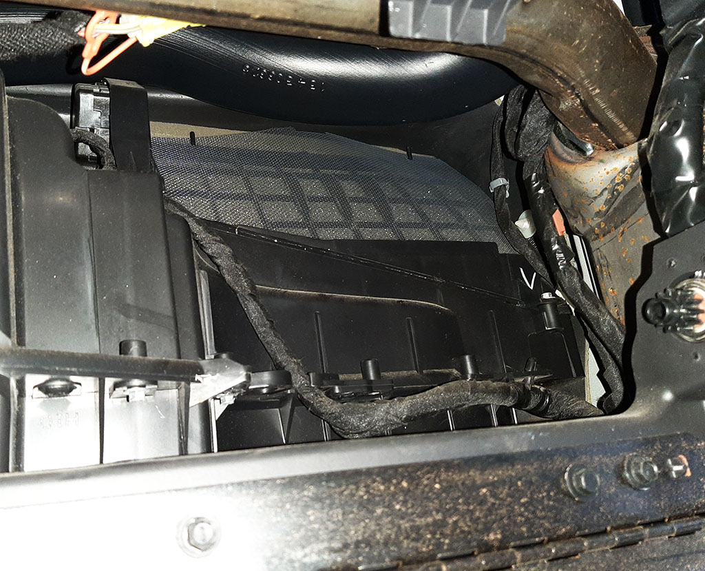

OK Here's what I see .. upper right with glove box dropped down.
So maybe that's a filter for when running Recirculate Air???
The screen is hung on two little slanted pegs.

That’s not the cabin air filter, thats where it draws the interior air when you’re in recirculate mode, just like the screen it has on the exterior cowl area where it pulls the outside air from. It’s just a screen, and the air from both locations goes through the cabin air filter either before or after it gets heated/cooled and then goes through the ducting and out through the interior vents.

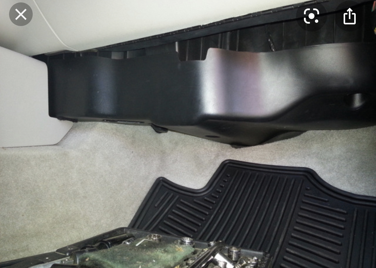

Just found this post and I am grateful to everyone. I have a 2011 Tahoe LT and I'm going to start this adventure this weekend, I understand that I have to drop that big black case that's pointing to the floor to get to the access door and if by some miracle there's a screw there that means somebody already did it. I don't have any smells or anything like that just thinking from the maintenance aspect. Now I'm finding out they didn't come that way from the dealer you had to have it done. So I'm wondering if it's actually necessary after all these years I'm not really worried about pollen or whatever and there are no weird smells coming out of the vent. But I am curious that I have discovered there is a maintenance you can do to spray a cleaner up the tube where the water drips from the evaporator has anyone tried that or is that also a waste of time I clearly have water or condensation on the ground when I run AC so it's not clogged. Thanks again for your time

when I got mine the mod was done but no filter was installed. I went ahead and put one in even thou it at over 130k on it when I got it. figured it can't hurt. it does flow a little bit less vent air. if you're in a super. hot climate, that might matter to you.
if the evap goes out on these, the dash has to be removed to change it. so stuck a filter in just in hopes it helps a bit.
