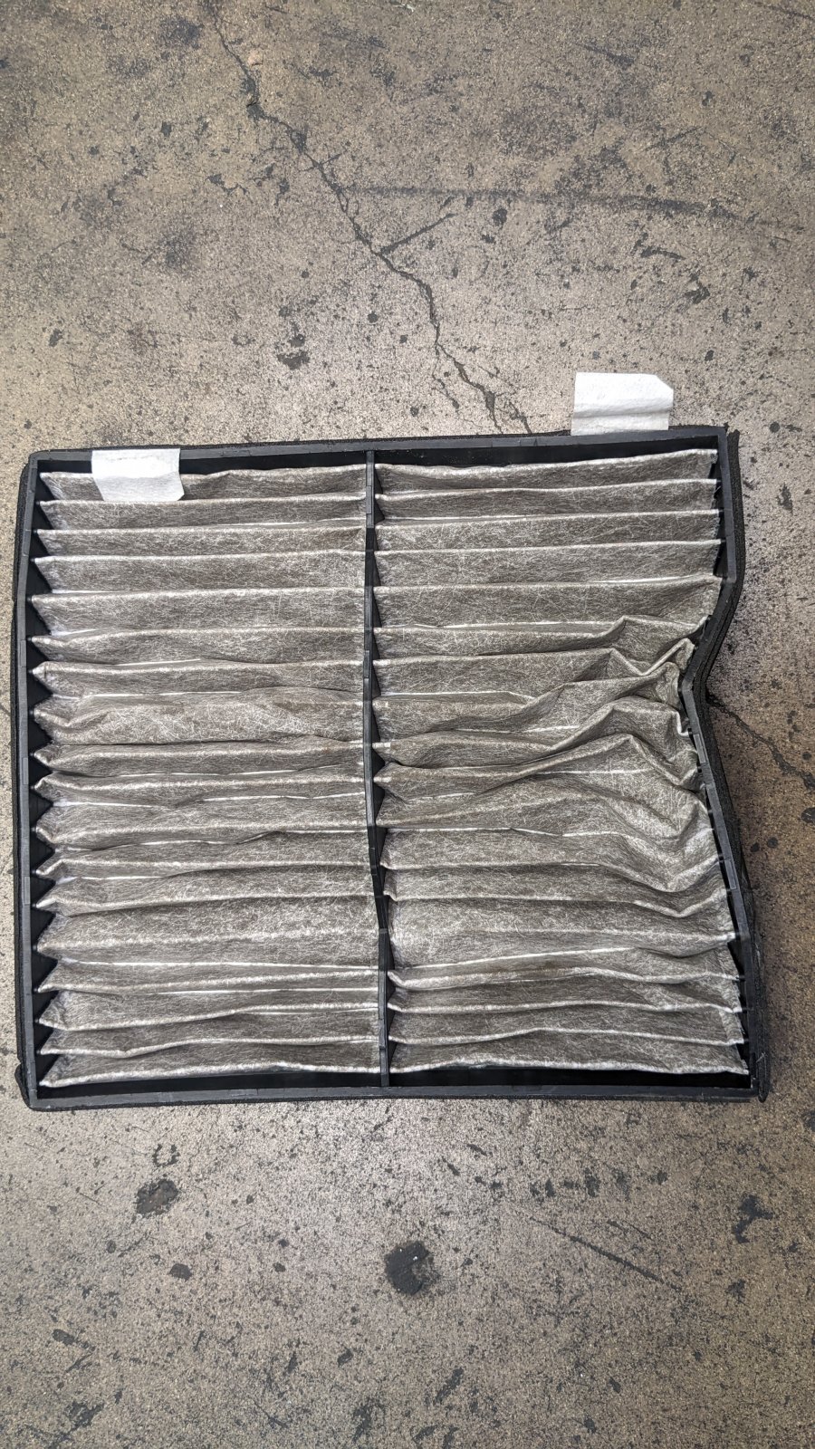

mine looked like someone did the mod with a butter knife and when they jammed the filter it, it just folded up and didnt filter much. I'm guessing a dealer tech. they specialize in fast not good. or they don't make any money.
watch out to don't do this to it when you install it.

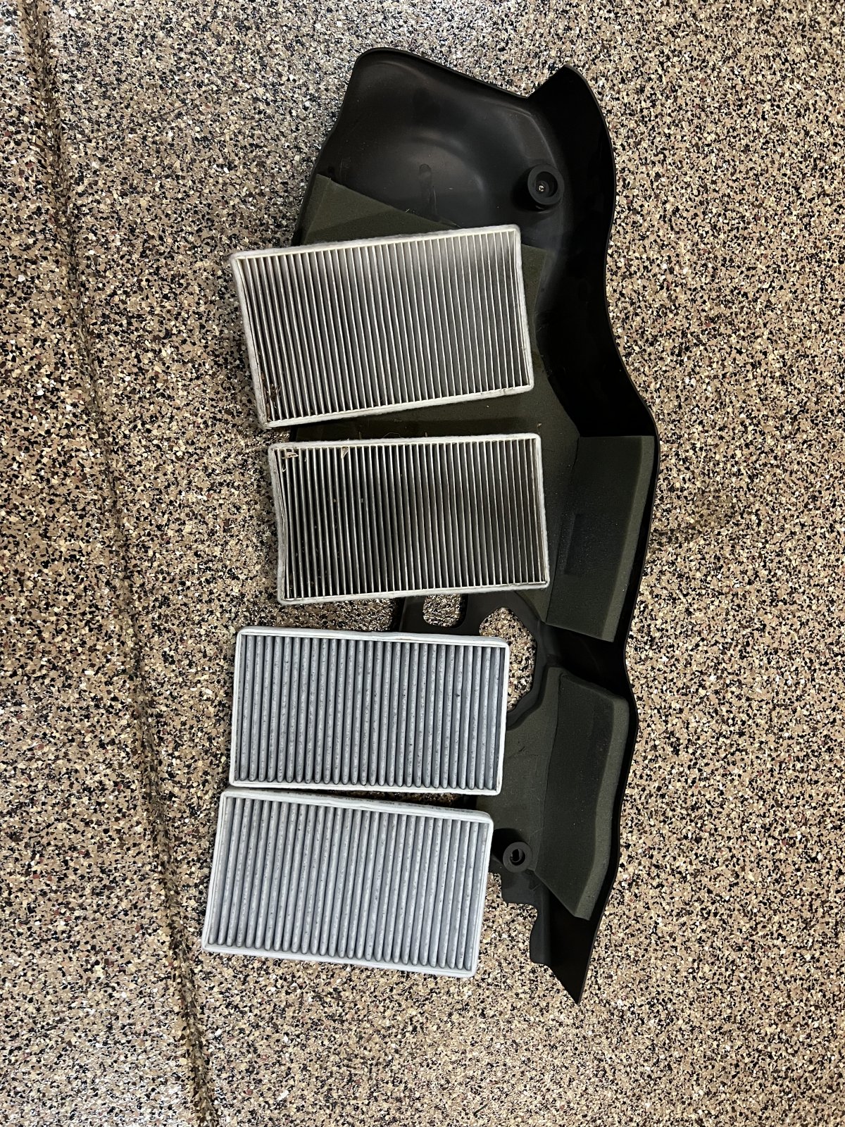

You will need to remove the black kick panel, 4X 7mm hex head screws. The fourth screw, on the left (nearest driver‘s side) is easiest accessed from driver’s side. It may already be removed since it’s common for service installers to skip this fourth screw when reinstalling. I used Fram filters last time. It takes two filters and they are normally sold two per package. I’m the photo below you can see two of the four screw locations, driver’s side is lower in the photo.

Just viewed @j91z28d1 download attachment after figuring out how to download it on a phone. That nailed it. Thanks for the socket size. You’ll need the extend length socket and a wobble attachment.
2 filters?
those look nothing like mine. mine uses one filter that is designed to fold on its way in for clearance

Both filter types are correct (I have used both). Because of the firewall sloping toward the rear as it meets the floor pan, there isn't enough room to slide the filter straight in. GM deals with this by cutting notches in the sides so the filter can fold and then straighten out once it is about half way inserted. Some after market use two filter elements side by side, you insert one and push it toward the front and insert the second one to fill the remaining space.

huh. I guess as long as it seals.
the aftermarket wix has 2 part numbers and both are singles with the notches
