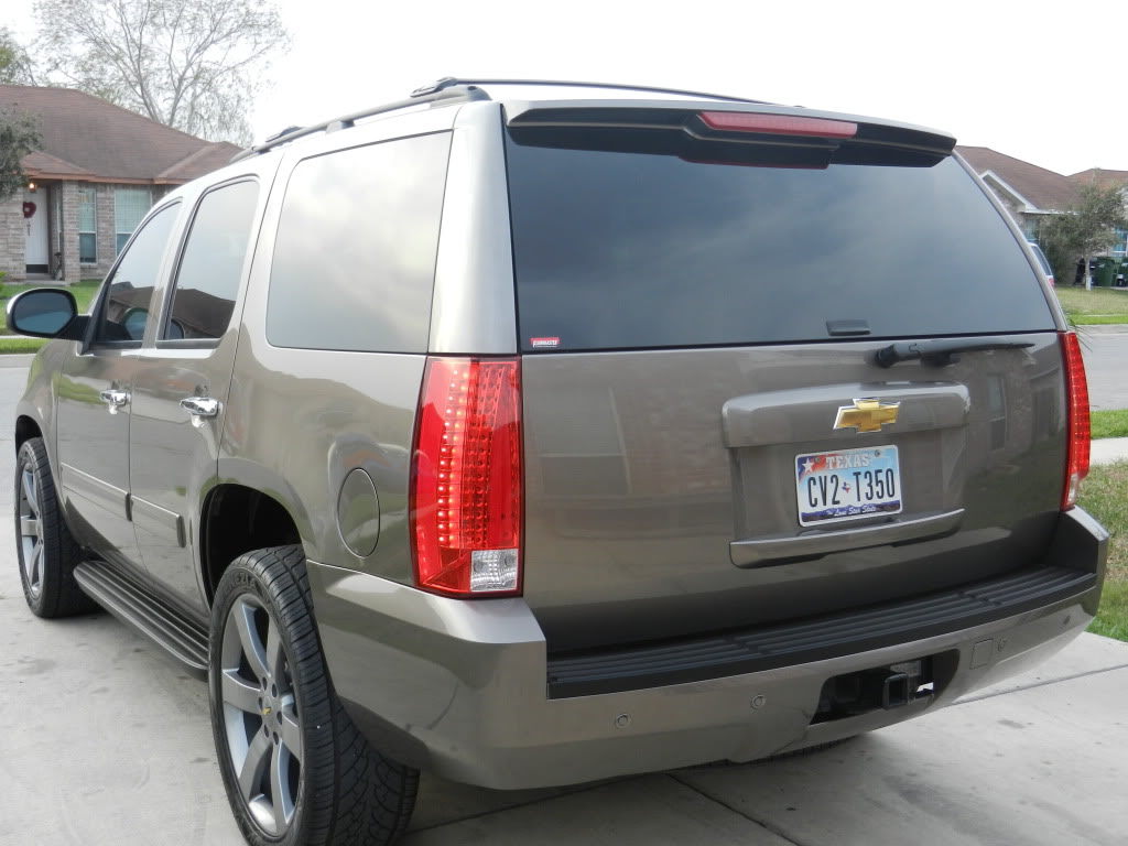

UPDATE:
Okay, so I pulled both lights. Swapped the grey resistor boxes. Left side light STILL hyperflashes.
Then I swapped the boxes back to the way they were, but this time swapped the lights themselves. No Hyperflashing on the light.
Unit itself is indeed defective, nothing to do with the resistors.
Looks like I got Serge's old set he returned the second time.
Here is a picture of them for the 18 hours they were on there.
Right now truck is back to stock, and a claim is filed.
