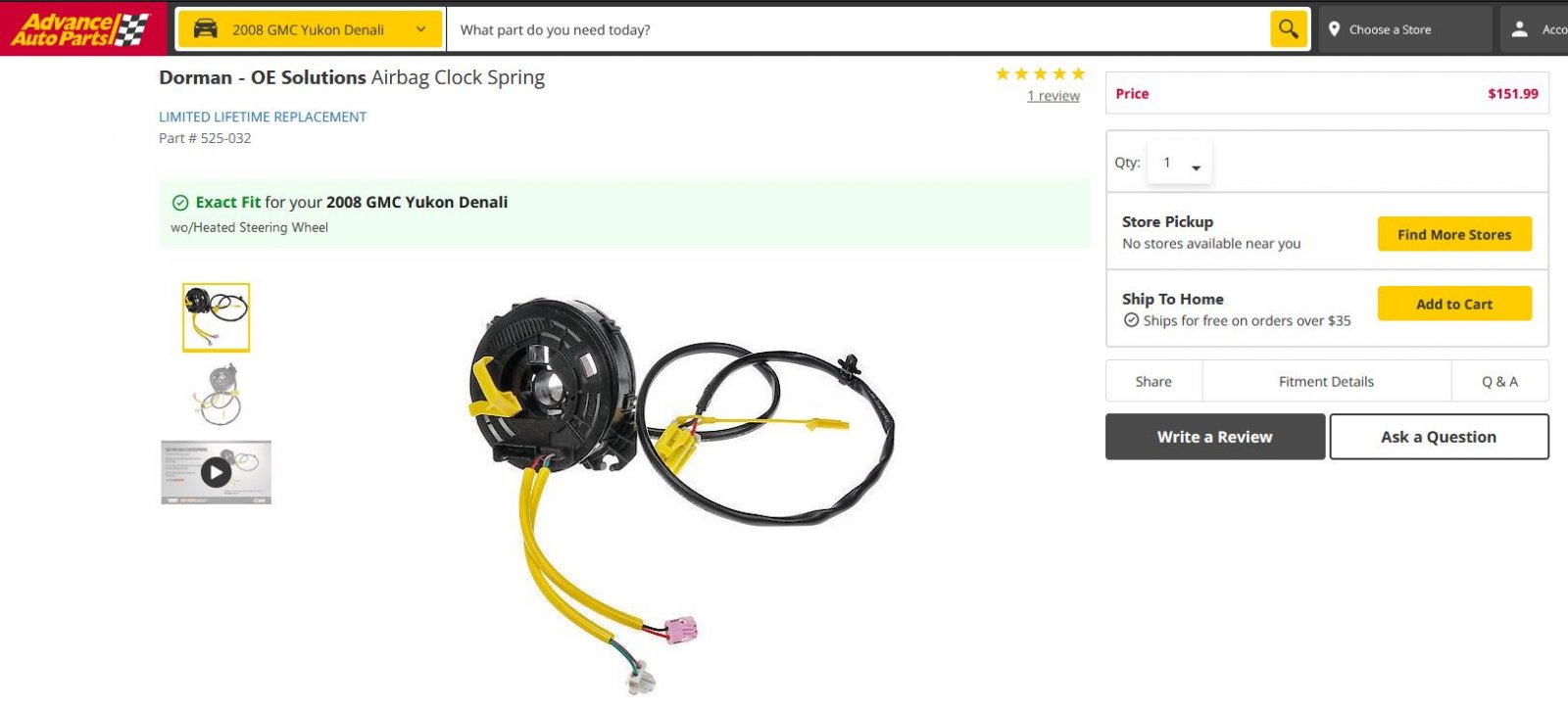

Does this one look like it's the same as your old one? Not sayin' Dorman is the way to go, but...

That one appears to be for an unheated steering wheel? Yup, I looked at the dorman site. PT# 525-032. Says wo/Heated Steering Wheel! Thanks for looking. The connectors to the steering wheel appear correct for MY steering wheel!
