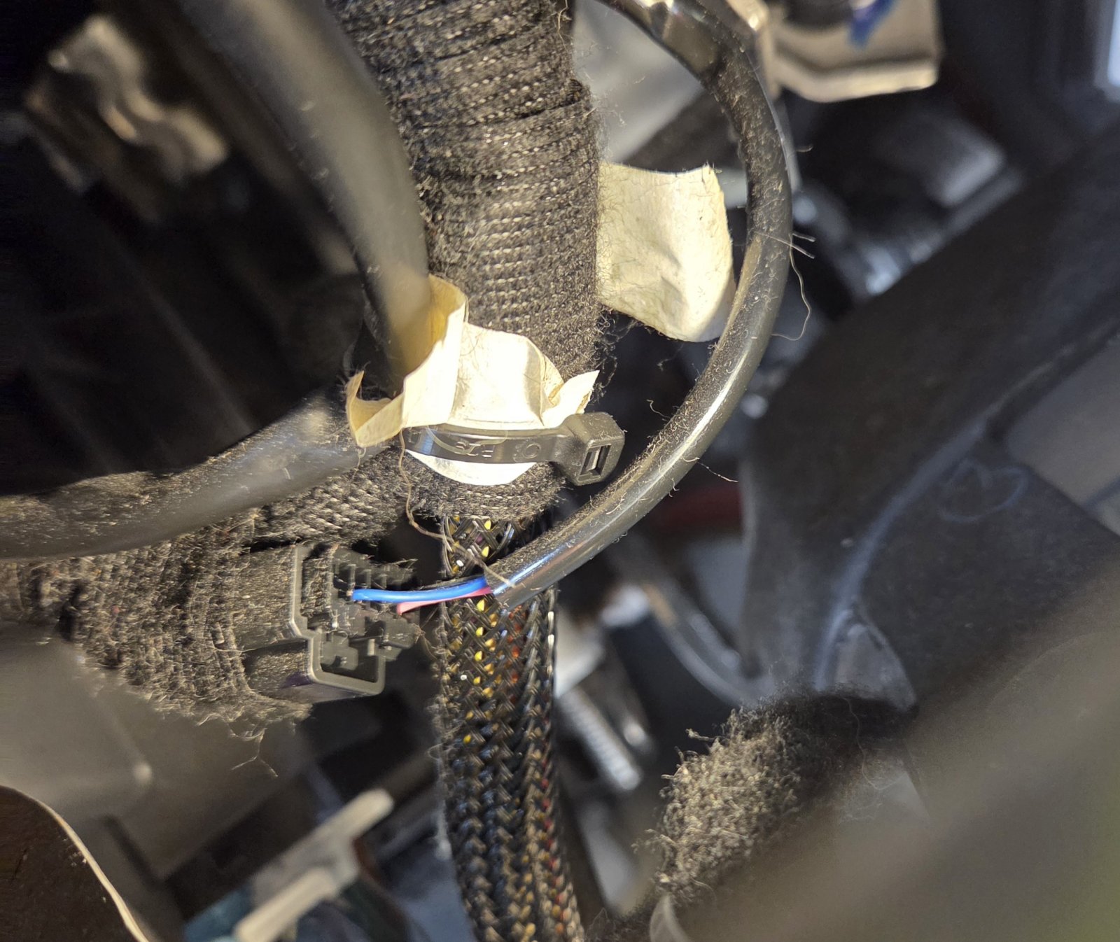

I dropped the lower driver side valance below the steering wheel today and found where I believe the heated steering wheel clock spring would plug into the harness. Low and behold it has something plugged in.
So is my current clock spring already plug and play ready for just a steering wheel swap to gain the heated steering wheel option?

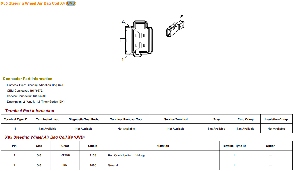

That's likely not it. Those look like blue and pink wires in a 4 or 5 position connector. GM typically uses a violet/white and black wire in a 2 position connector like the below.

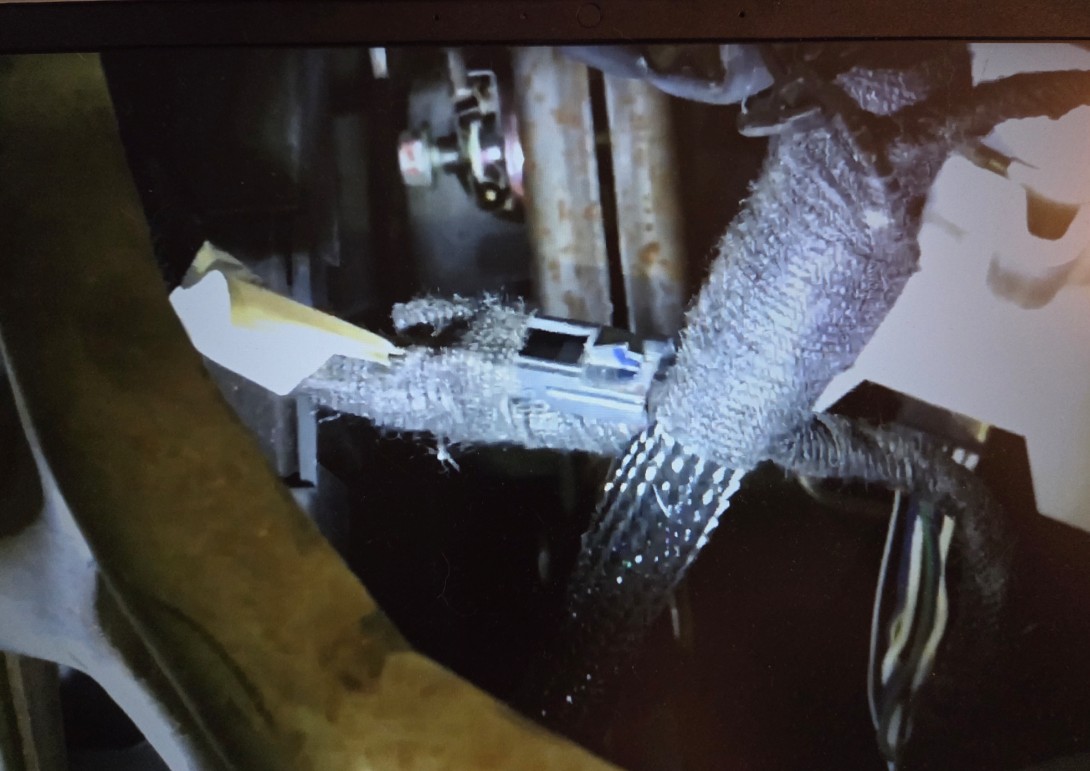

This is a file photo of the heated wheel receptacle. So is the plug shared with another circuit besides the heated wheel?

It is not. The heated wheel uses its own 2 pin plug.
