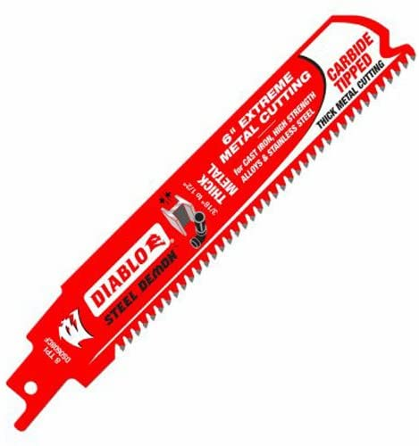

Sleeping on it I'm not in a time crunch and maybe could use this as an excuse to buy more tools rather than pay labor hours.
Is this a dumb idea to get? ;) (or something like it) I have a fire extinguisher and hose in the garage. lol

Good to know. Thanks for the ideas!
You probably want to get a couple of them as you will only be cutting with the very tip of that blade due to clearance issues... it's not like you can get full use of the blade in this situation... but you can keep the blades for later use.
