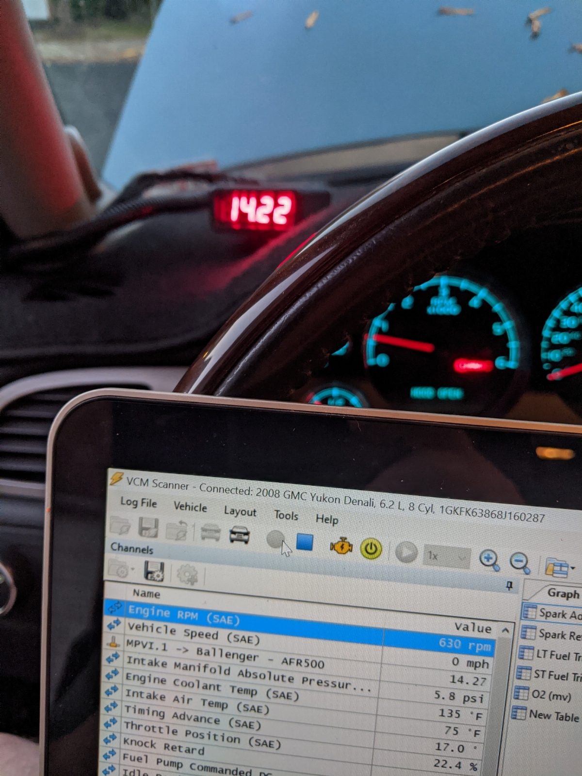

I need to get my afrs in check and learn to tune em myself before I get stupid with a supercharger.
I sat on that harness and sensor too long!

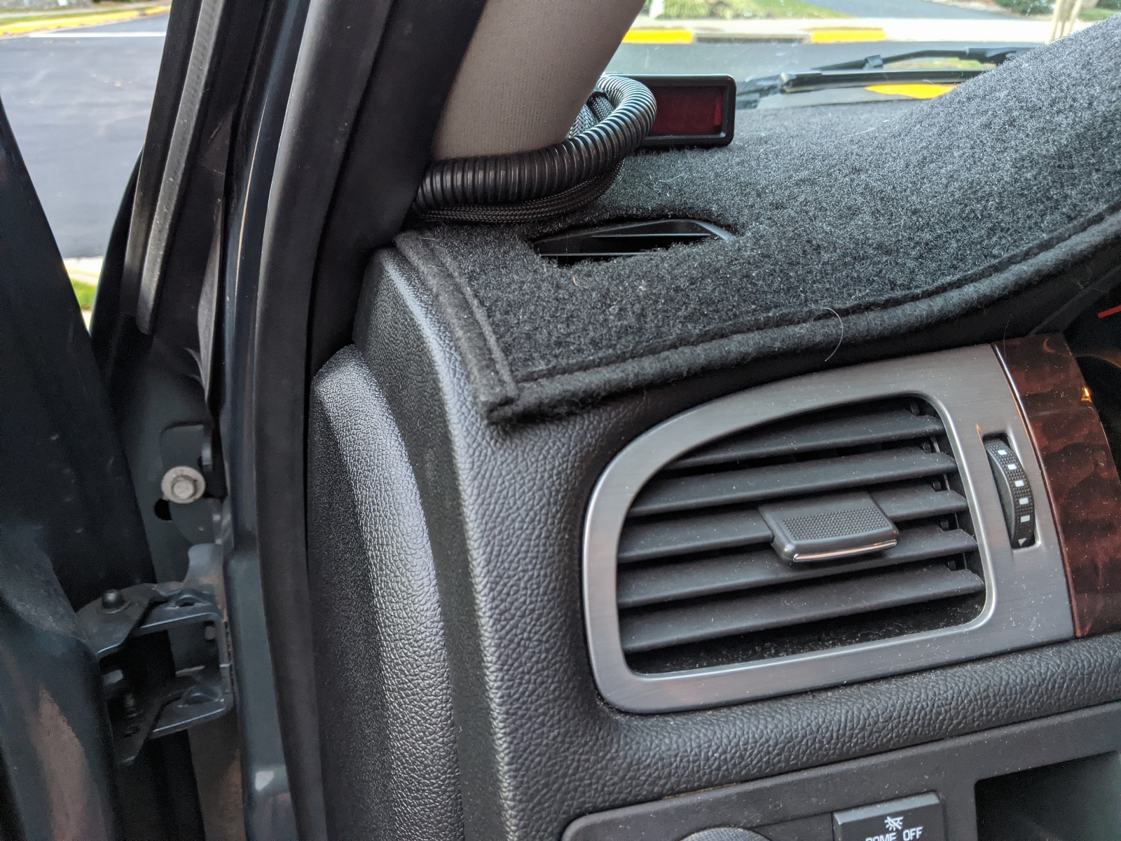

Sensor installed and laptop setup. I installed post high flow cat. The readings should not be that too far off. It's much easier to pull a down stream sensor and disable any codes while then running a wideband in its place.
