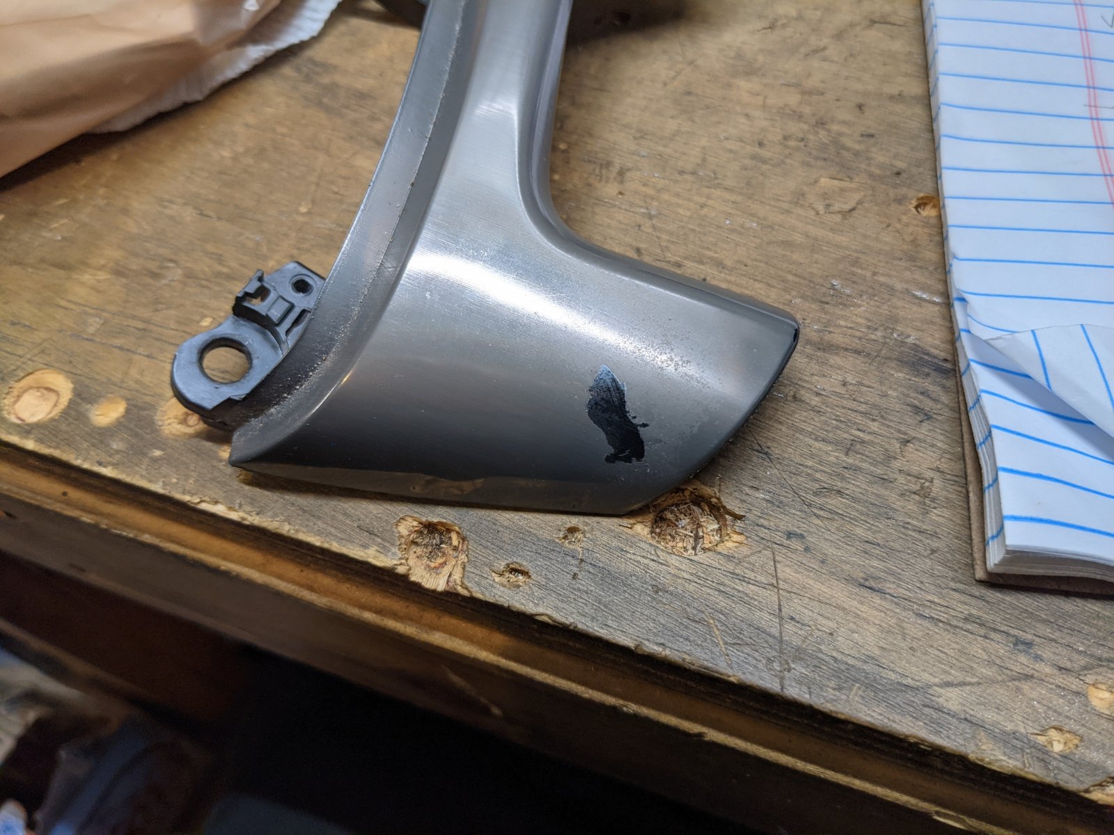

More mundane interior stuff. Steering wheel had chipped and peeling parts on the chrome sections.
I got a dorman replacement part. Color and chrome match isn't perfect but once installed still looks very nice.

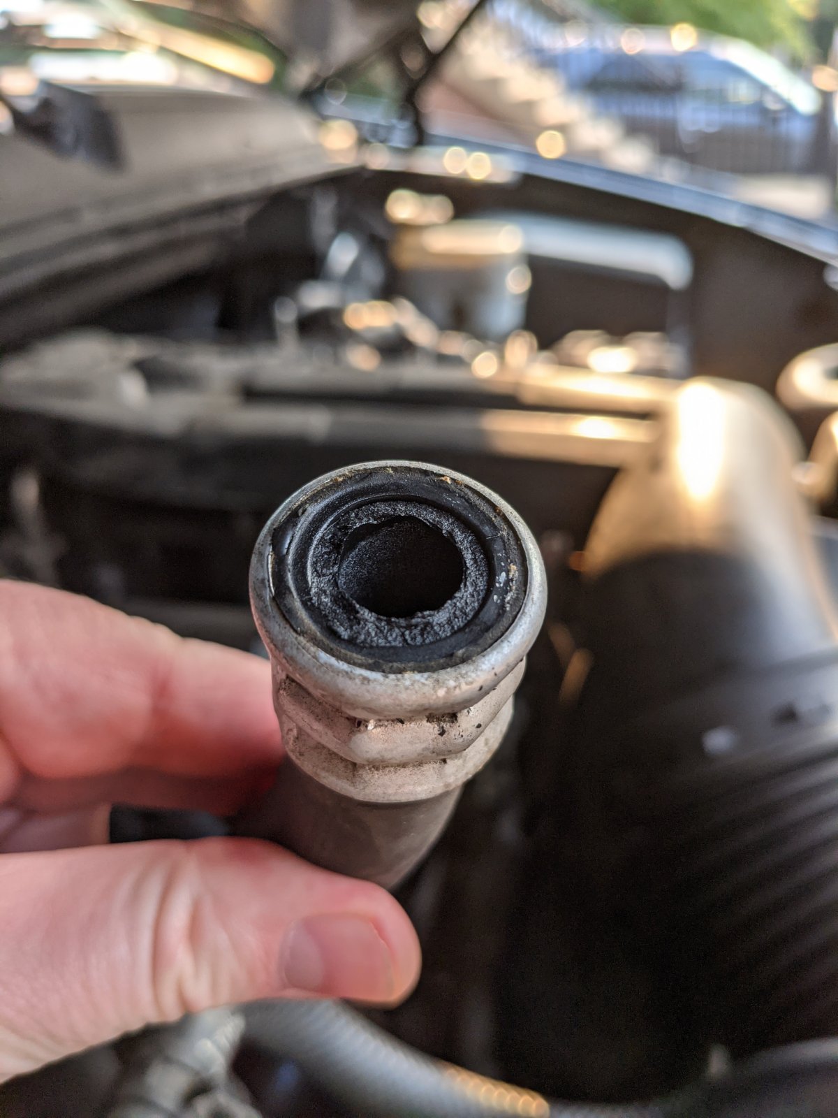

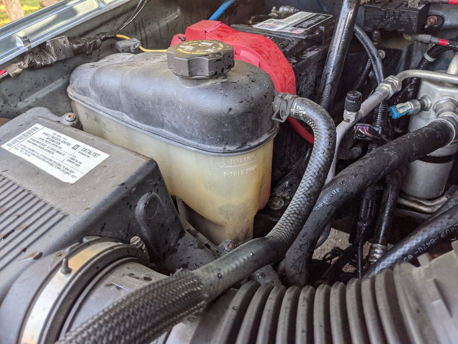

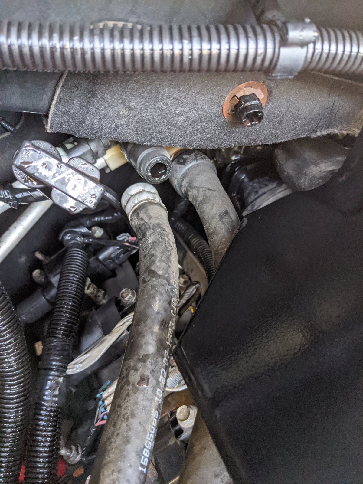

Hey neat. Line to my heater core snapped off. Luckily I was 1 block from home. **** was steaming and boiling out everywhere. I hope the block and heads are ok. Probably are.
Parts on order.
