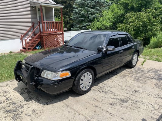

The end of June I ended up picking up a 2008 Ford Crown Victoria P71 SAP and sold the 05 I had. The 08 had 112,421 and 820 idle hours it was an old CSP administration car and being it was a CSP car it came with the fire suppression setup, overall it is pretty clean and they left behind a lot of hidden goodies. I’ll update this over the next few days, first thing I did was swap the wheels and other odds and ends from the 05.

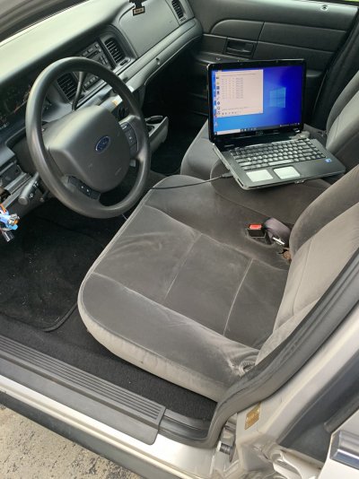

These cars came from the factory with TPMS sensors in the wheels and when I swapped mine off the 05 I didn’t have the sensors cause 05 didn’t have that I wanna say it started in 06 so I downloaded FORScan which allows you to turn off the TPMS light, dark mode, and set up keyless entry and you can read codes with it too.

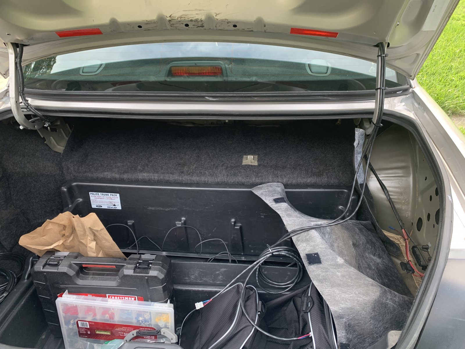

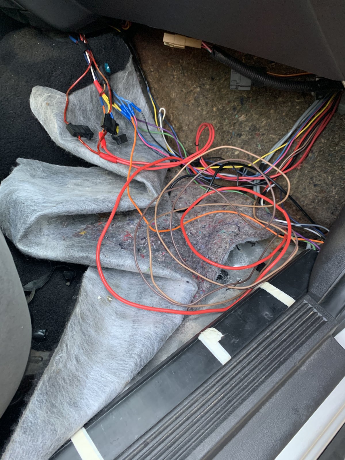

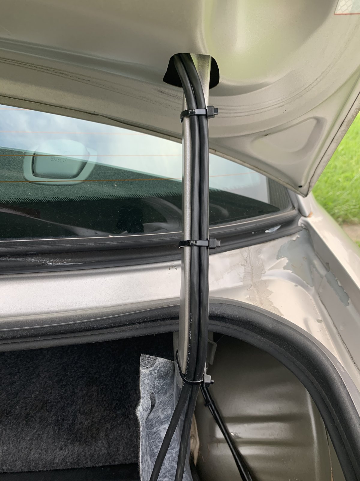

In one of my earlier posts i mentioned the car still had a lot of hidden goodies well when they decommissioned it they left a lot in it, grille lights, strobes in the reverse lights and front turn signals, siren, they basically just cut everything behind the rear seat along the door under the carpet. I’ve always wanted a Vic with lights for off-road use so I picked up what I needed to get it all hooked up, the strobe wiring, strobe power supply and two strobes to install in either tail light. Started running the wiring for the reverse strobes here and zip tied it for a nice clean look.

I see you also have that rear equipment pack/insert. I've heard those are hard to come by. Supposed to be made with kevlar.
That was Ford’s first way of dealing with the fiery rear end collisions before the fire suppression option, the fire suppression was I wanna say a $2500 option which might have been too much for some departments, the Kevlar is on the back side so if there were sharp items there it wouldn’t puncture the gas tank which is right behind there. I wouldn’t call them rare there out there some people think there worth more then they are the hard thing to find is they made these plexiglass covers those are kinda hard to find a complete set. The trunk pack came out of the 05 I don’t really put much in it but it’s nice to have and makes the trunk area cleaner.
