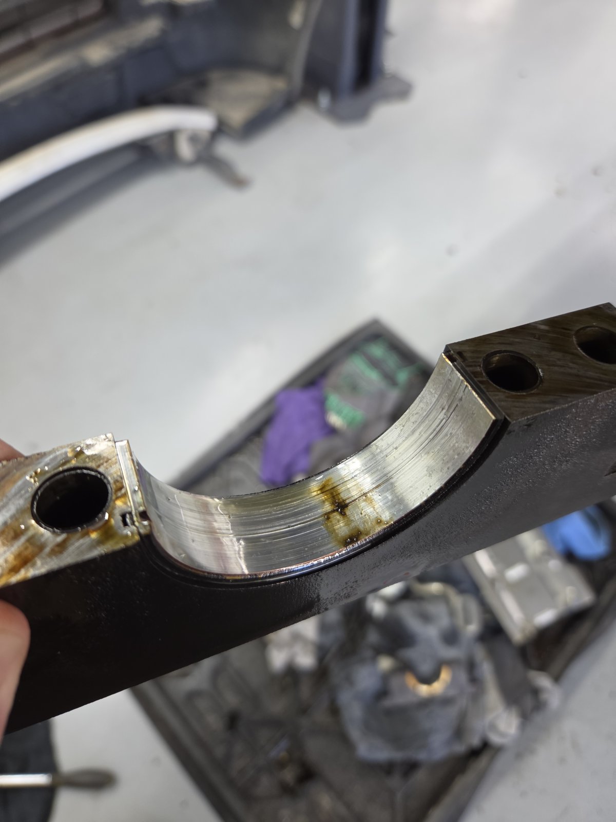

I bought a dead 09 Tahoe hybrid a couple years ago for a song, vehicle wouldn't start but was in nice shape otherwise. Had been to the dealership and they couldn't figure it out. I hooked my tech 2 up and found that the GMDCM was not communicating. I assumed the GMDCM was shot and bought a used one like you did from same year / make / model. After swapping the replacement in, I was able to communicate with it but it tossed a bunch of battery related codes and wouldn't start. I used techline connect and a drewtech mongoose GM2 to try a security relearn but it failed. I re-flashed the GMDC with the correct programming and it appeared to be successful but the same issues persisted and a 2nd security re-learn attempt failed as well.
I swapped the original unit back in and thought it looked oddly new so on a lark I tried flashing too. To my surprise, it took the programming and I was able to succesfully perform a security re-learn then the vehicle started. I suspect that the original GMDCM died and the dealership replaced it but didn't flash it for some reason. I think that they get VIN locked and cannot be re-flashed and security re-learned to use them in a different vehicle. You may need to track down a brand new GMDCM or find someone who can clear the VIN data out of your used one and prep it to take new programming and a new VIN.
After getting the GMDCM working I then found that the power steering was not and after some diag I found the PIM was not putting out 42V for the PSCM so I swapped the used PIM from the GMDCM I'd bought used onto it, flashed it and then the power steering worked as well. Putting two and two together, I assume that the PIM died and took the original GMDCM out with it. The HPCM was then fault free and worked properly.

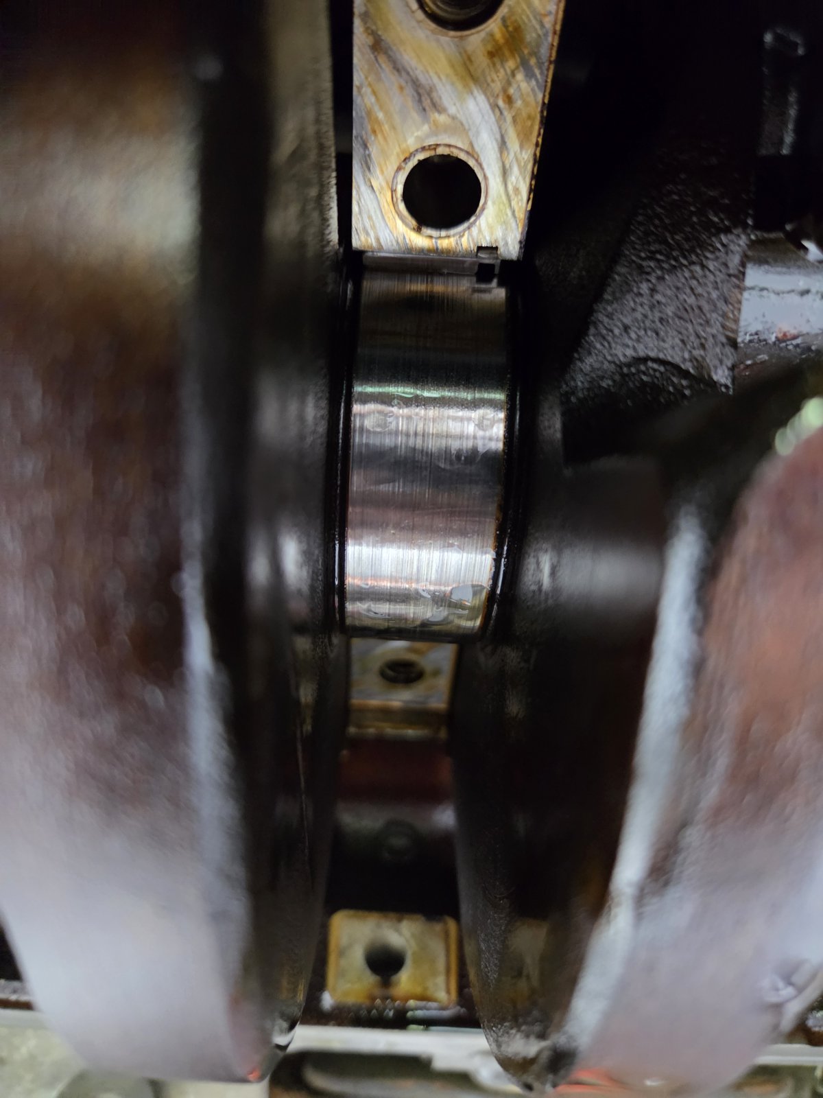

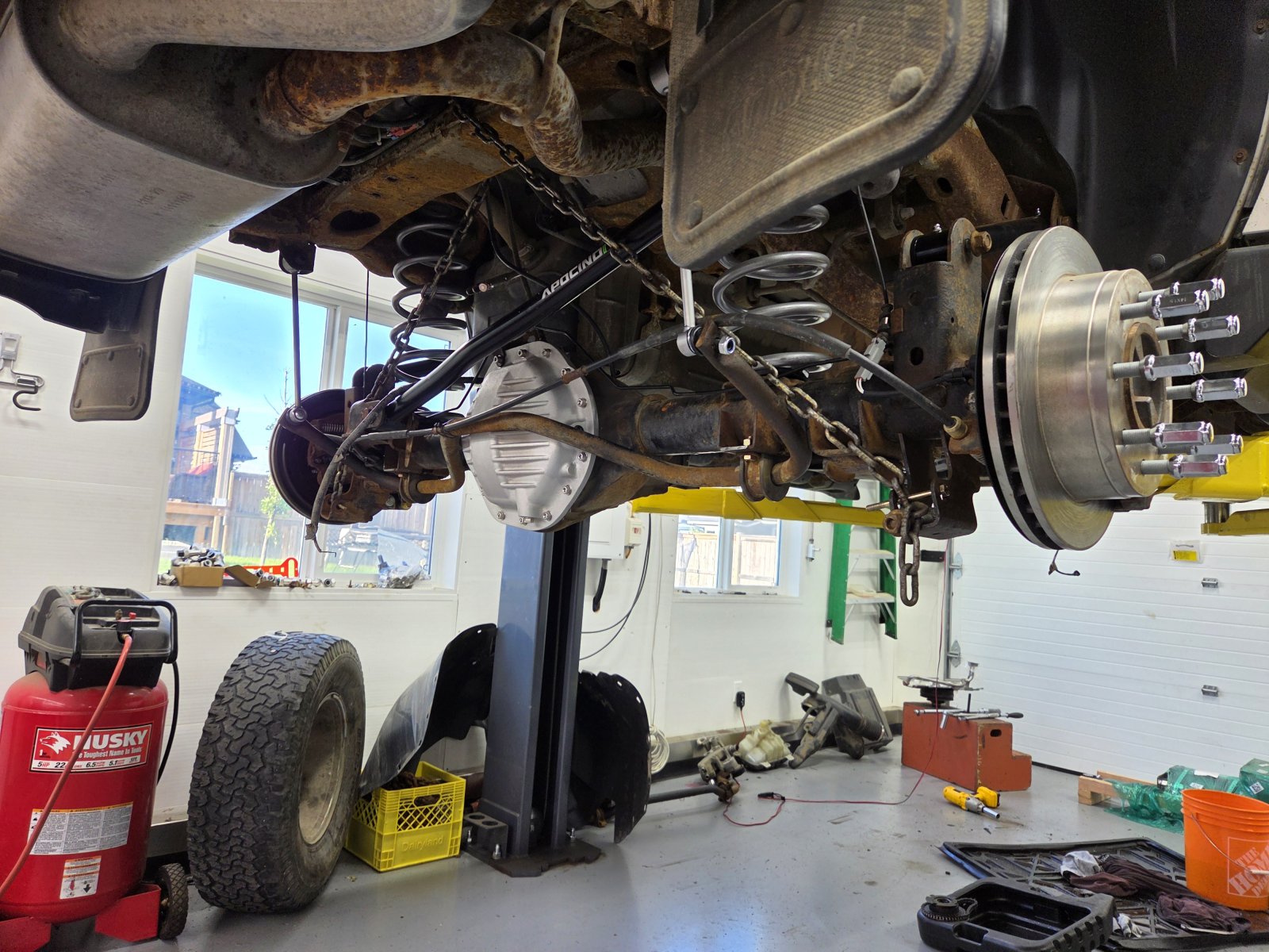

Unfortunately, the engine always had a bit of a miss and clattered quite a lot and it had a bad engine oil leak off the back of the oil pan dribbing off the aux transmission oil pump so I never drove it. I recently decided to do a solid axle swap on it to use it as an offroader (becuase why not?). I swapped the rear diff out with one from an H2 and bought a front SAS kit and a 2010 Ram 2500 front diff. After I cut the front suspension and crossmembers out and had easy access I dropped the oil pan to deal with the oil leak and I found the timing chain tensioner in the sump. I popped the timing cover off and found the chain was super loose, amazing it didn't jump a tooth kind of loose. I put a new timing set into it with a newer ecotec timing chain tensioner (I couldn't find any reports of them failing like in the gen IV engines) all excited thinking I'd found my clatter and misfire. Fired the engine up and was presented with an awful screech coming from the crankcase. Dropped the oil pan again thinking maybe the crank was rubbing on the windage tray but it was fine. Checked all the rod bearings and found they were far from great but still okay. Pulled the main bearings and found that main #2 had a very deep gouge in the bearing and the crank shaft is badly scored. Do'h!!
Now to decide if this $2000 truck that I'd already put lots of hours and money into is worth replacing the engine in or not. It's in decent shape otherwise. I might part it out, scrap the body and keep the rolling chassis to put under a LZ1 Escalade or something instead. A used engine is $5000 around here with 200k miles on it and you can buy a complete running/driving rig for $7000 with less mileage than that.
