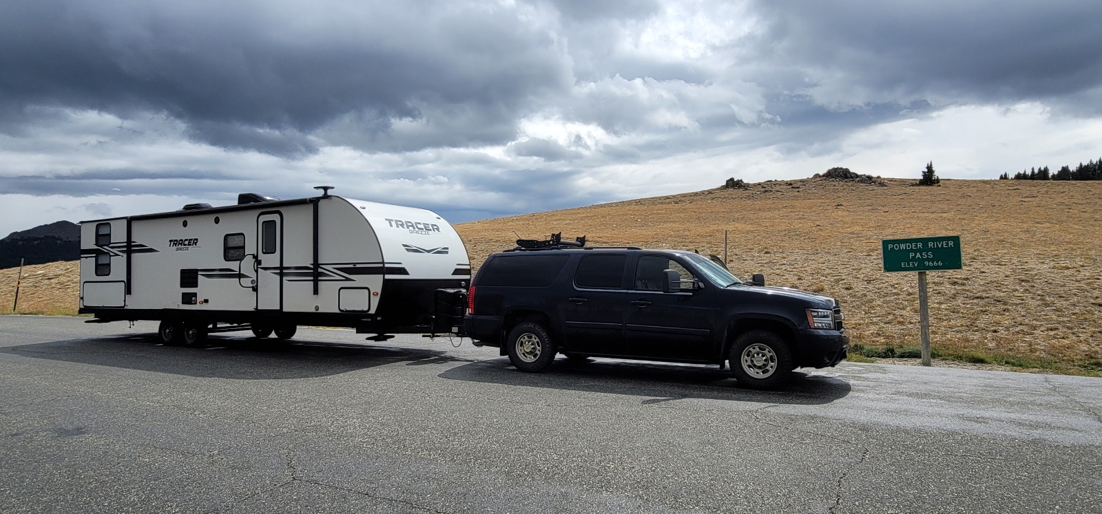

Pic for attention. I'll be buried in this thing. On several occasions, I've almost bought another one, to keep as a spare.

I tow two trailers:
1)The 8000-lb travel trailer pictured above. Goes without saying to use Tow/Haul - delayed upshifts, better downshifts/engine braking, charging trailer batteries
2) A 3500-lb 6x12 enclosed cargo trailer, with no trailer brakes. Again, Tow/Haul used for the engine braking aspect, since I'm asking the truck's brakes to corral 10,000+ lbs.
