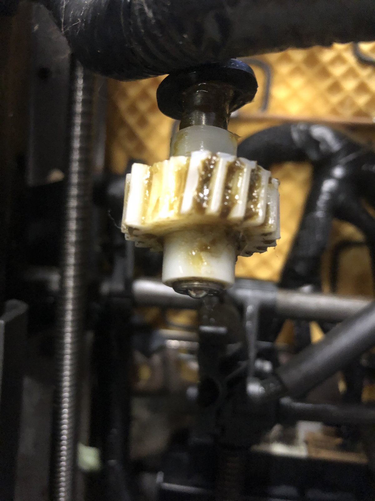

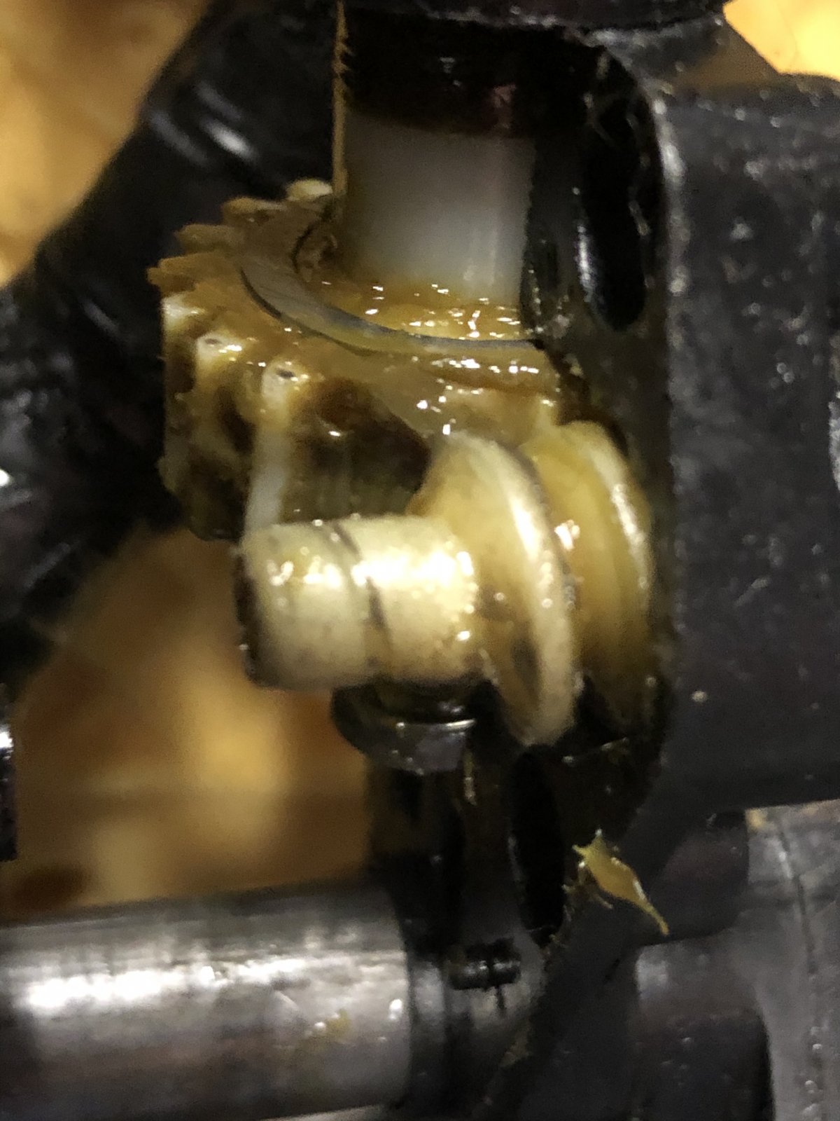

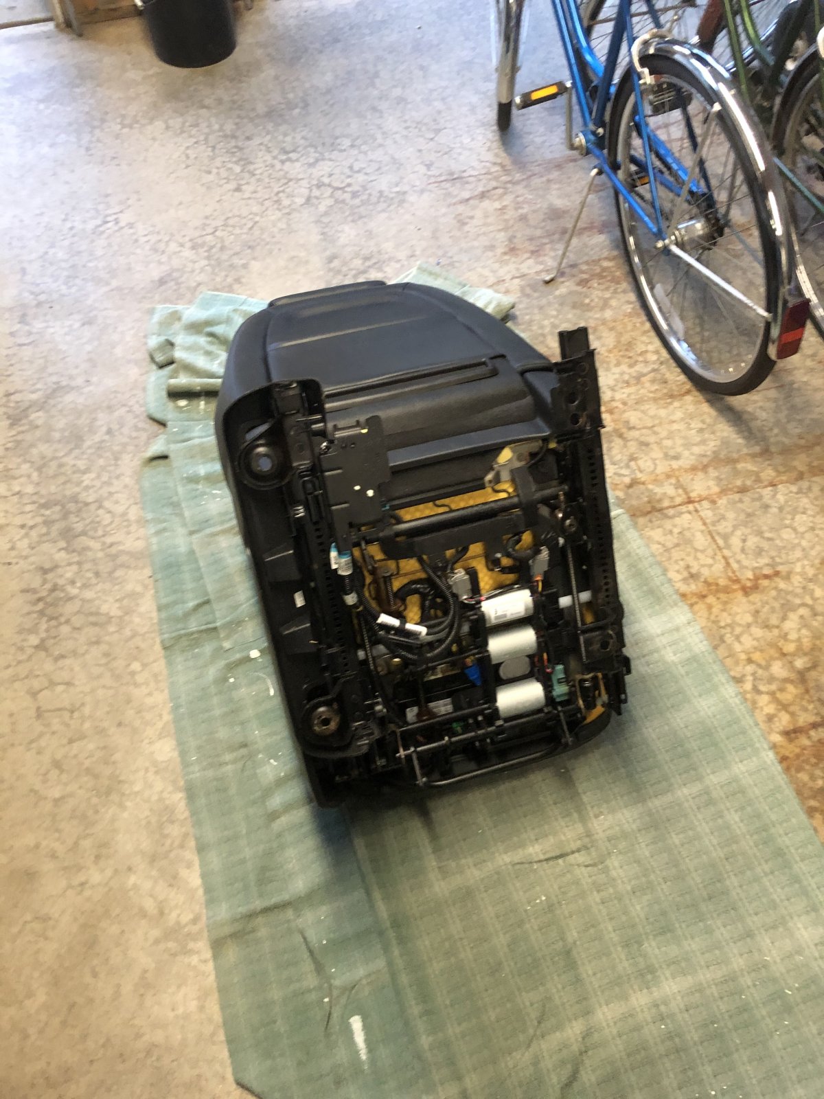

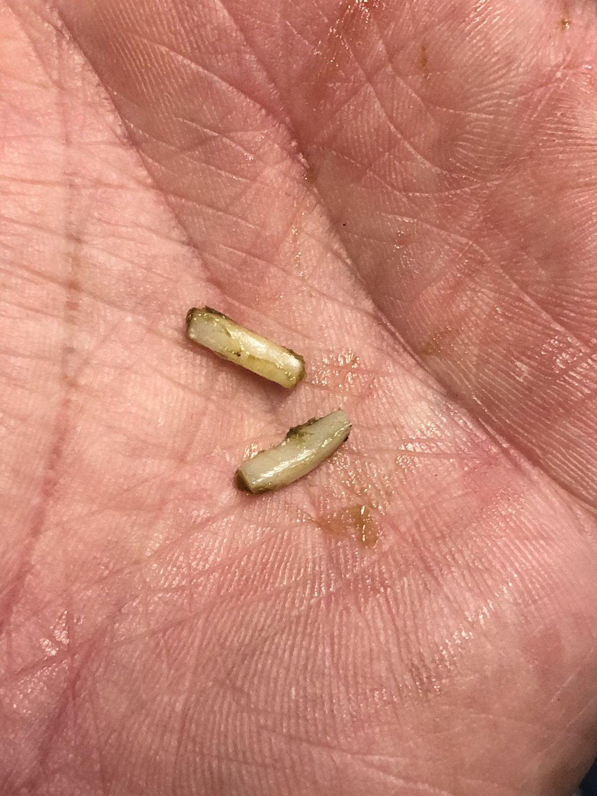

I did some exploratory surgery tonight. Yup, busted gear. Pretty easy to get to. I put it back together and will order up some parts.
