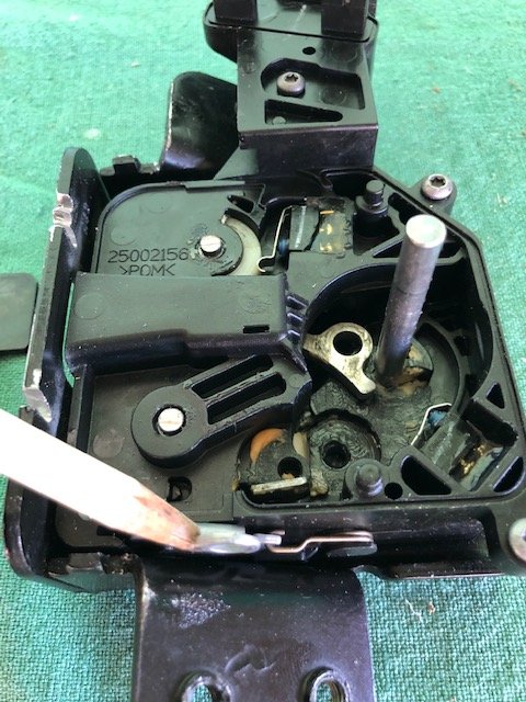

Hi all, Greaser007 here again to attempt with attaching a few photos of the Latch mechanism.

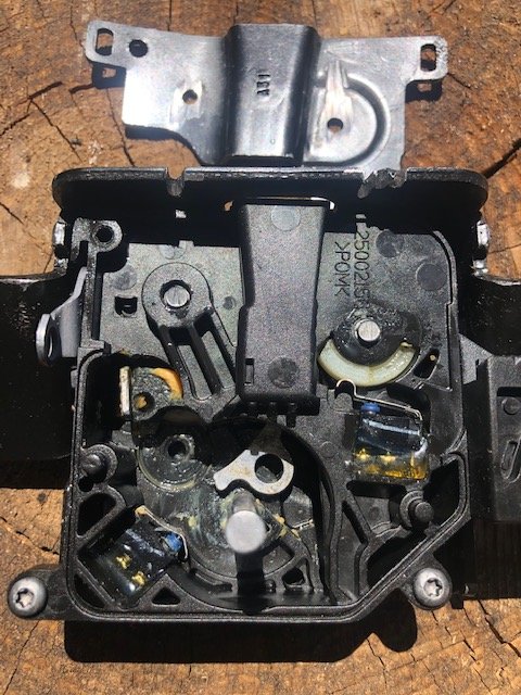

above photo showing the inside of the latch assembly.
if you look closely you will see two small switches which are part of how the latch communicates with the Module and Liftgate motor.
Another photo of insides of the latch assembly, and another switch with blue seal.
Believe me, this is a very complicated and involved assembly of which I don't think I'd ever be able to fix.

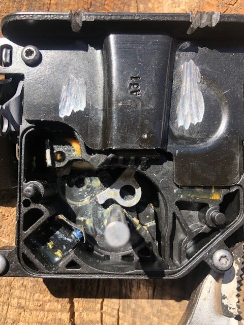

Above showing swedged pivot heads ground off and plate removed (cost me some blood) showing the innards of the latch mechanism.

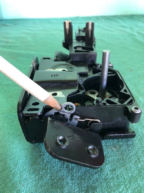

Above photo showing (at pencil tip) the mechanical latch release to push on with a screwdriver to manually unlatch the powered Liftfate Hatch.
Above photo showing mechanical latch accessed from inside the vehicle through a hole which must be drilled through the inside plastic panel on Liftgate hatch.
This also shows some of the internal mechanism.
