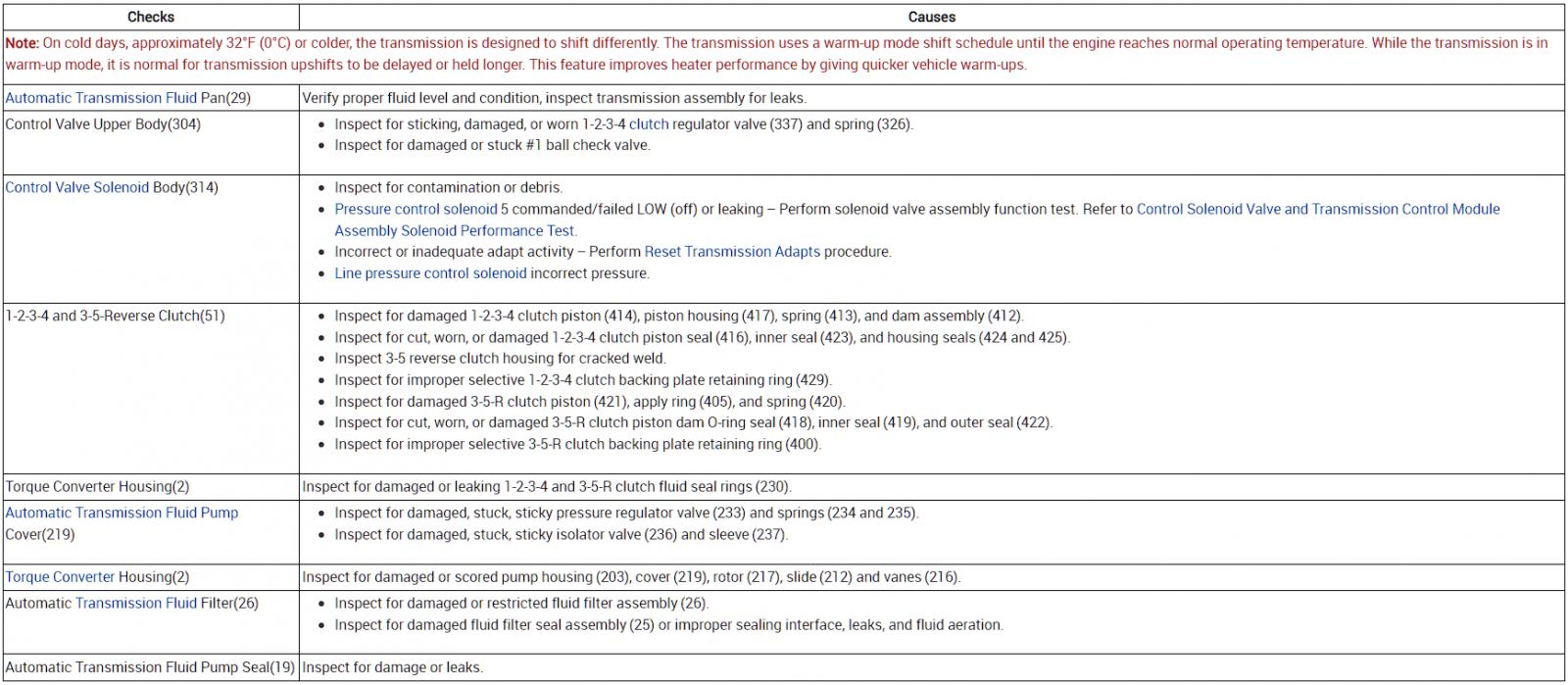

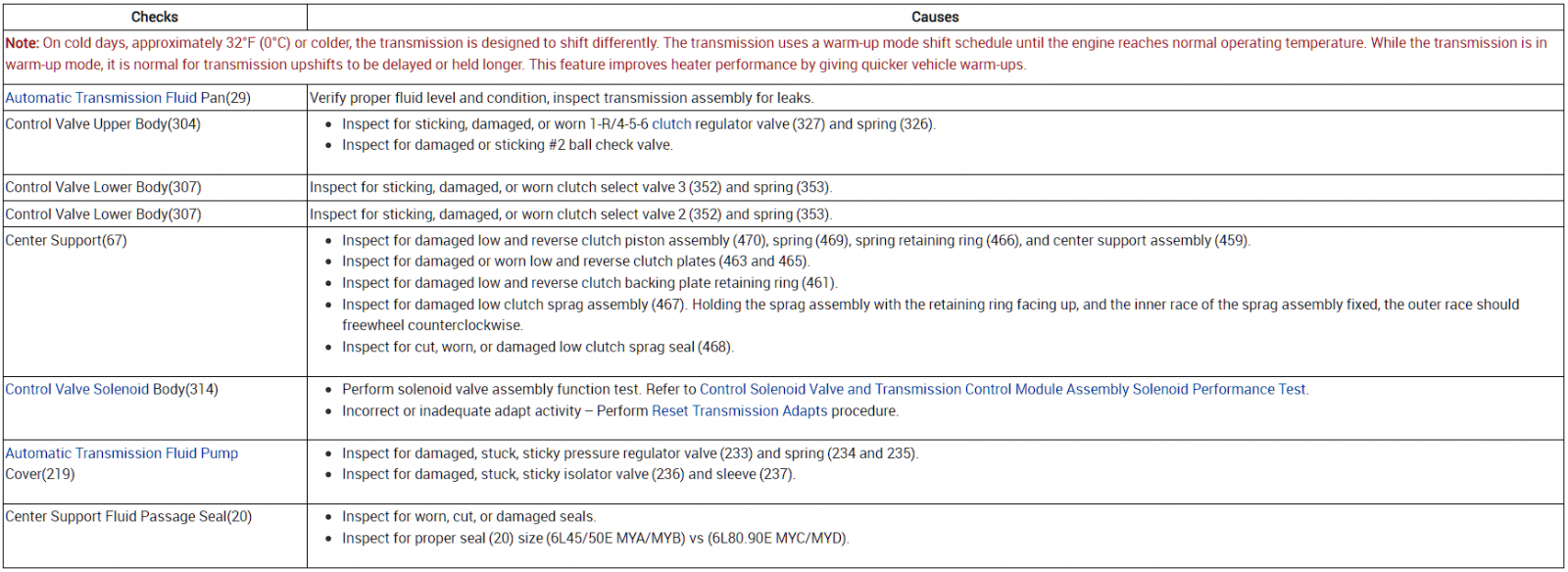

From the shop manual:
Harsh, Soft, Delayed or Slipping 1-2-3-4 Shift:
Harsh, Soft, Delayed or Slipping First or Reverse Gear:
