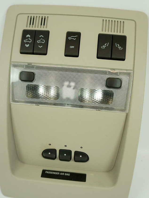

Challenge accepted, lol. It also seems GM added a rear power folding seat switch to the overhead console in 2013 (I'm assuming this is for the 2nd row). I'll be investigating how to add that.
Negative, they actually ‘removed’ that option in 11-12? In the oh console.
12-13 you can still use a tech 2. 13-14 is when they changed. But since 14 was a carryover year I would bet a tech2 can still be used.
hill start, tsc and grade br are automatically engaged.
I believe ‘smart suspensions‘ got alum controls arms but I am not exactly sure on that.
someone used to make a heated steering wheel harness a few years ago but since stopped.. (for us northerners) but I like the cooled seats add on thing.
Apr 11, 2018
7,124
14,375
St. Louis
My 2011 didn't have the 2nd row tumble switches in the overhead, neither does my 2012. They must've stopped before the 2011 model year.
This! ^^^^

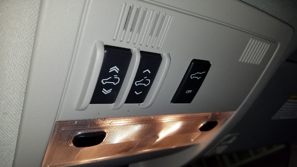

With regards to the overhead console switches, I do not see them after 2009 for the power flip and fold seats. 2007-2009 have shrouded buttons for the moonroof and I think the power lift gate but this too went away after 2009 if memory serves.
Yes, the heated wheel is a popular add-on and the harness is a pain to acquire.

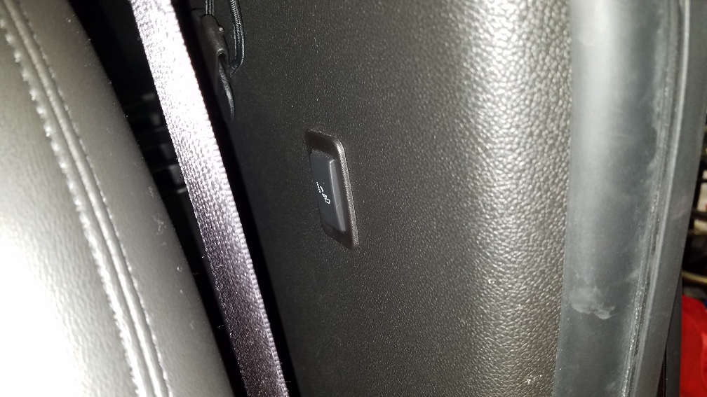

Hmmm...were there secondary release switches on the C pillars as well?
The brochures all the way through 2014 mention available “power-release flip-and-fold” second row seats. So where’s the switch on the 2010-2014s? Is there a specific RPO for that feature?
What do you mean by shrouded switches?
21,287
30,223
Yes, there are switches on the B-Pillar and for whatever reason took away the driver's ability to operate them. On my truck, there is raised plastic on either side of the moonroof switches. I don't remember the part number and still cannot find my Crash Book since the move to look it up, argghhh!!
