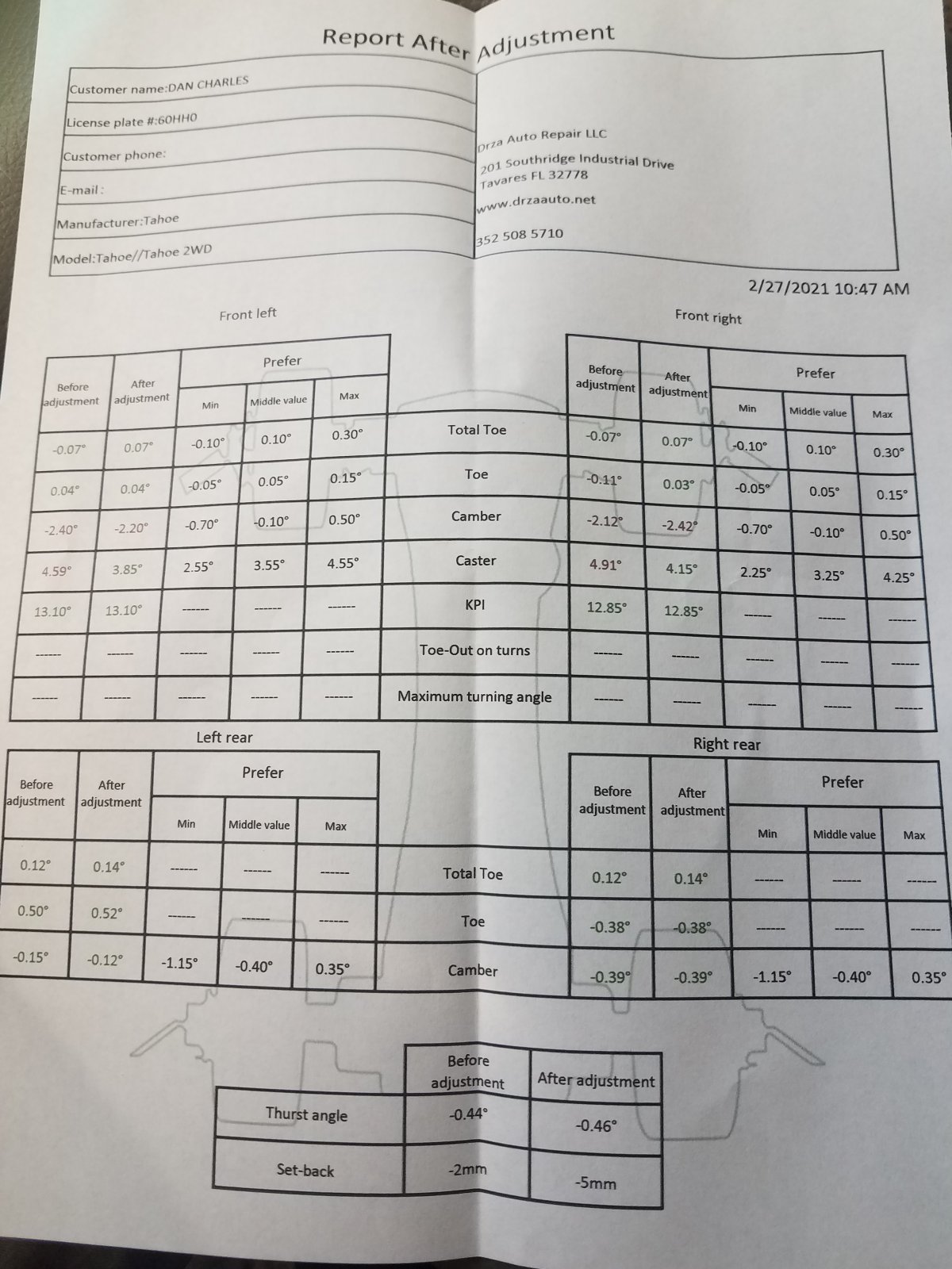

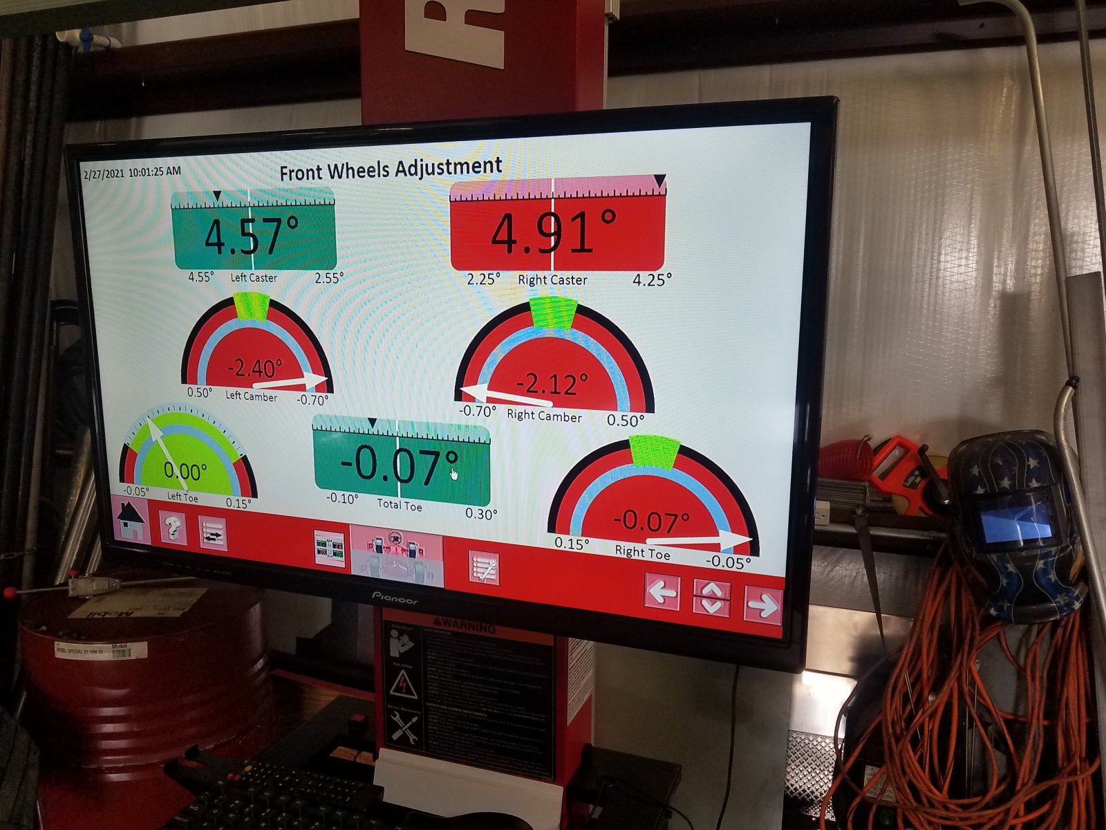

So it's not perfect but, I didn't expect it to be. Since its dropped 2-3" with no camber correction like spindles I figured it wouldn't be possible to get it dead on. Good news is that so far it feels much better! The caster was the issue with it pulling right under throttle and left when letting off.
He thinks I can find a set of camber adjustment bolts and bring it back to be dialed to perfection. Anyone know where to get such devices?

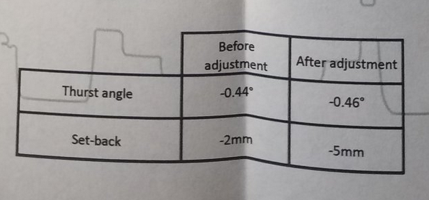

I think the "Thurst" angle needs a drink; it's low!

I'm not an alignment expert but I think that's due to the 14bolt being wider than the front. He said the rear specs weren't great but theres not much you can do.
