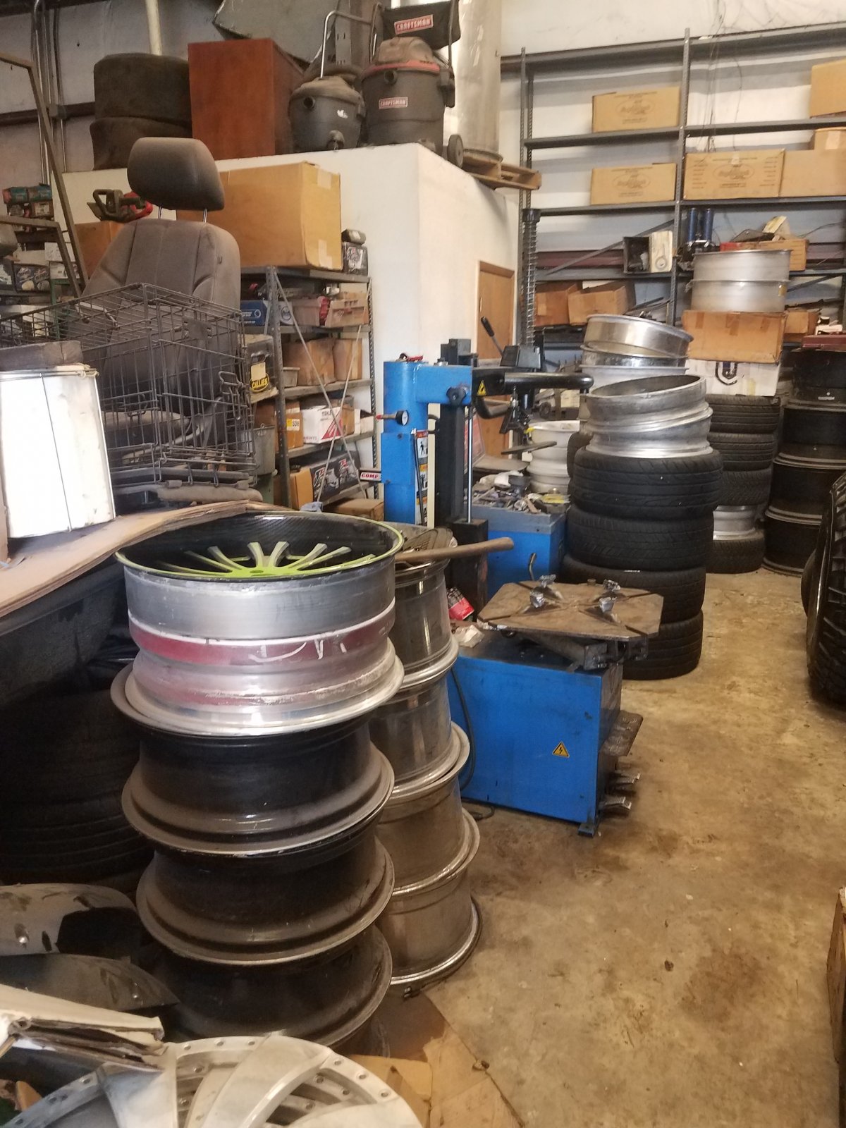

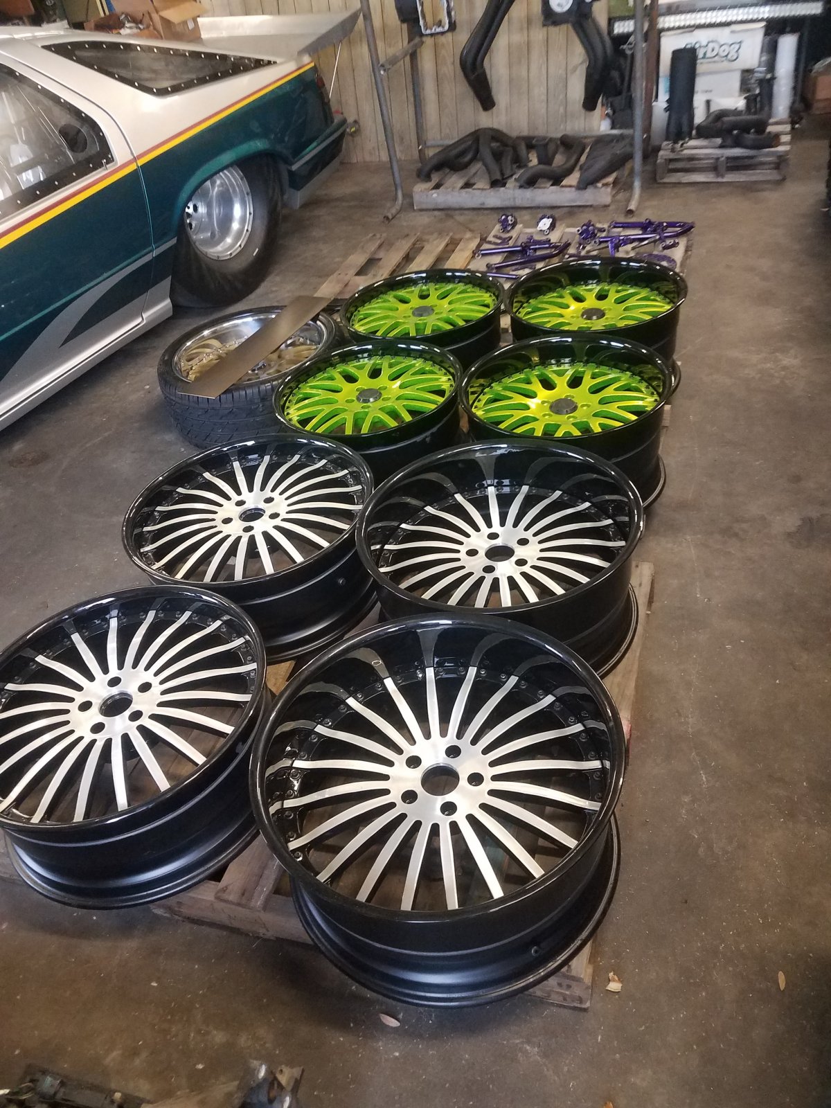

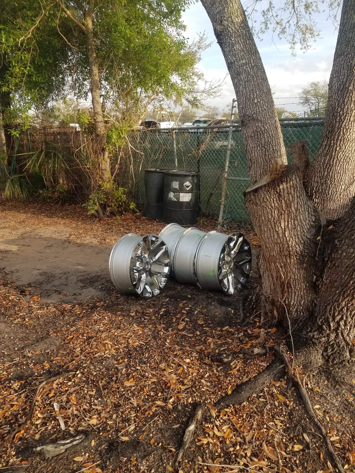

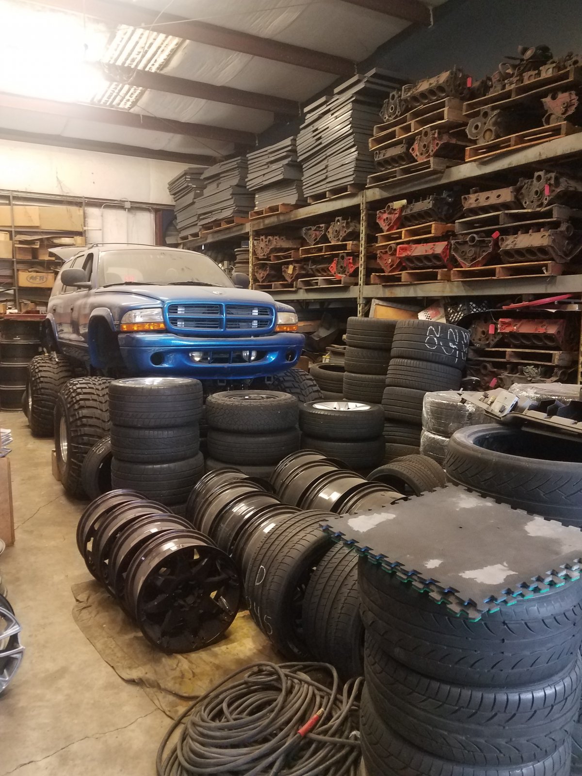

Went by powder guys shop today and check out his wheel stash. Actually not much compared to usual hes been diligently selling stuff instead of hoarding. Only thing he had for 6x139.7 is a set of 2 piece 23"asantis, 22" snowflake reps and some 22" OEM gmc wheels.
I did talk him into getting a scale and weighing different 20-24" gm wheels as he sees them. He swears 3 piece Vossens are some of the lightest hes seen and is what's on his avalanche now.
