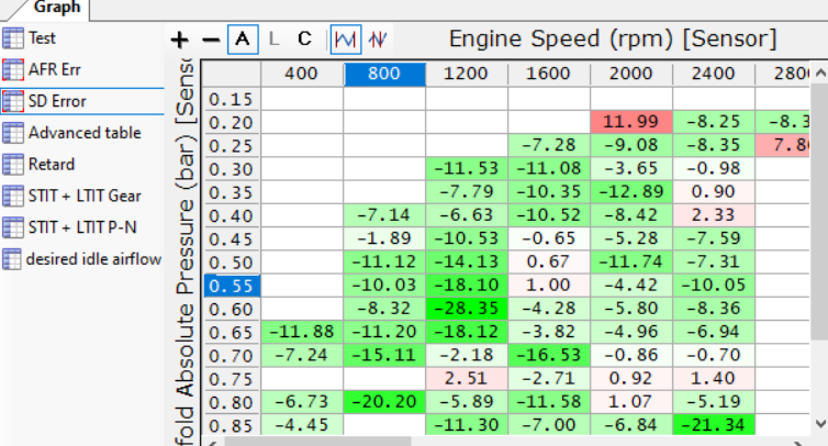

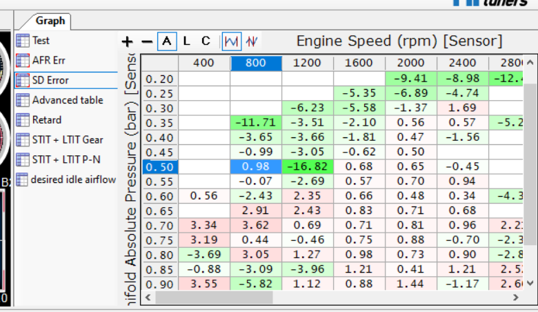

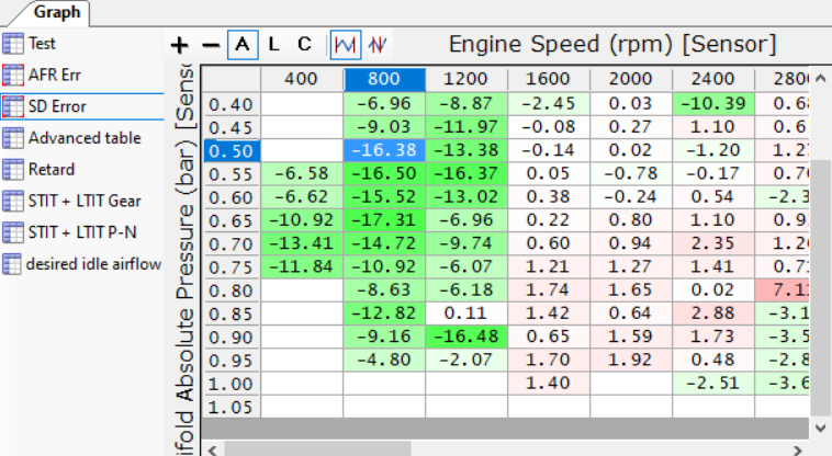

Wow, the MAF being active was killing my VE tuning. It went from crazy lean to rich at idle and it making progress with each change like it should have been before. Can't believe it was such a simple fix, it's amazing how easily one setting or parameter can change so much.
I did totally forget to change the O2 units but I'll get another log of that omw to the shop.
hells yea

Did you disable the maf?
Yes sir it's been partially disabled for a while but now it's 100% inactive and only the IAT sensor part of it is working which is necessary for the MAP to control fueling in a speed density setting. Not a real major reason to do this other than my eventual goal of deleting it completely in preparation for boost. Also learning to SD tune this will help me for when I finally get my RCSB back together.

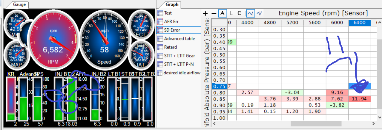

But the drama isn't over yet lol. Still super-rich not sure it's taking the changes as well as I'd like but I'm only correcting by half% I just figured it would have been more of a drastic change after 2 changes.
Here is the latest run, it did do a weird crazy rich spike in the beginning like 9.0afr for a good solid 30 seconds but cleared up and went back to being just a point or 2 rich which averaged the data out to this.
Also got a little lean on the top end, I need to bring the limiter back below 6,600 I know these heads don't flow that well.
Lastly, heres a couple snips of the O2s at different spots in the tune, they both start out close to even with each other and then suddenly jump drasticly apart with the B1S1 making the more drastic swings. Not sure if one making larger swings than the other means anything specific.

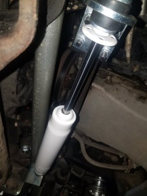

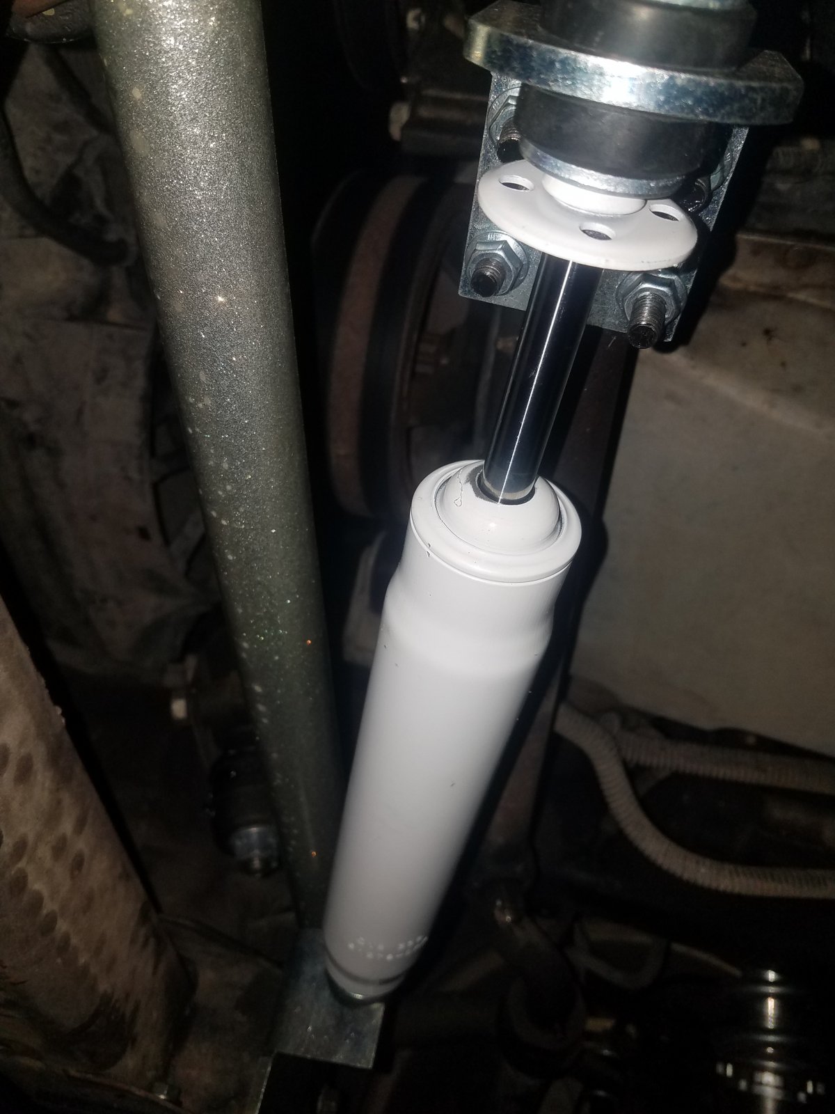

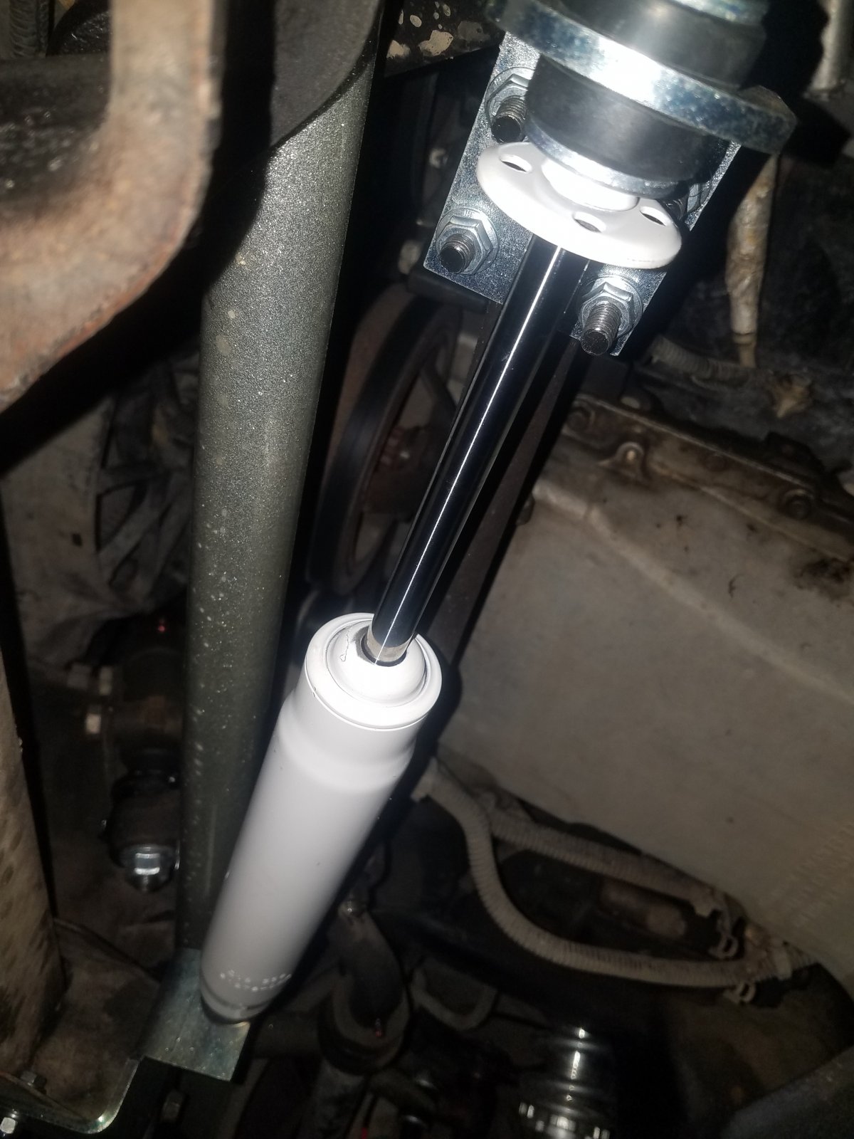

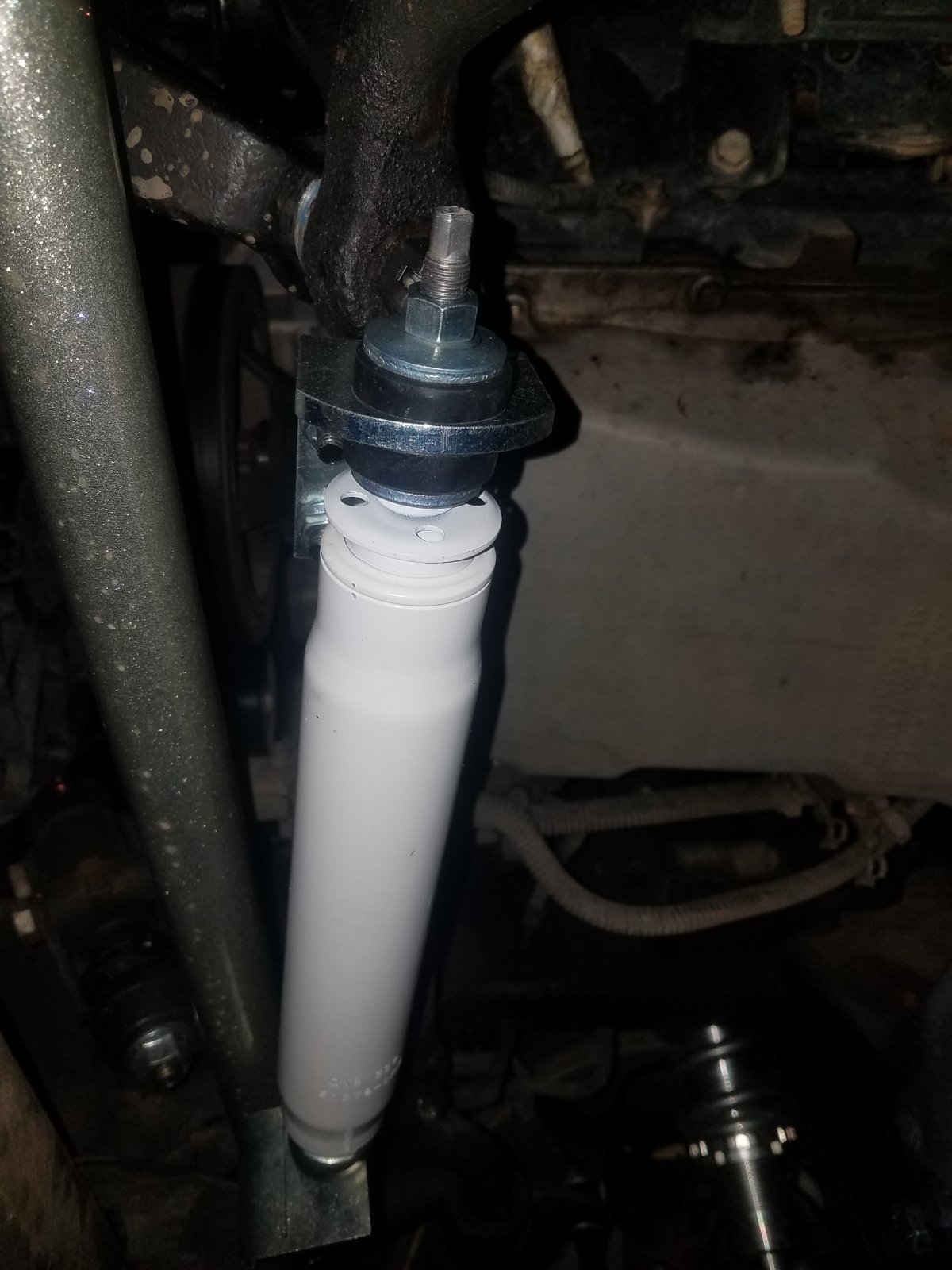

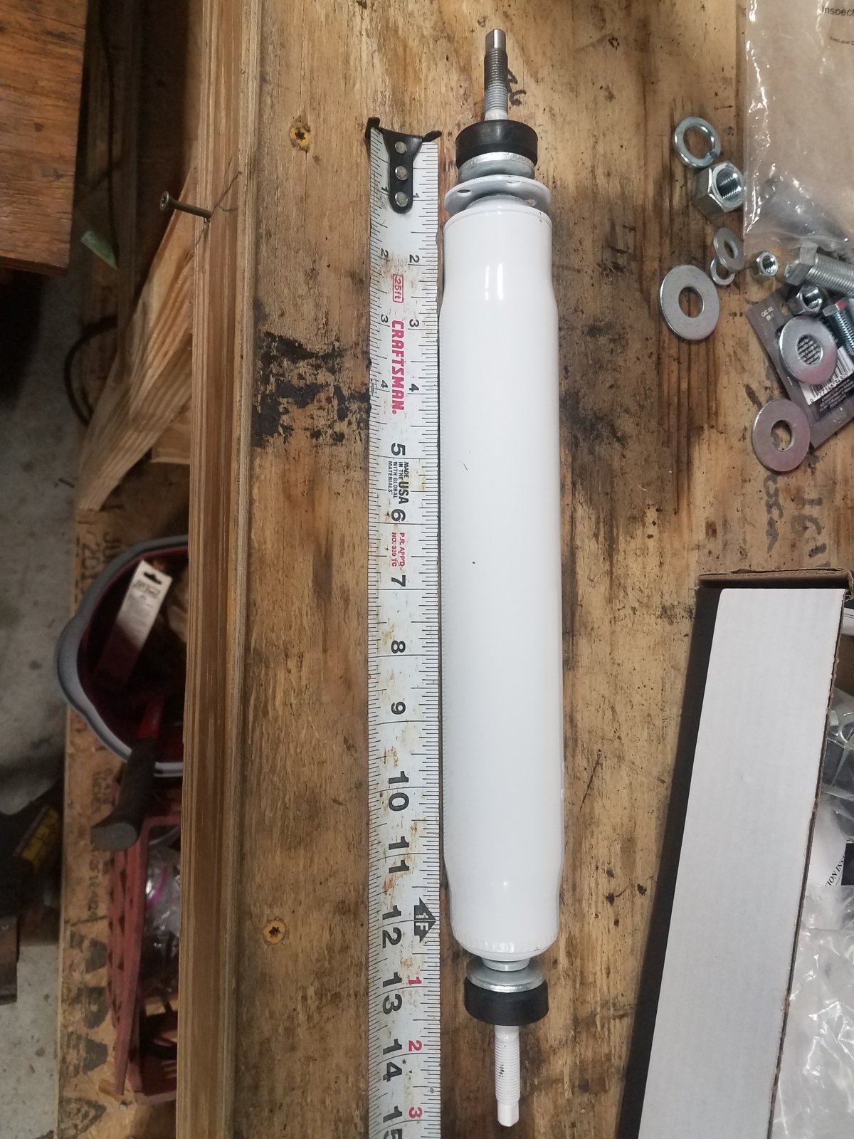

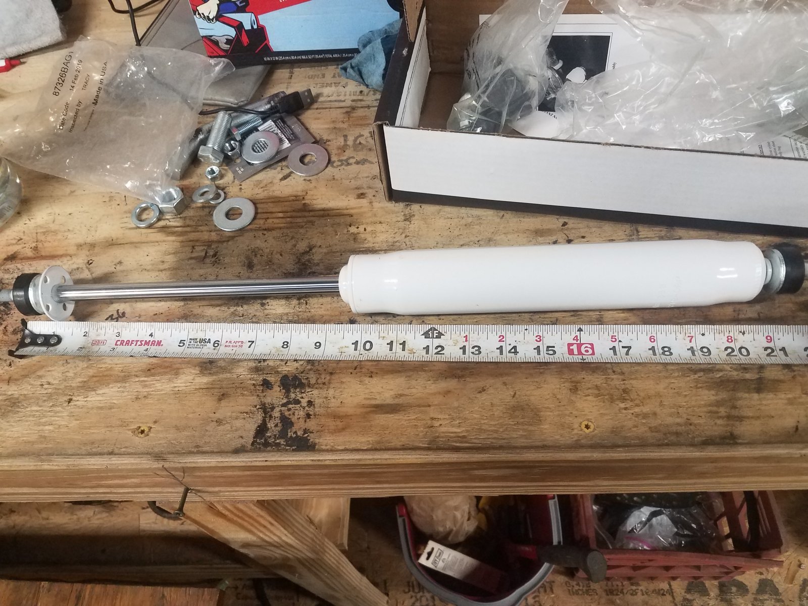

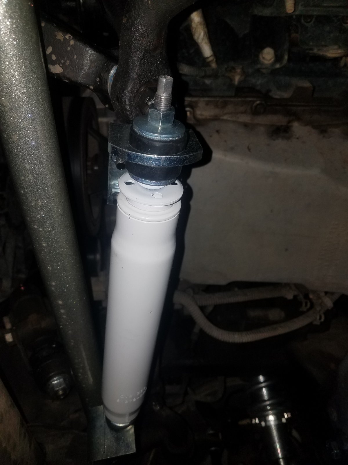

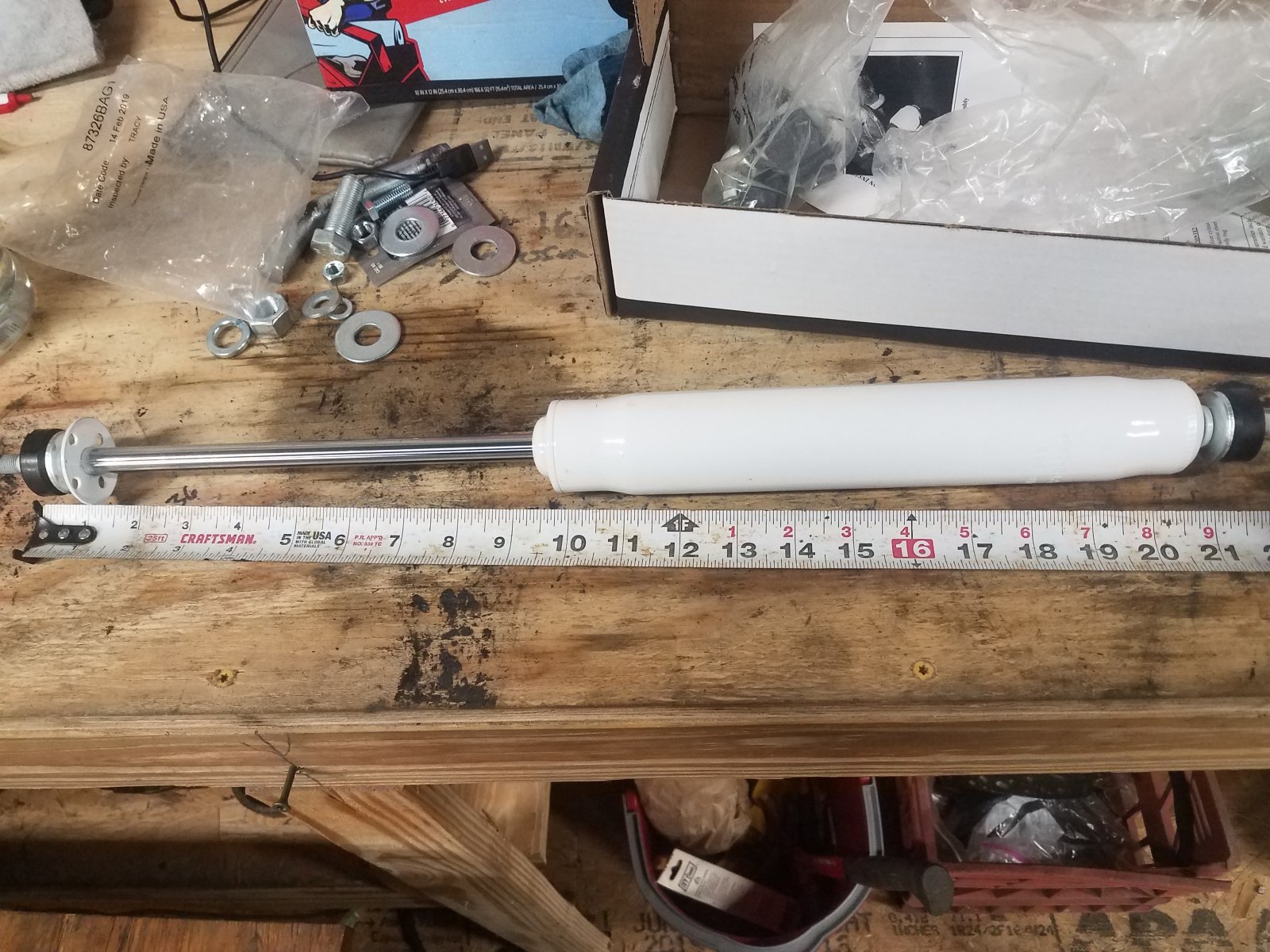

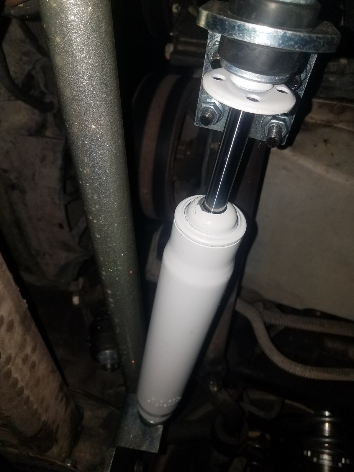

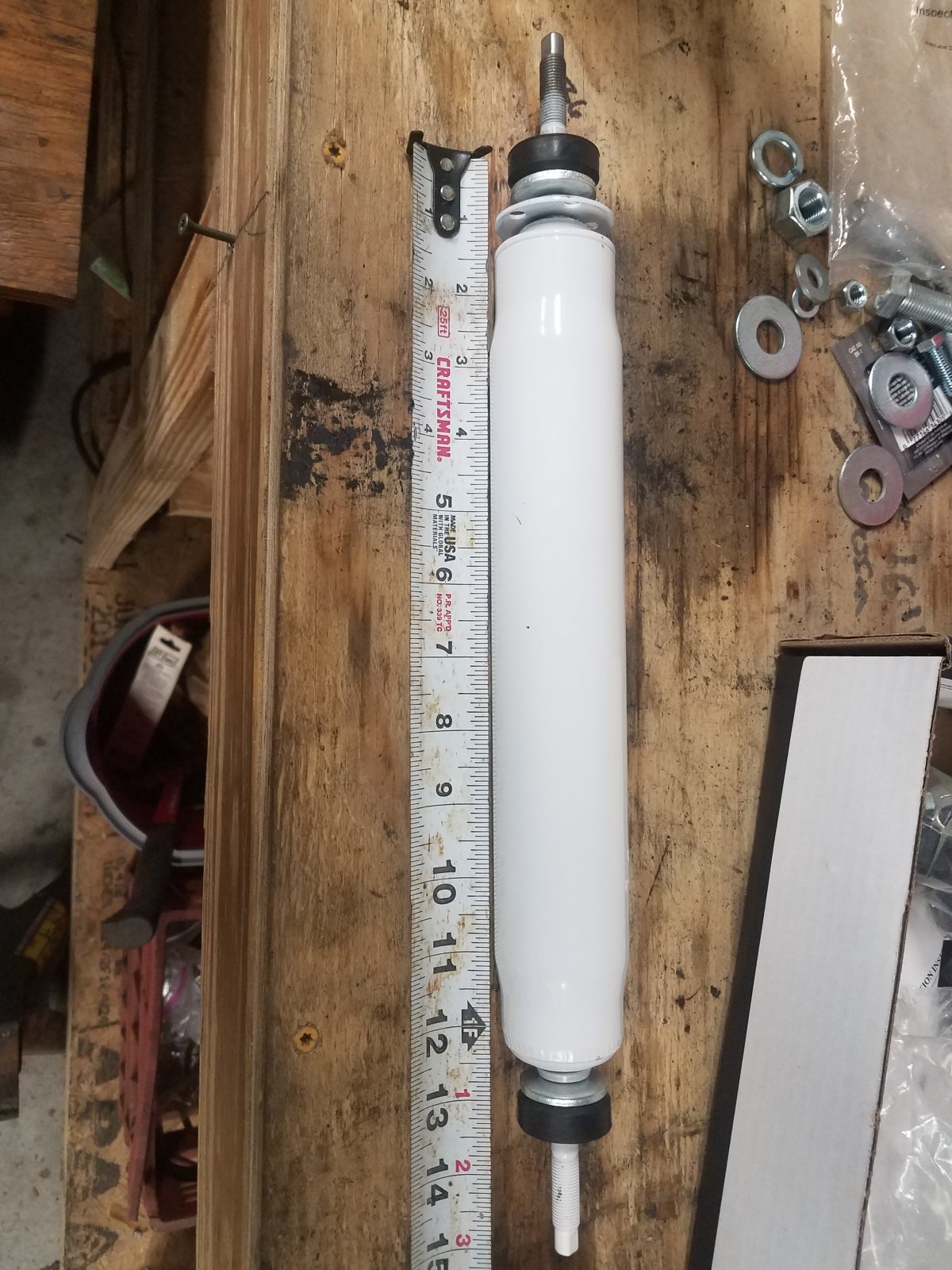

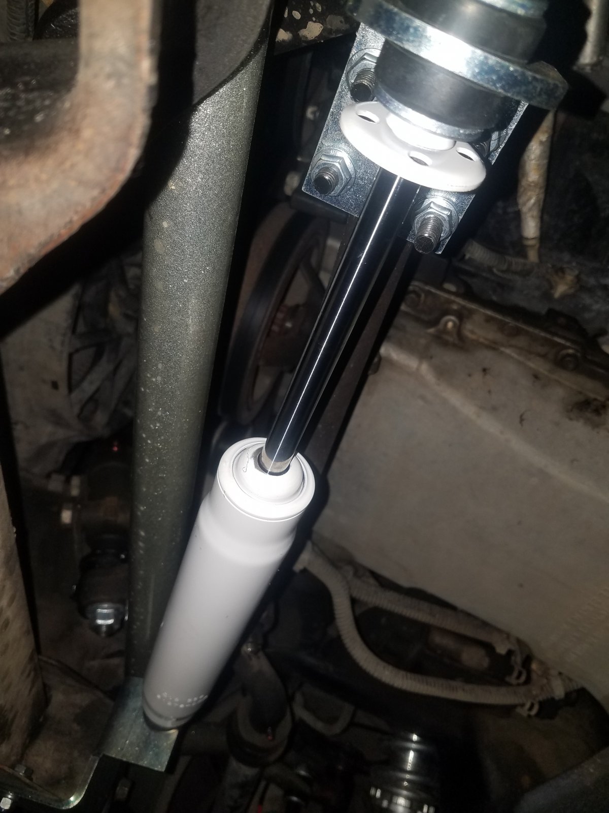

Also got the steering stabilizer in and on, it's pretty easy despite a complete lack of instructions and multiple unused parts. I don't have a ton of faith in this shock lasting a long time but as a quality affordable replacement I'll probably try to find a rancho 9000 adjustable like @kbuskill just put on his truck. Which is why I posted pics of the shock length for my future use, also some pics of full driver, passenger, and center clearance.
Overall impressions on my 3 mile test loop is that it does effectively dampen the bump steer that will always exist in some amount. Anxious to see how it does on the heavily pitched and totally fubar farm roads during my commute tomorrow. Maybe I will be able to hold the wheel with my knee while shifting, drinking coffee, and passing semi-trucks.
View attachment 269729 View attachment 269730 View attachment 269731 View attachment 269728 View attachment 269727
That looks like the one I put on my 02 a couple years ago. Last time I pulled it off ( couple months ago) it seemed to be working good.
That's good to know, some of the reviews said after a few months it began to leak shock oil but, if it ain't broke I will not fix it. I'm sure blown awd launches put a little more stress on yours too :driver:

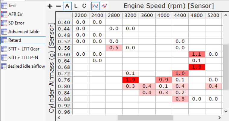

Tuning is making great progress except I did get a tad bit of knock this morning @22*. I pulled what it detected out of it till I get fueling 100%.

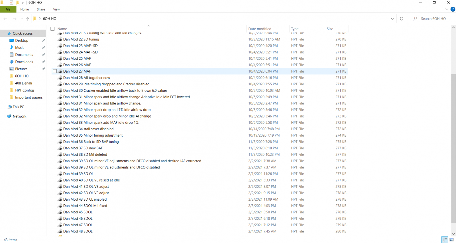

Another extremely important thing is to come up with a system to accurately save every tune you use and have a decent description of what was changed in that tune from the one before it, even better if you can link the data log to the tune that it was running at the time. I often cross-reference stuff from old tunes to new tunes and until I got a good system down it was impossible.
For example, I'm currently on "Dan Mod 47 SDOL" (Meaning I did the mods it's my tune, not Atomic or someone else's, it's the 47 revision and is in Speed density and open loop)
When I save a log file I will name it "DM47SDOL L1 house to shop" (Meaning the tune it's running on, log 1 from that tune and then a brief description of where I was driving or what I was focusing on. If I'm focusing on something specific I'll put "WOT testing" or "neutral rolling stall
Thats my method at least.

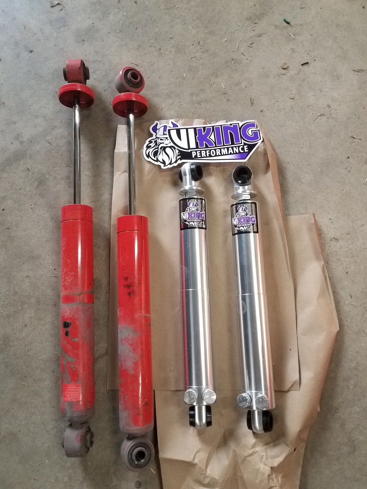

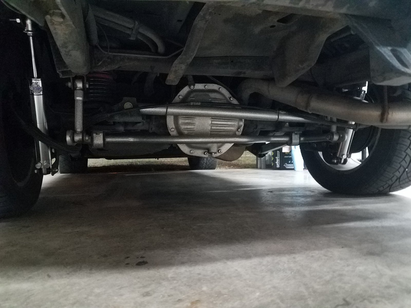

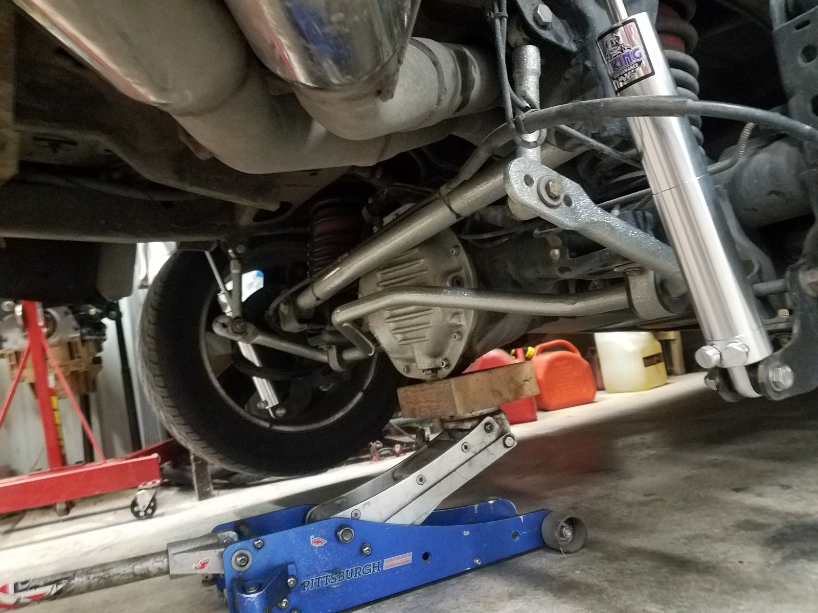

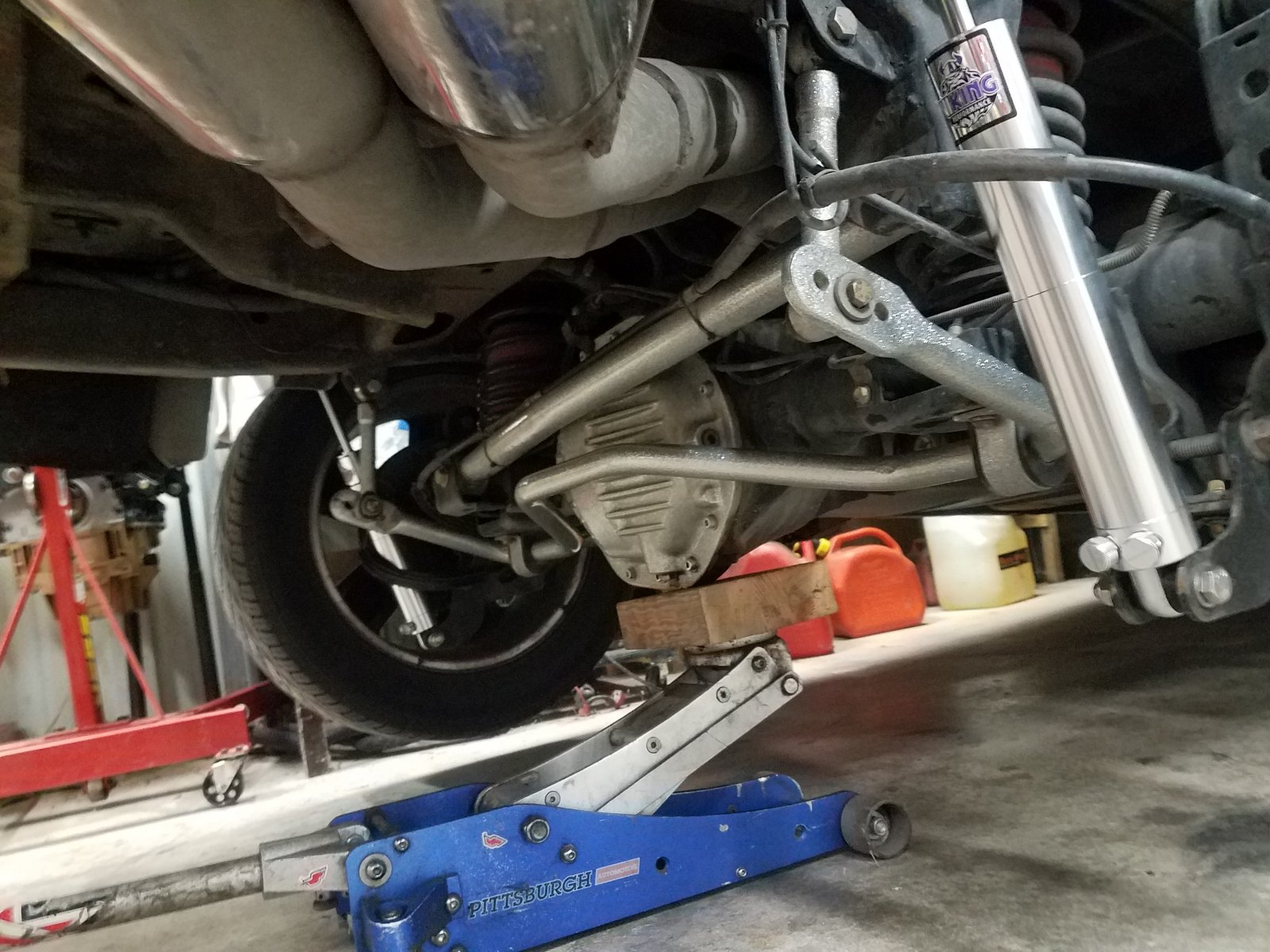

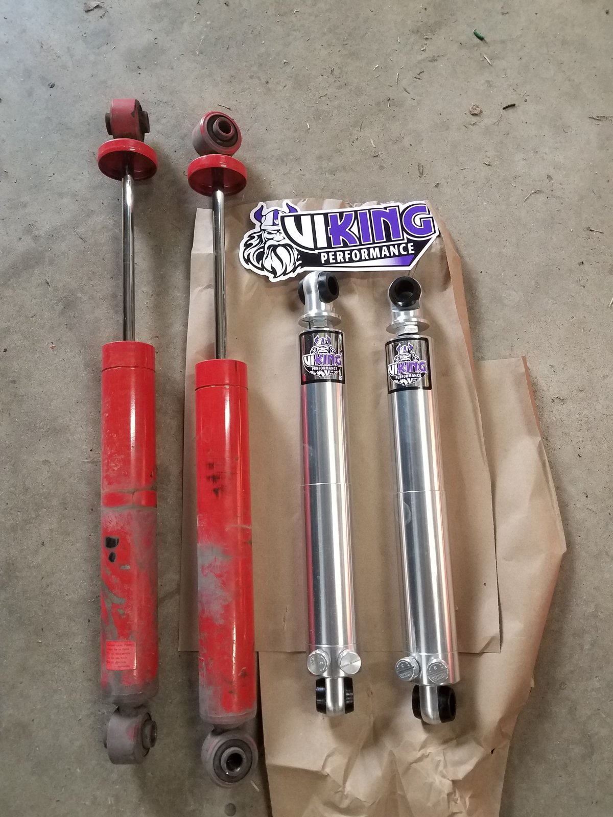

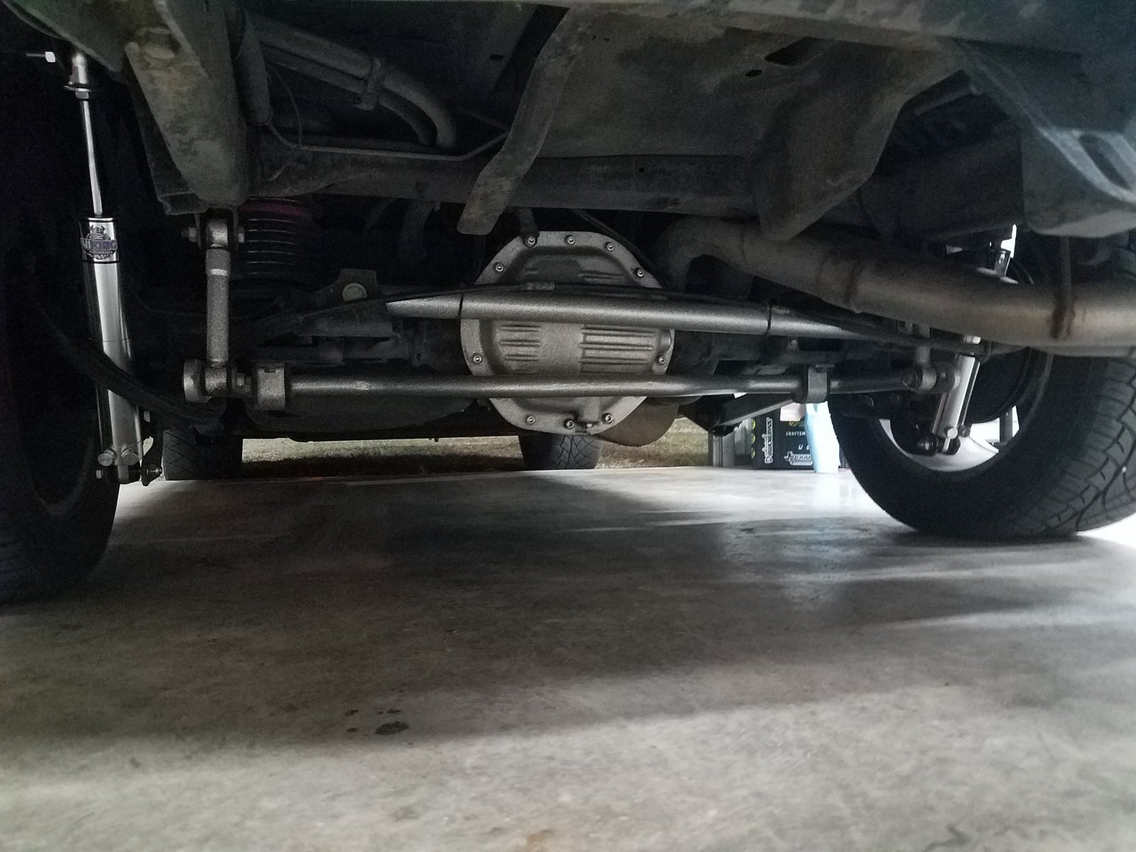

UPS got their shit together and got the Viking rear shocks to me finally. Install is cake and they are exactly the same length as stock which is perfect with the shock extenders at this rear height. Set the adjusters to 3C-5R which is on the high side for street/ride quality suggestion. They immediately felt smoother not placebo on this one. The one massive bump that slamed the rear before still bottoms out i think, but I'm going to play with the settings further.
One disclaimer for anyone that may buy some: The factory bolts will not fit the bushing sleeves they send you. I went and got stainless bolts that matched stock only to get home and realize they are too big, had to run back to ace cutting it close before they closed and get skinner ones. Not a big deal but it did catch m
e off guard.
One disclaimer for anyone that may buy some: The factory bolts will not fit the bushing sleeves they send you. I went and got stainless bolts that matched stock only to get home and realize they are too big, had to run back to ace cutting it close before they closed and get skinner ones. Not a big deal but it did catch mView attachment 269876 View attachment 269875 View attachment 269874 e off guard.
Nice!! About done with the suspension now..?
