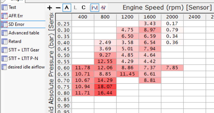

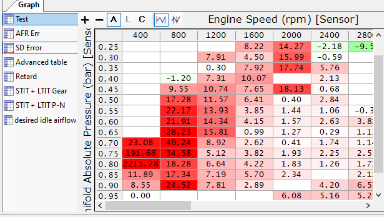

Back to working on the tune, Not sure if its weather-related or what but I could swear I had the VE table much better than this! how can something be 2000% lean.
First log before any changes
After a massive fuel add to the VE Table.
Obviously still alot to go but it always takes time to iorn these things out. At least now I can do 5 or more revisions just in my daily routine.

you prob shouldve done a full multiply by % to reel it in from the get go.
or keep doin what your doing and just highlight the 400 and 800 columns from .50 down and add 10% (multiply by 1.1)
I actually did a full % multiply on that one because it was so jacked. I was expecting a little better results from that, maybe it just needs more work, I think if it reads over 18 then it logs it as 18 no matter what so there could be some issues with it not reading high enough to get the full correction until I get it closer.

2000% lean lmao,
if youre logging with the key on engine off it hits the cell a bazillion times with zero fuel...but it should be at 101kpa or so though, what does you map sensor read with just the key on? engine not running
